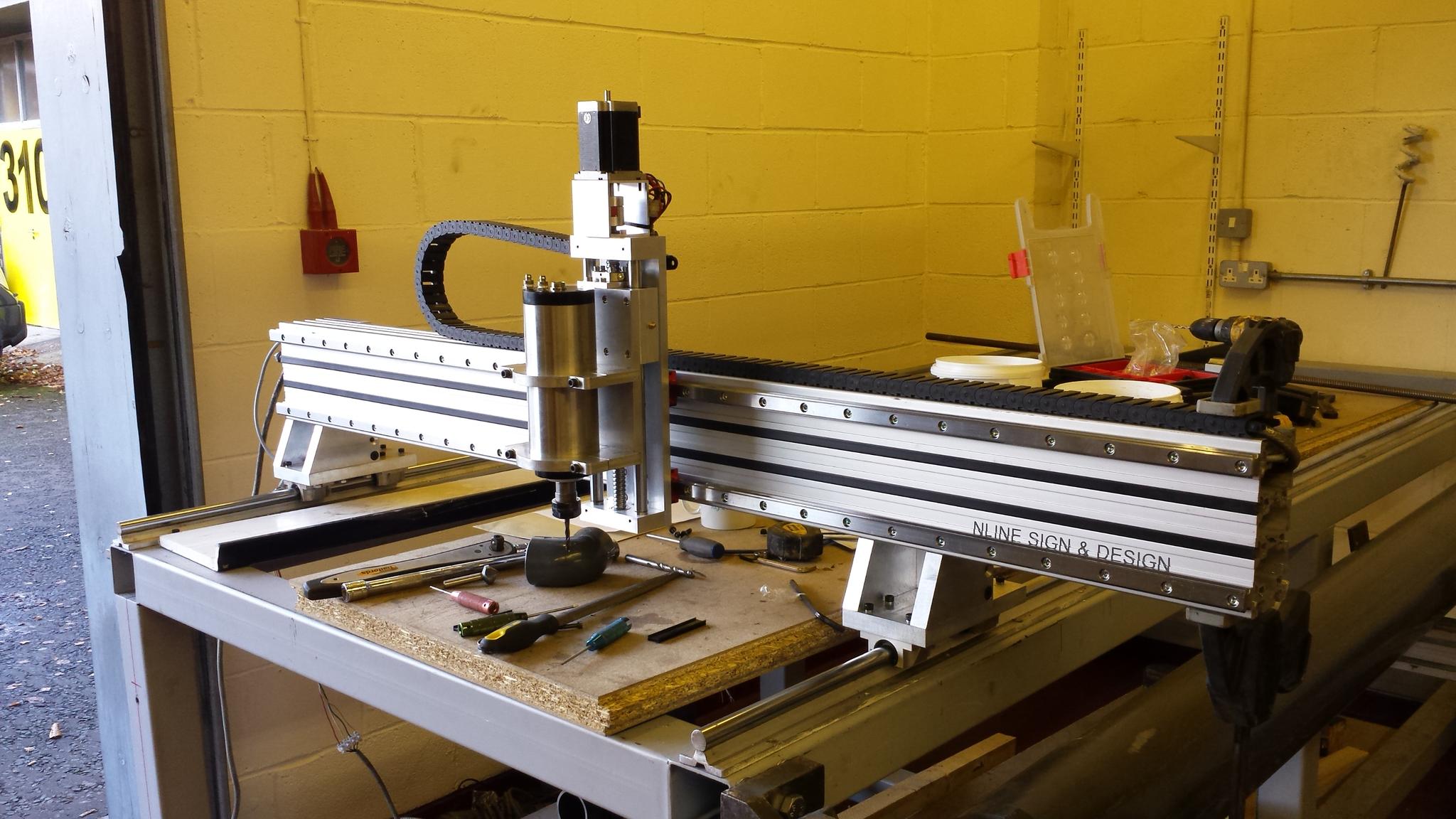

    OK guys sorry maybe a silly question but what wirethickness do i need? im using Nema 34 all round apart from the Z
    In that case I would use 1.5mm but do you really need nema 34 motors if so is your power supply big enough? ..Clive
  7. #6

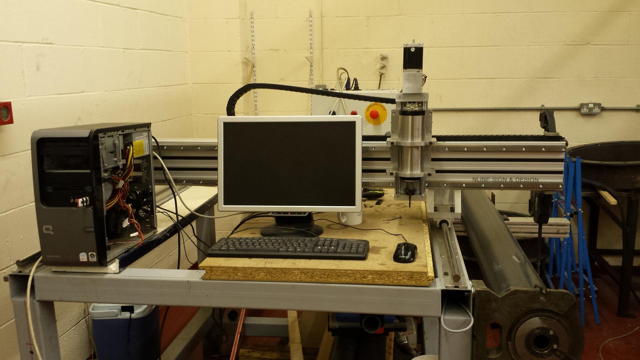

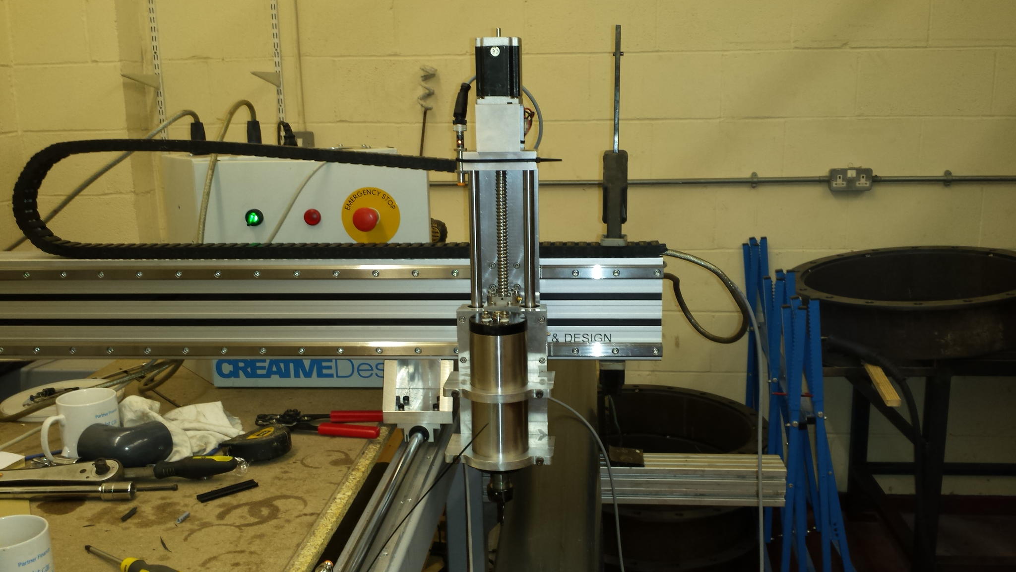

    Thanks Clive, Yeah i need 34 all round as its a heavy gantry with future plans for it to put on a little more weight! This is the setup i had before i stripped my last machine down due to a huge bust up with my last boss. unfortunatly everything else was left :(
    I decided to run R&P on the X with cncrouterparts pro drives

  8. #7
    Clive would i be right in saying that the 2.5 would be ok to power the spindle? from the spindle to the VFD

    Quote Originally Posted by D-man View Post
    2.5mm will be fine I take it that it is a 2.2Kw spindle I personally would use 1.5mm but others might say not. ..Clive

    Yeah its the 2.2Kw might aswell bulk it up incase anything changes.
