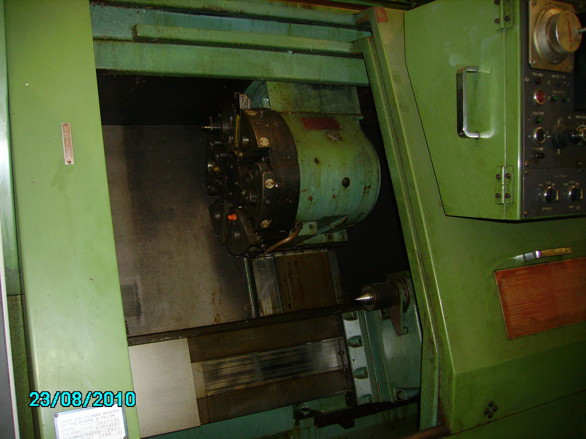

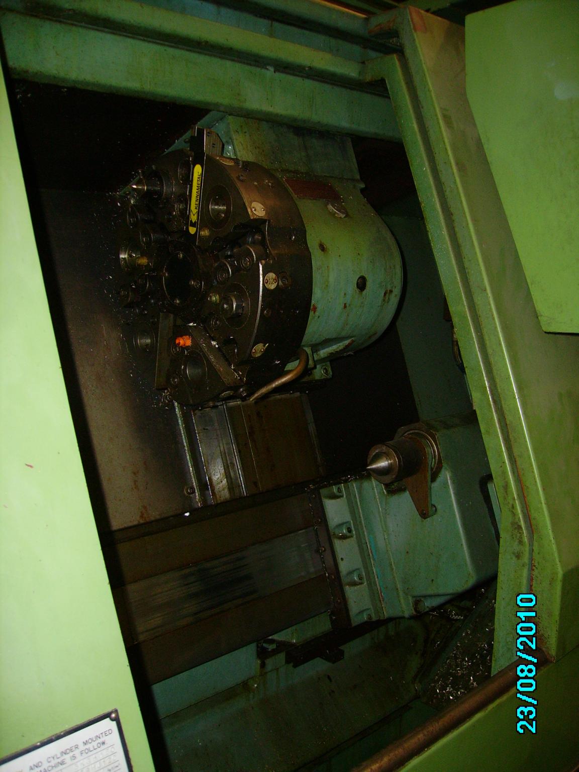

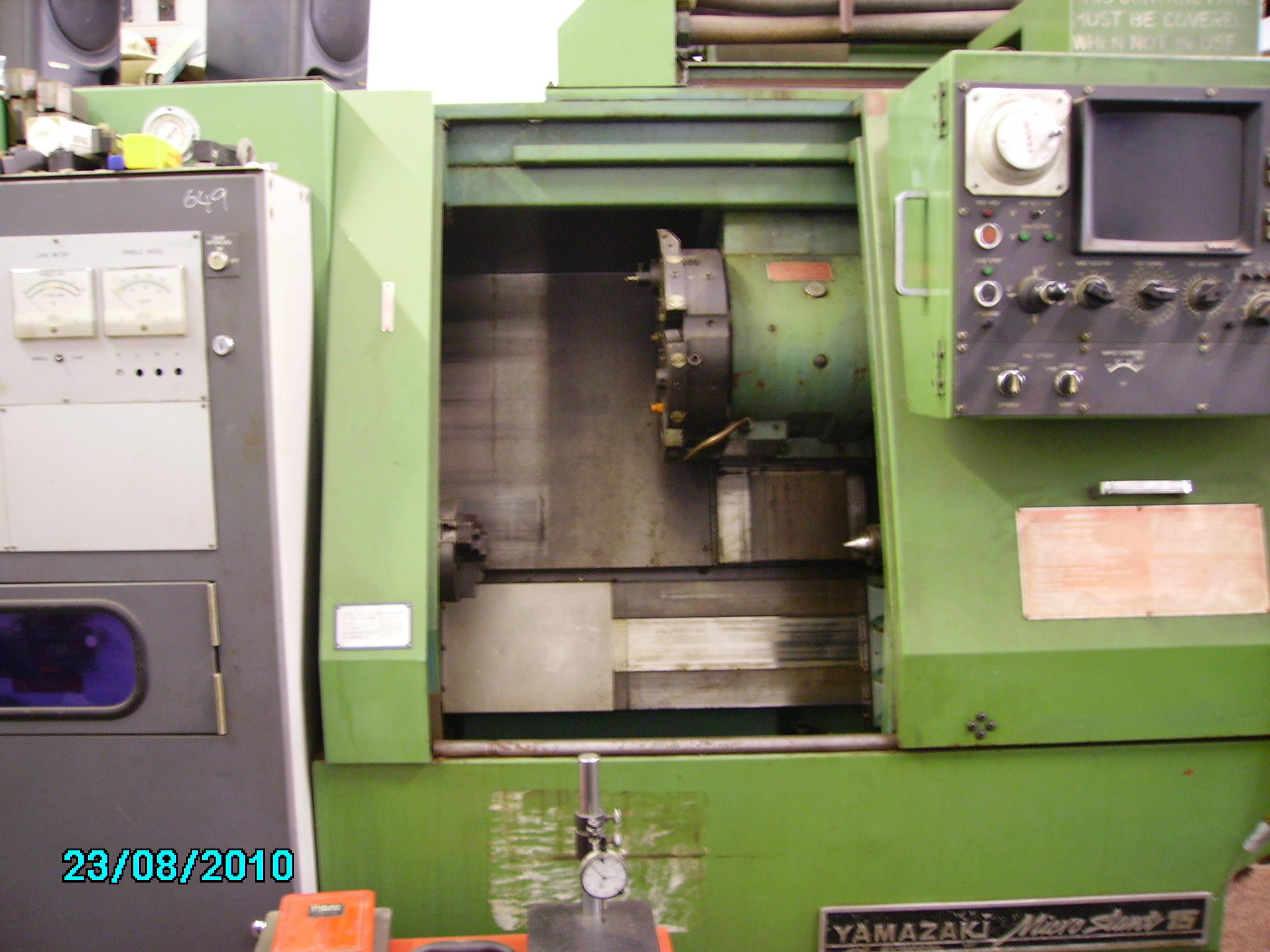

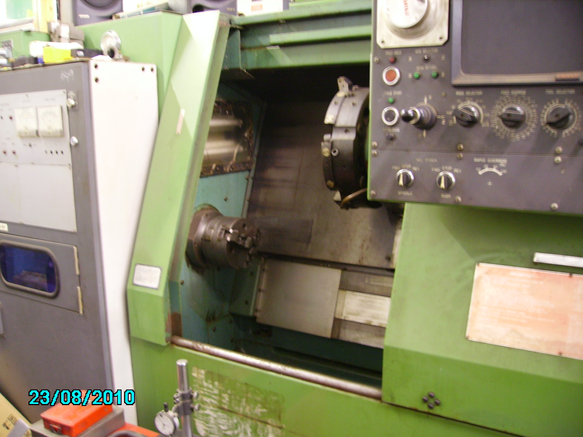

    Right then! Cant sleep again and been meaning to do this post but dreading it at the same time. I will have so many questions and half I will forget to mention in this first post, so you are prolly gonna hate me after a while, so sorry in advance. Before I start I will admit to being an electronic idiot. So this is also about if I will be capable for doing this myself or not.
    This is the first machine I want to try to tackle and be rid of commercial controls once and for all! The plan is to retrofit the control with something else. Obviously this is a commercial machine so it really has to have the ability to function as per its design IE all functions available.

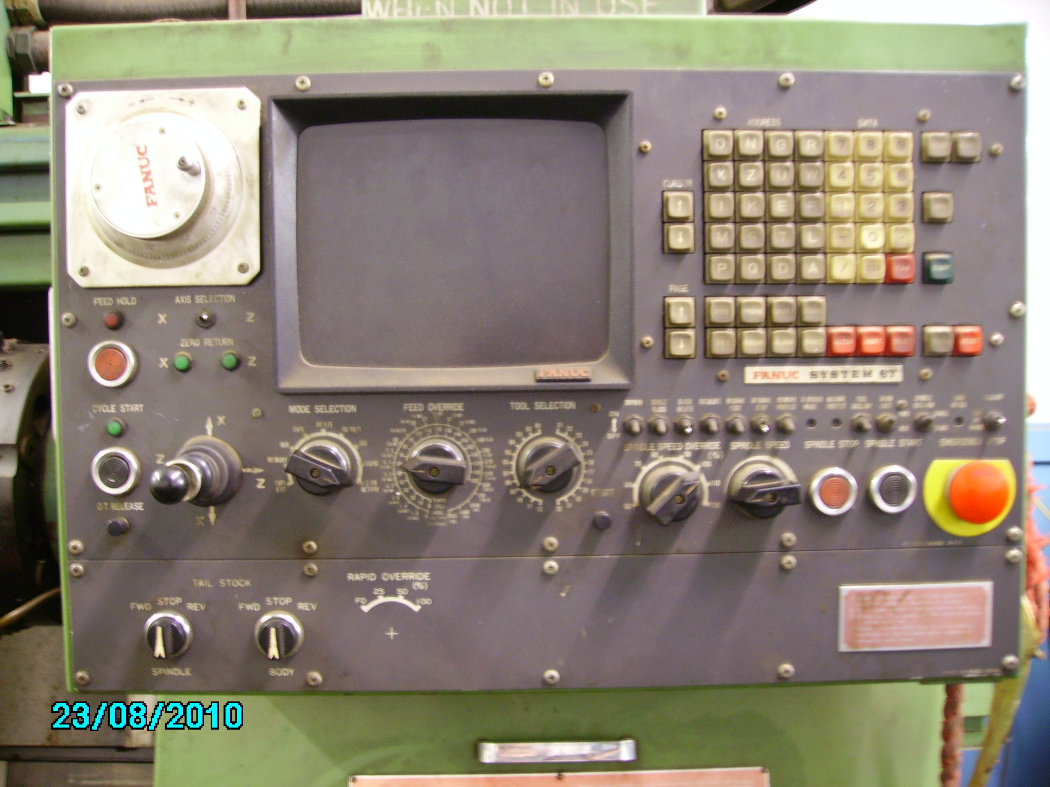

    Manual control of the machine is also important for a machine of this type, for setting purposes and dry running/ testing of programs, as such the machine (ideally) needs to have a control panel (as in the pic) to cover certain features such as:
    spindle speed override
    Feed rate override
    spindle speed
    Hold feed
    Axis jogging
    Tool selection
    Coolant
    Dry run (means the spindle/feed overrides are active overriding the programmed speeds/feeds. It also reduces G00 rapids to a much lower rate like 2 mtrs per min)
    There are many other types of features, I would expect a lot will not be needed as they are really for that control type.

    I'm sorry for the long bleat and numerous questions. Pics below of the beast in question, I know you all like pics.
