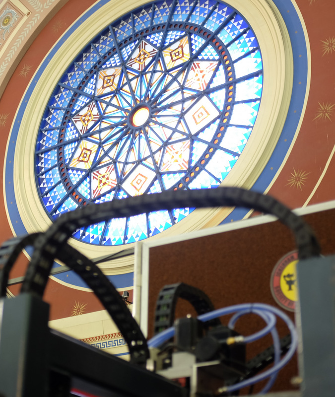

    If you were at the London Model Engineering Exhibition at Alexander Palace back in January then you've already seen and heard it working! :-) Great to talk to so many knowledgable people and thanks for all the kind words.

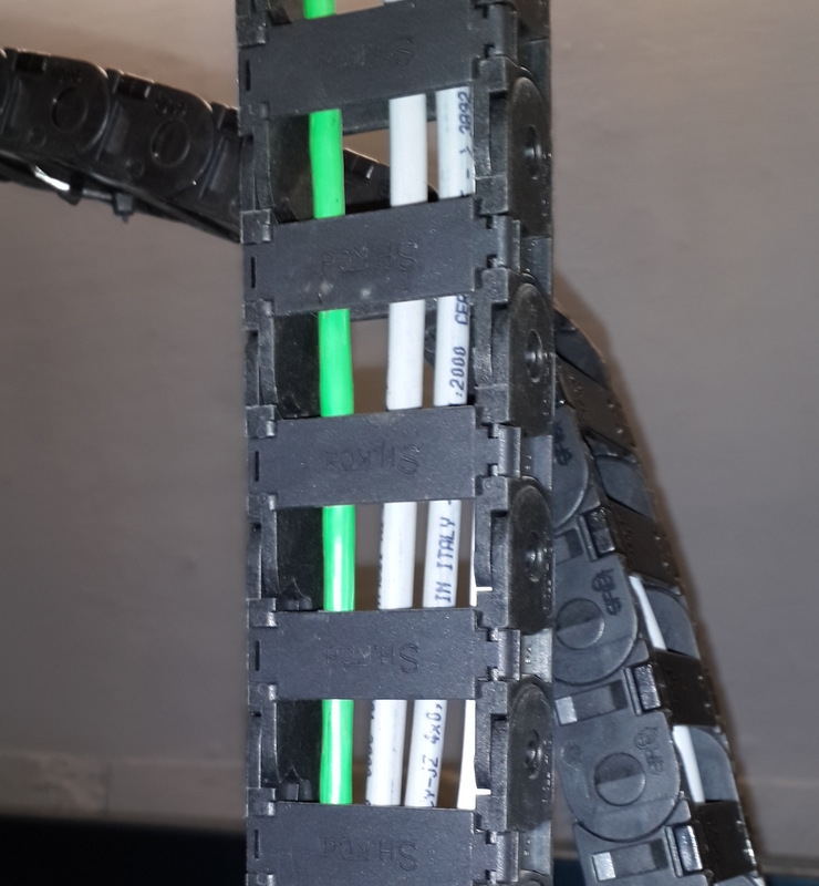

    You may notice two Echains feeding the same location on the Z axis? One has data, the other power. This principal is applied to the whole machine, data down one side, power the other. (Echain is cheaper than finding interference!)

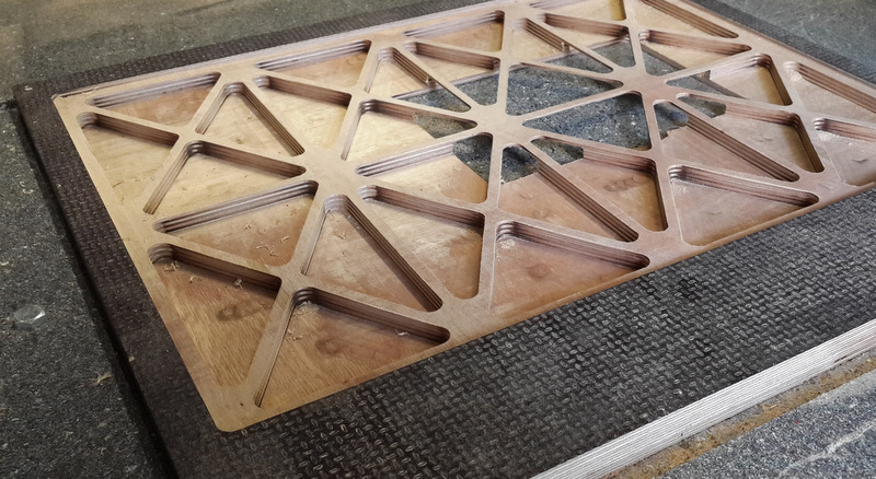

    Table, height adjustable and can be swapped out completely for 4th axis. 40mm box steel, weighs about 70kg without sand.

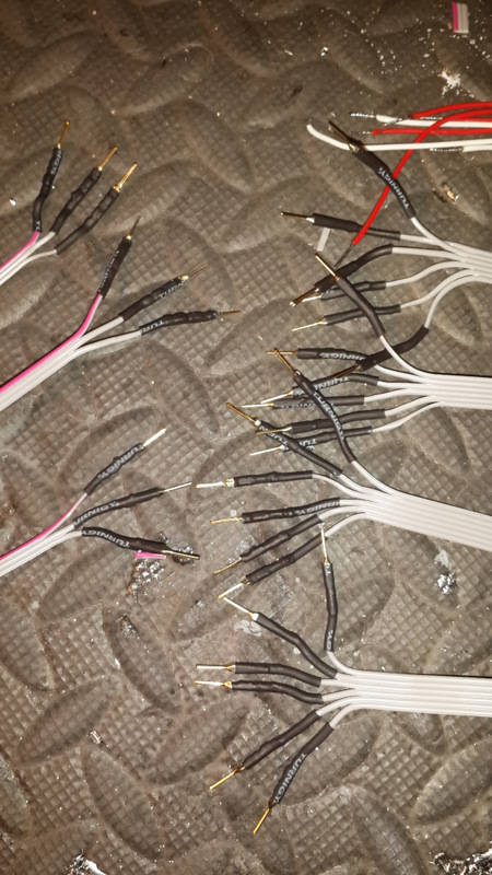

    some boring soldering... more to come on that... :)

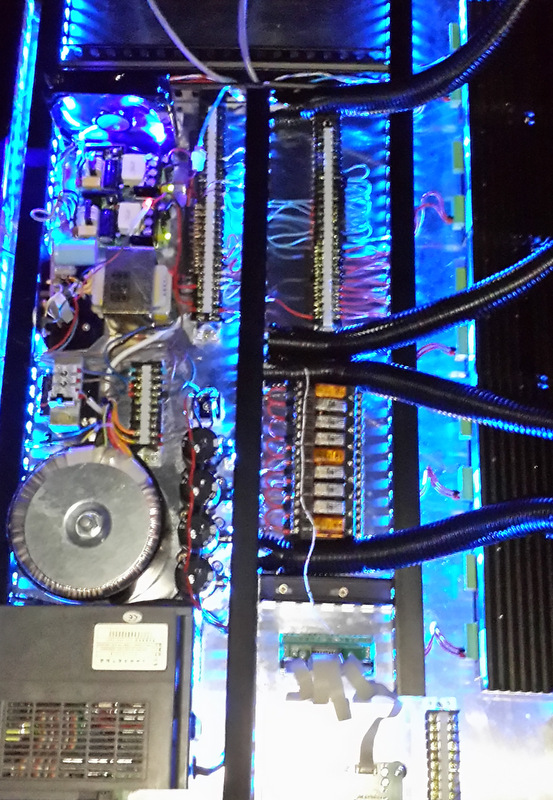

    Name:  sweet dream wiring 1 low.jpg

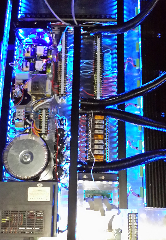

    The electrics section.

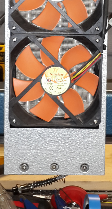

    Blue chosen as it matches my eyes! lol. The electrical "box" is er, unusual! The rear of the machine, has a base board across its entire size with hinges at the bottom (to the right in the above image), the view above is in the open position. Laid out horizontally with all the components easily accessible. In the closed position, airflow moves from the bottom of the box and out through the top. (right to left in the pic). aided by 12VDC 3 inch fans positioned by the transformers.
    The base board is 22mm Buffalo board with 3mm alloy sheet bonded and screwed to it. This alloy sheet acts as the ground plane for all circuits and helps simplify the prevention of the dreaded earth loop. The hinges are positioned such that in the closed position, the base board, with all the components bolted to it is slightly over centre so gravity holds it closed. The alloy base board ground plane is electrically connected to the main frame.
    From top left heading downwards;
    (just out of picture) mains in, massive mains filter, 4xMCB, mains distribution rail in 150mm conduit.
    (in picture)
    Transformer cooling fan low voltage distribution
    2 x 5VDC transformers
    12VDC transformer
    24VAC transformer for relay cluster and high voltage distribution
    toroid transformer, rectifier and smoothing caps.
    inverter
    Moving right in the image
    central conduit (75mm)
    right of centre conduit
    Power to machine front (round conduit)
    secondary distribution board
    data feed front of machine (round conduit)
    data feed to Z Axis (round conduit)
    Relay cluster including hot swap spares, (to Omcrom micro switches, Estop and height gauge)
    power to Z axis (round conduit)
    BOB
    8A drivers far right.
    All cables are numbered for easy FF. Thankfully, apart from a microswitch wired to a spare relay, no issues with cabling.
    That brought a smile (mainly of relief!)

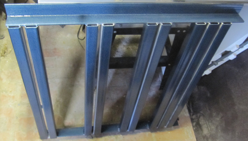

    The cable runs use Igus echain but some, eg linking the rear base board to the 5 screens at the front are run through the frame. Prior to assembly, the frame members were machined to accept lengths of 22mm copper pipe. These are electrically bonded to the frame and act as conduits for the cables and keep the sand off the wiring.

    For the frame, I went for a PVC thick wall tubing with copper plumbing fittings. Skate bearings and ACME thread and I found a couple of old plastic pallets to use as the bed too.. LOL, only joking, just checking you're still awake. I realised fairly early on that for the performance I was wanting, a hybrid of bolted and welded steel construction and profiled rail were the right option. So large quantities of 80mm thick wall box section steel were calculated. The Hiwin catalog and price lists took a beating too.

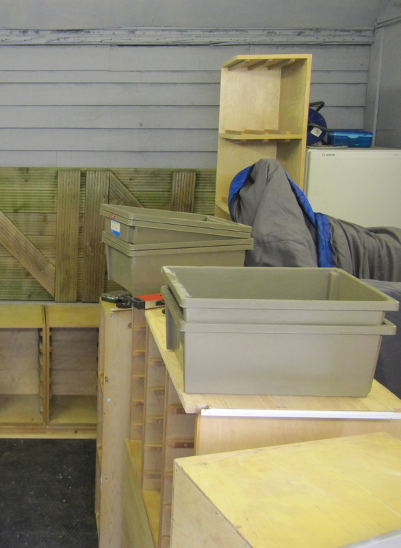

    So first build a workshop! lol..
    it might fit in...

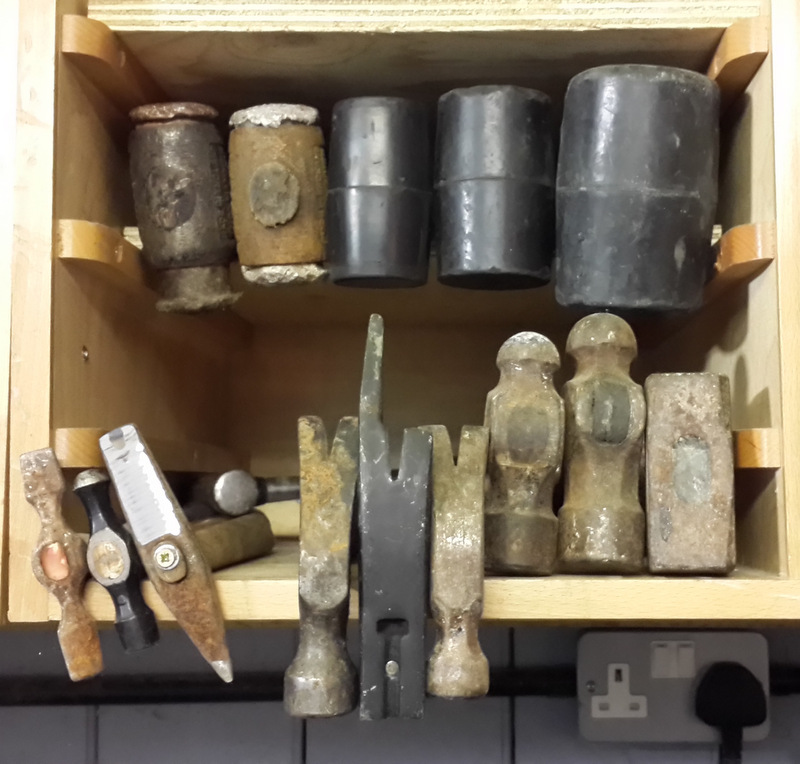

    or convert an old shed. After repairing the roof [picture coming] putting in a concrete floor, [find pics] some storage arrives courtesy of hearing about them being thrown out!
    The wooden carcasses are solid but the plastic trays look a little fragile. Might swap them out for wooden ones as and when they break.

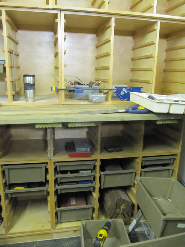

    I've ended up with the back wall of the shop, floor to ceiling with these bins and a bench cantilevered out between them at a suitable height for standing at the bench. I had enough left to put them on one wall from head high to the ceiling giving a total of about 200 bays, 17inches deep, with either 3 inch or 6 inch high trays. Some I put shelves in as seen in the Hammer store below.
    looking better..
    The storage starts filing up...
    All workshops should have a good selection of tools!
