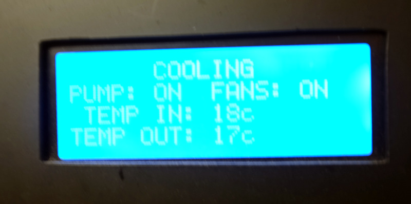

    18DS20 sensors at the input to the spindle and output of the radiator send the temp data via a one wire system to the Arduino Mega that is looking after the cooling. That looks at the difference in temperature and either turns the radiator fans on or off and feeds the current status to a small LCD screen.
Name:	temps screen.JPG
    phone pic, sorry. :(
    Pump on, fans on, temp in 18c temp out 17c. There's not a lot of heat generated by the spindle, haven't seen those numbers move much.

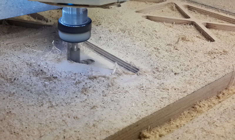

    The radiator is bolted to the back of the Z axis with rubber spacers and the fans pull cool air through the 5mm gap and venting to the rear of the Z. Foam could be used as an air filter between the radiator and the back of the Z if required but there is, as yet, no sign of this being an issue despite routing some ply down from 22mm to 6mm.

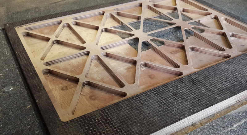

Name:	lam finished.jpg
    image above is a the reverse of holder for a remote monitor and e-stop, allowing me to keep an eye on operations from the comfort of an easy chair. ;-)

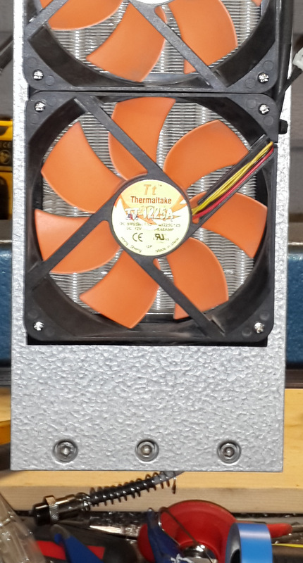

    The 3 fasteners above remind me that anywhere I had a horizontal fasteners I'd use 3 of them but vertical fasteners were used in 4's. The Z was fairly tight on space, as per the design spec, so this strategy kept them apart.
