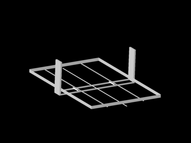

    Have finally settled on a single motor, single leadscrew, but with extra bearings and rails under the gantry. I know I know... Pictures..! I will try to put a couple of sketches together tonight and post them..
    Have listened carefully to everyone's if, buts and maybe's about dual driving and have to agree that a single drive is much less prone to errors, and belts are, in my experience, another added layer of mischief..
    But I do think it important to stabilize the gantry as any yaw will not be acceptable. To this end I have come up with a way of using additional track and bearings (as these are so cheap) to give extra guides to the gantry...

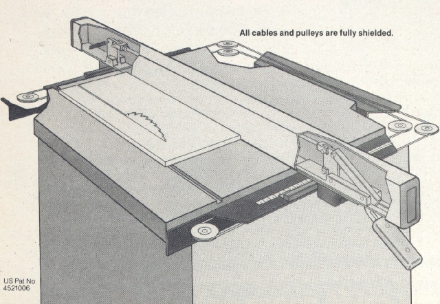

  6. But I do think it important to stabilize the gantry as any yaw will not be acceptable.
    What about a cable (or two) wrapped around pulleys (like a drawing board) ?
    Quote Originally Posted by BillTodd View Post
    Apparently works incredibly well too!
    Jeff.
    Any pics of that? Will do some sketches of my thoughts later, gotta 3 year old with tonsillitis to sort out today..!
  9. One method:
    (pinched from http://www.cnczone.com/forums/showth...le+rack&page=4)

    The cable design looks funky! But I am still unconvinced by using an active system, I would be concerned about slippage, stretching etc.. Not sure if I have uploaded the image properly in this reply, but if I have you will see that I have added two tracks under, and attached to the bed. There are bearing runners attached to the inside of the gantry base that locate onto the tracks.
    Have not drawn it yet (have not finished designing it) but the base of the unit (the whole CNC will sit on top of it), will also have another pair of tracks that will fit to the bottom of unit, that will locate to a further pair of bearing runners attached to the underside of the gantry for further stabilization...
    Hope this is clear, if not ask away and will try to further clarify it. I like this principle as it is passive and cheap..
