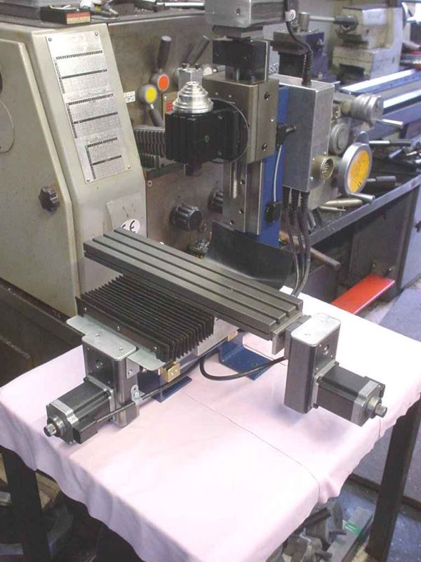

    This is a Taig mill I converted to CNC about 4/5 years ago using belt drive.
    It was done this way because I didn't want to use the flimsy Taig mounts, it could have been more compact if I had reversed the motors but I wasn't worried about space, just wanted a robust mount. Cons of this setup are you are still reliant on the original bearings for thrust / preload unless you re-design them.
    As an aside why when people do direct mount conversions do they hang them out on studs looking like a grandfather clock ? It's got to be the least rigid type of mounting known to man or beast.
    Going direct mount if you put a bit of thought into it you can get a quite compact and rigid design.
    This is the X axis off an X3 CNC conversion, Nema 23 motor but it's the longer triple stack motor, note the mounting which is only 60mm deep, this contains two angular contact preloaded bearings and the Oldham coupling.
    Everything needed is in this mounting block, very rigid, completely sealed and far more compact that the pillar mounting that everyone seems to choose.

    When you say Angular Contacts - do you remember the spec + angle? I assume that these are for the leadscrews and the house acts not only as a motor mount + coupling guard but also a leadscrew support block with angular bearings, spacers, etc?
    With the couplings ... what method of attach is best ... woodruff, set screw ... etc?
    Same if you were to use belts what would you suggest? as it would have to be considered before the ballscrews are turned
