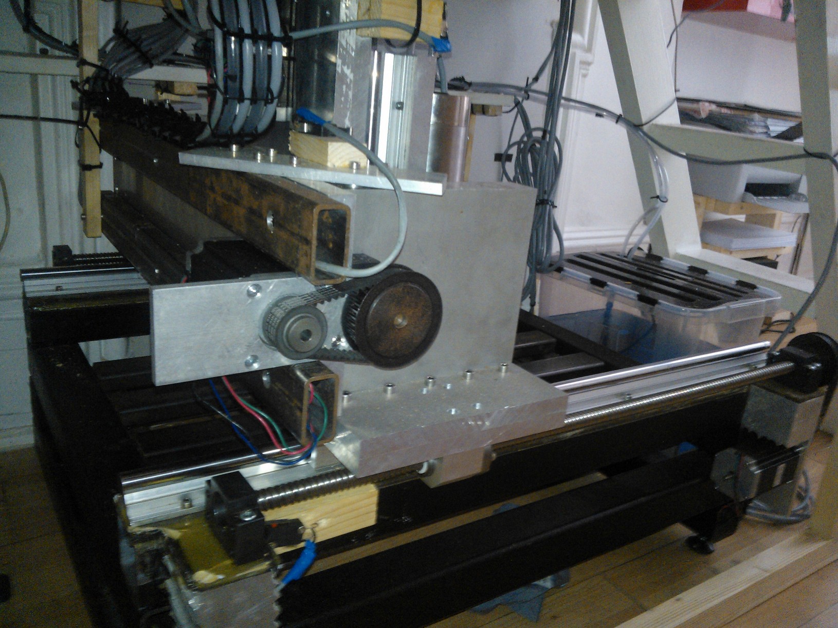

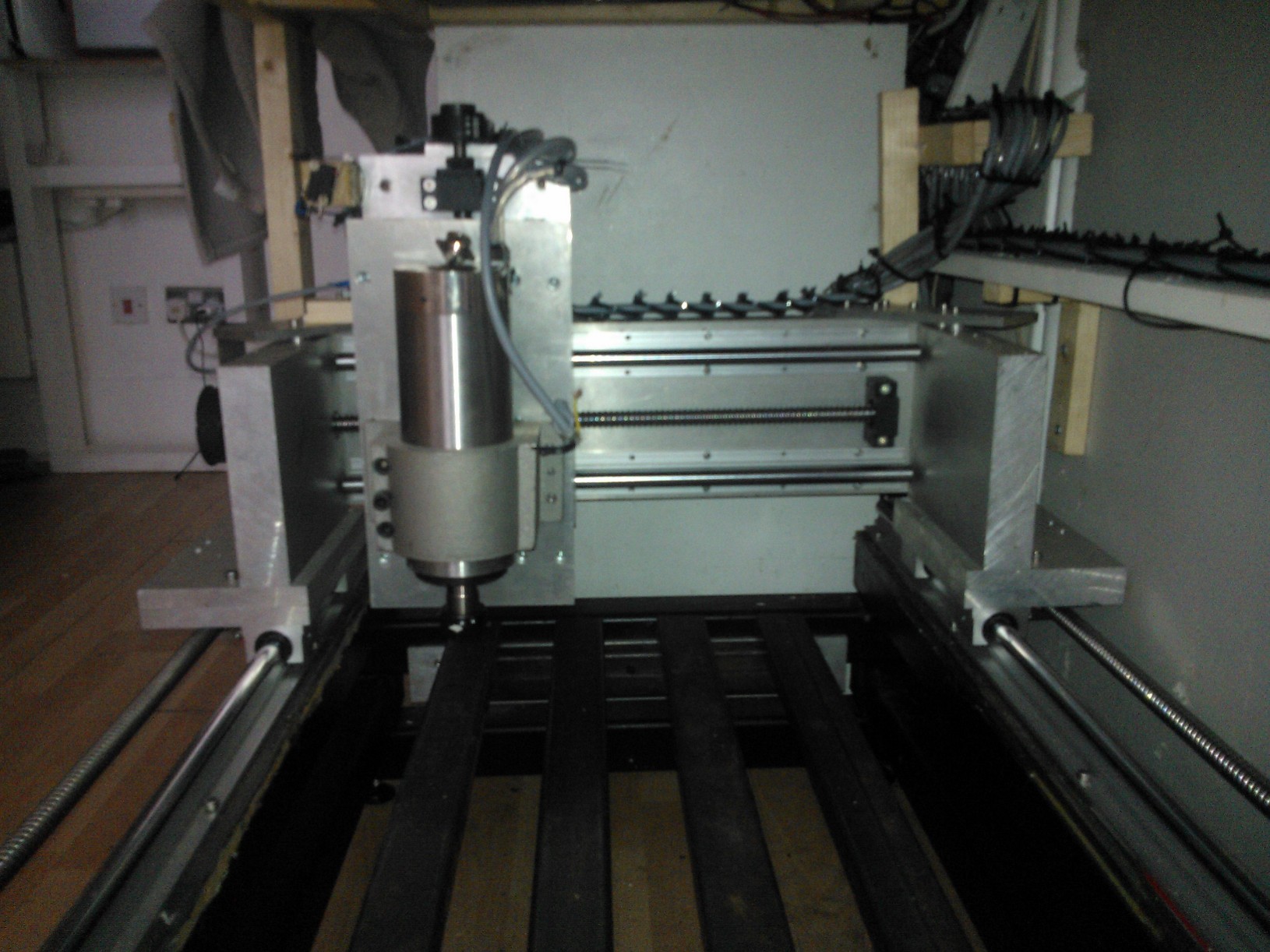

    What with my machine being very nearly finished, I thought I'd throw up a few pics for you to gawp and tut over.
    I sacrificed rigidity of build for a simple build. I'd never tapped a hole or drilled a piece of metal before the start of this so I'm reasonably happy with what I ended up with. Obviously I'd do about 90% of it differently if starting over, but c'est la vie! I want to cut hardwood and a little plastic on it.
    I haven't been able to give him muchtime recently (him or her...? I say the spindle makes it a him) as my mother was diagnosed with Stage IV cancer so its all hospitals and chemo at the minute but she said she would like to see it going before she does (got to love the gallows humour) so I am back to tinkering.
