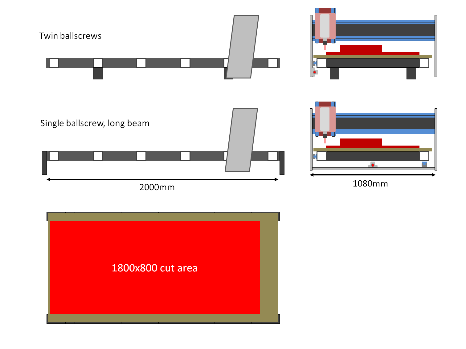

    I've now made the decision to get a bigger machine, so it's time to explore the various possibilities and either import, buy, build, or get someone to build me something.
    I'd like a machine that is stiffer than my cheap 6040 for cutting plastic, and also big enough to cut 1650x590 wood panels. I'm thinking of making do with a 6090, but this thread is for exploring a machine sized for the job (and some spare width for larger designs that the 6090 won't be ablo to do), ie 1800x800.
    So here is a general layout.
    The things I need help with are making the decision on construction materials and methods. Welded square steel tube, or aluminium sections are the two main choices.
    Also single or twin ballscrews on the long axis? I think I prefer the twin design and the base will be easier and more compact, but I need to work out the cost delta. The single ball screw makes it easy to undermount the rail, if that's a good thing?
    I can get a steel frame welded quite easily, but then how to align the rails on it?
    With aluminium section, I guess you rely on it being straight? Then the question is how to square up the frame. My friend suggested poor a concrete bed and bolt it down to that to get it flat (equivalent to epoxy method).
    I will start to gather some prices for parts, hopefully people will then comment on how to do it cheaper.
    And, before anyone asks; No, I don't want to make it 1200 wide :)

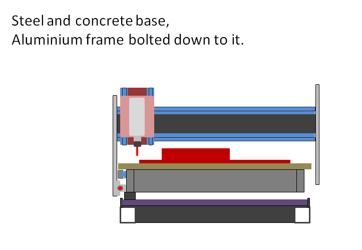

    The concrete base idea would be something like this.
    It looks like a lot of work and materials now, but if it would work, it does require much skill.

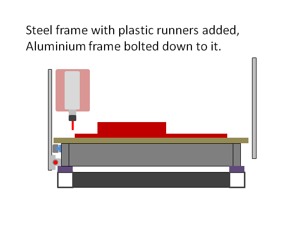

    Weld up a steel ladder frame, bolt strips of acetal to every member, and take it to a friendly wood cnc place and get them to skim it flat. Also drill some locator hole where you will tap and thread later.
    If you had a flat surface, would that be enough to ensure a straight linear rail? ie can the rail be reliably attached to the aluminium profile and be straight, using countersink washers and screws or something like that?

    IMO the best thing to build a frame out of would be Sq section steel. There's no advantage to making a steel and concrete base, or steel and acetal frame so they're accurate and then bolting an aluminium frame to it that's probably not as accurate. Make the whole frame from steel, build in lots of adjustability and shim/file/fill the top rail (or go the self leveling epoxy route) so it's flat and fit the rails (which if supported round will not be level/flat) to that? Round rails are best mounted upright as the bearings aren't as strong on their side. At 1800 or 2000mm long you're into 20 to 25mm ballscrews to stop whipping at high rpm and Nema 34 motors...or rotating ballnut on 16mm ballscrews. Have a look at Kingcreaky's builds for inspiration (I'm sure there are others like Jonathan's first build to look at too but his spring to mind first as large wood routers, especially the last one!!)
    If you want to do any concreting, name a nice flat base for the frame to be bolted to.
    Neil...
    Build log...here

    My acetal rails plan would do the same thing, as long as the larger cnc has a flat bed. I'm not sure how my cnc place would feel about helping me make my cnc machine though! It's an obvious money loser for them.

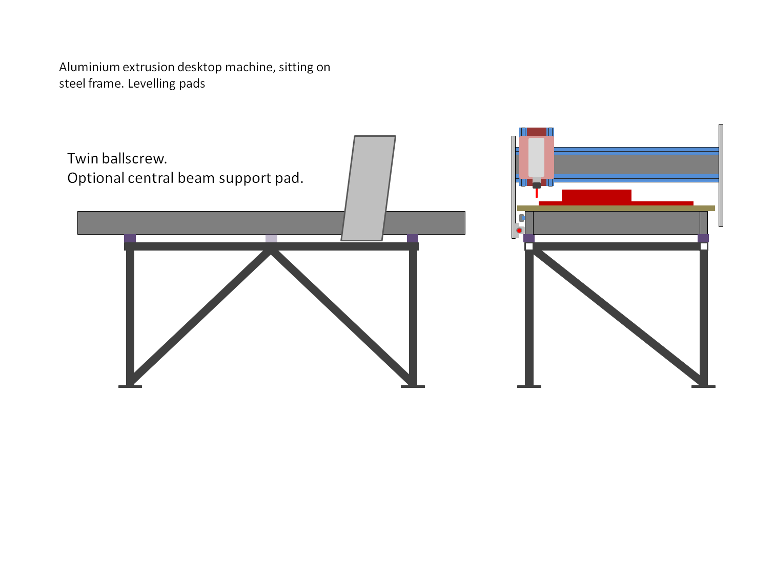

    I'm thinking now that a welded steel frame is making life hard for me. This is for wood mostly so an aluminium extrusion design might be more suitable. I quite like this design. It looks easy to move/install elsewhere which also makes it more re-sellable than a great big welded frame.
    The question I need answering is: Can you just bolt a hiwin rail to an aluminium extrusion, and the result will be straight enough for wood panel cutting ?

    You mentioned a larger screw being needed, I guess that depends on feed rate as well.

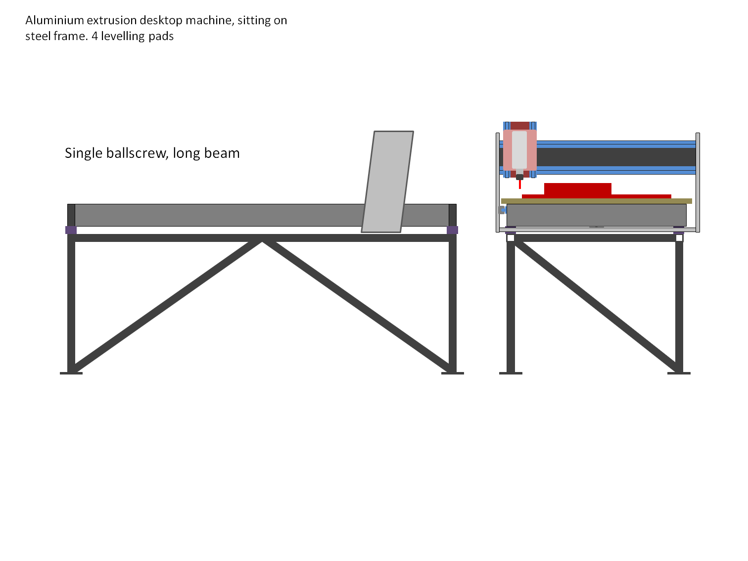

    The other structural option is single screw with a long beam.
    Can someone help out with rough estimate of the cost comparison. I need the cost of a twin ballscrew set-up versus a single screw for 1800mm travel. That includes the screw assembly, and the motors and motor drives. I realise there's a lot of calcs in that, and it will take me some time to track them all down on the forum.
    Here's the single screw layout, I'm not sure I even like it. If the beam is going to need to be deeper then that's already counteracting the single screw cost saving.
    If someone was to say forget single screw, you need 2 screws, I wouldn't be upset.
