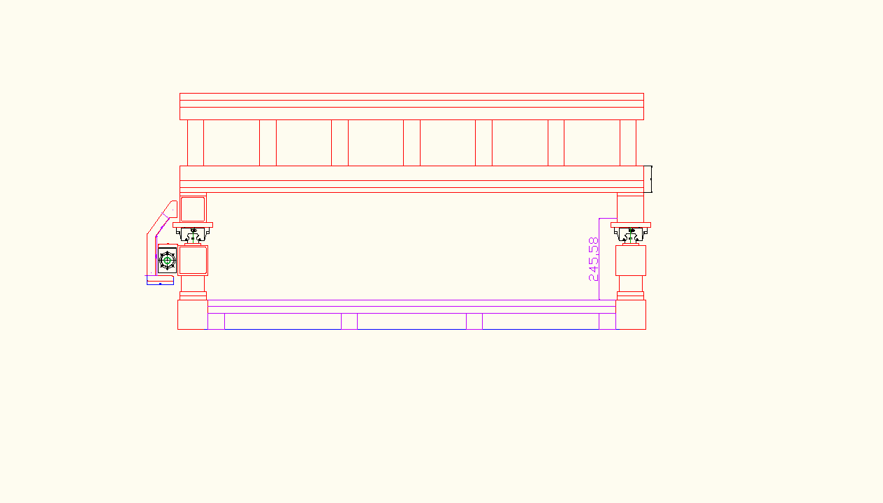

    Point that look not right to me on your design:
    Ok, you will weld 2 beams together for the gantry, i did the same , but where are the side plates that are soldered to them at both sides. They will bend and if not, they will vibrate. They can not be left open.
    Gantry legs. i see one plate in the middle that will reinforce them . One is enough against left right bend, but not against twist. i would put 2 on each leg so they form a box.
    Web Goblin, your gantry looks very nice. What you intend to do with the gantry legs? Why you did them like that? You plan to fit the screw there? I contemplated this design for compactness, but for my liking it seems weak for left right forces. I would have reinforced this place with closing the beams and drilling holes from above to fit the screws to the bearing blocks.
  5. #15
    I did the frame this way because I thought it would give me the best strength while still getting full travel of the gantry rails. The join between the cross rail and foot plate is fully welded and should be very strong.
    The bearing blocks are mounted below the "foot" plate. The bmp from my cad drawing below shows how the blocks will be fitted. The top cross bars are not shown here but they will add more strength for left/right forces. The position for the ballscrews is shown as well. These will be covered as well to try to prevent swarf getting to them.

  6. #16
    heya silyavski
    i agree ! end caps are a must ! i intend to have a few internal webs to prevent twist
    im not convinced on this one ... if there was only one arm, then yes for sure , but the other arm of the gantry prevents the twist
    i think for now im going to go with filling the frame with sand ... but the gantry , im going to try out a epoxy fill
