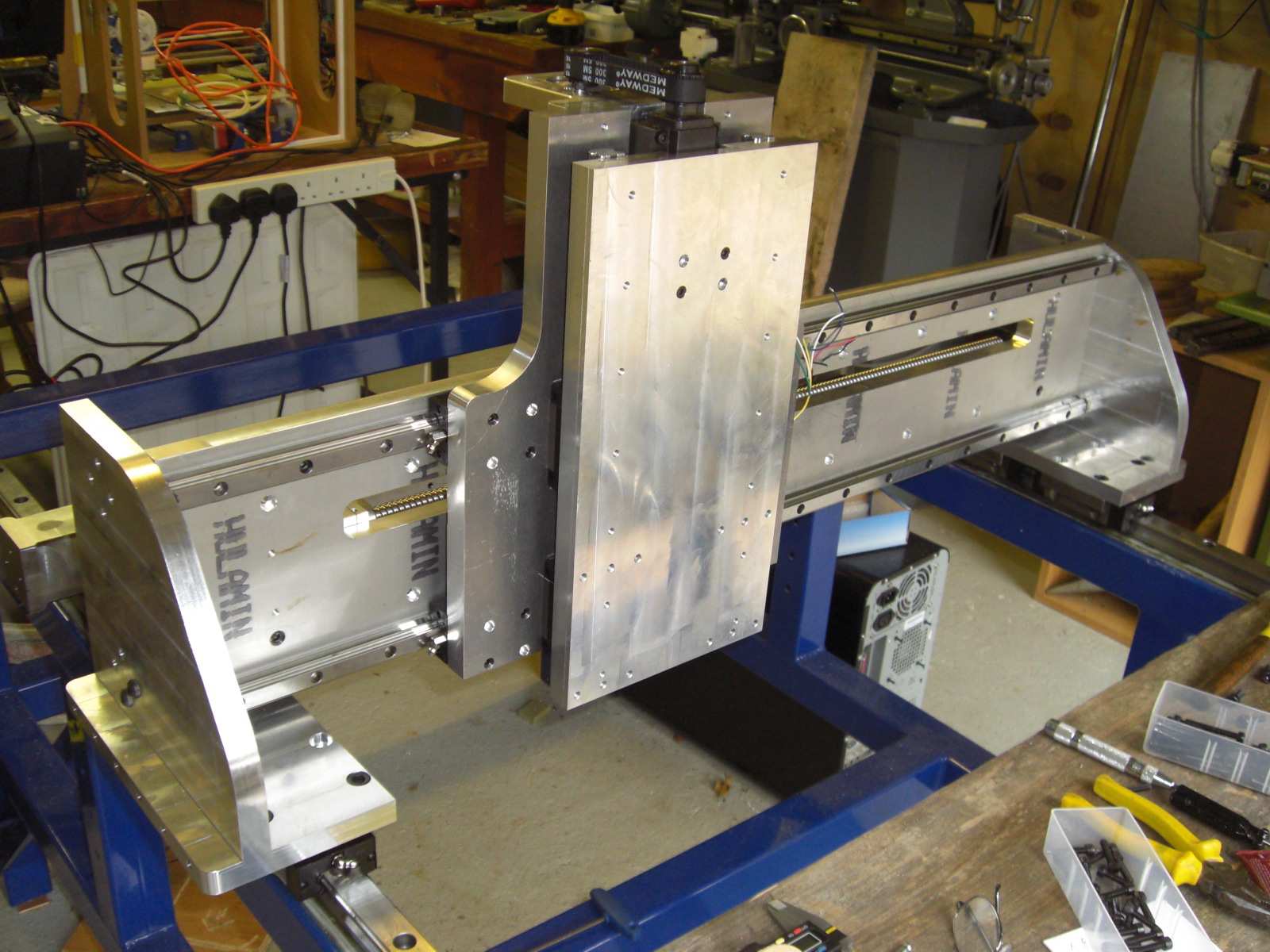

  6. #36
    a little progress ....
    i thought id try out using epoxy between two steel sheets and i gotta say it works great ! there is no ring from hitting the the beam , and its not 'that' heavy
    wish i could have done some before and after tests ... but i dont have the time right now to play
    did a quick test run of the X and Y axis today , its super smooth and so quiet, man you gotta love servo's !

  7. #37
    Looking great! How did you manage to weld those plates with the oval holes inside the tubing
  8. #38
    i cut the inner tubing into sections, then welded the oval plate piece and two rectangle sections together , repeat for the entire length
  9. #39
    Did the inner tube have to be metal or was it part of the strength too ?
  10. #40
    yea must be metal as this completes the sandwich ..
