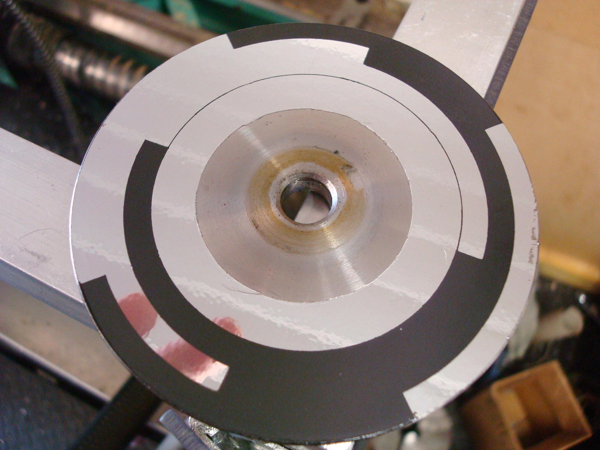

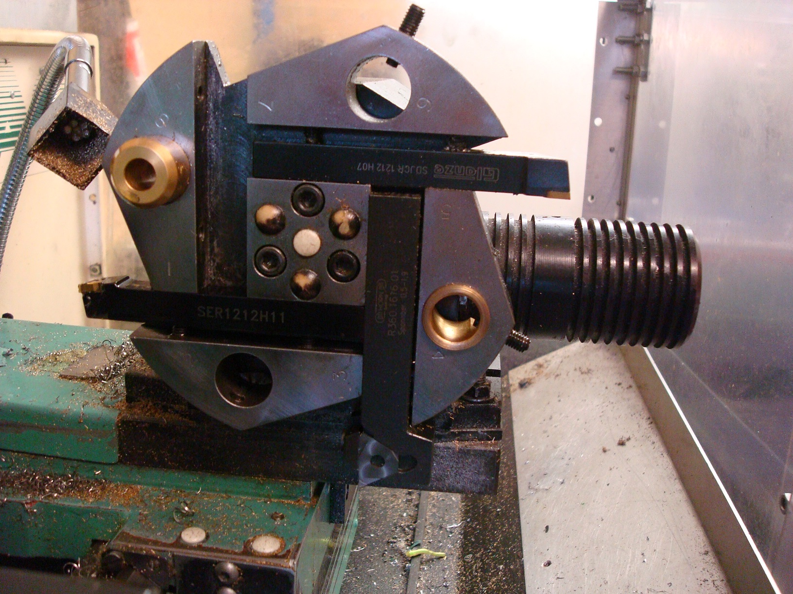

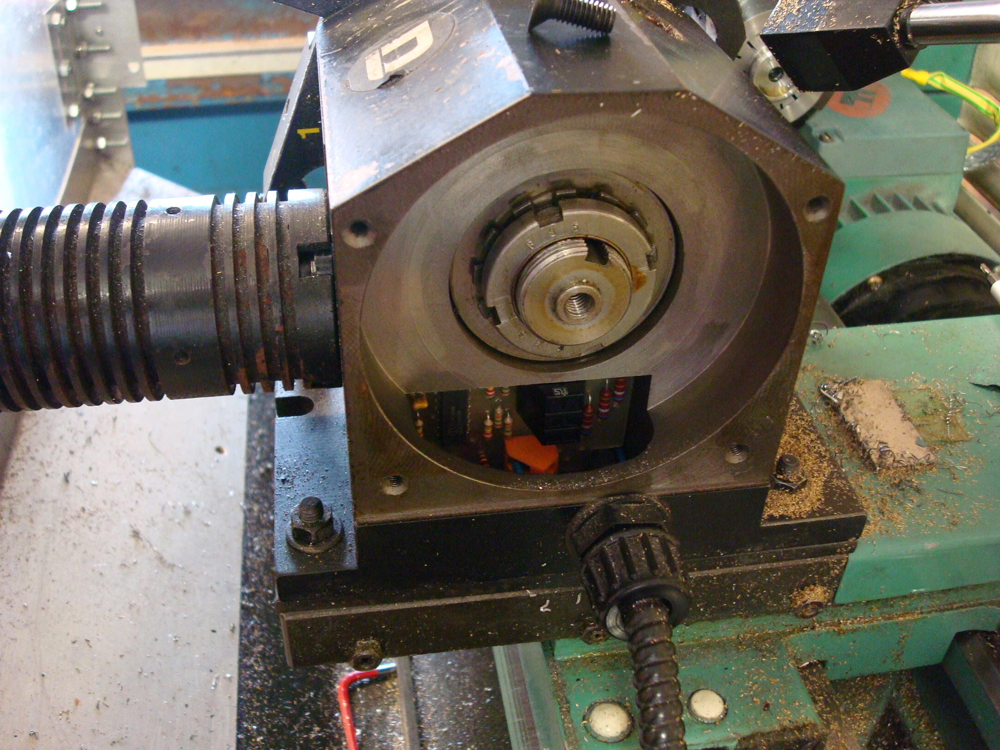

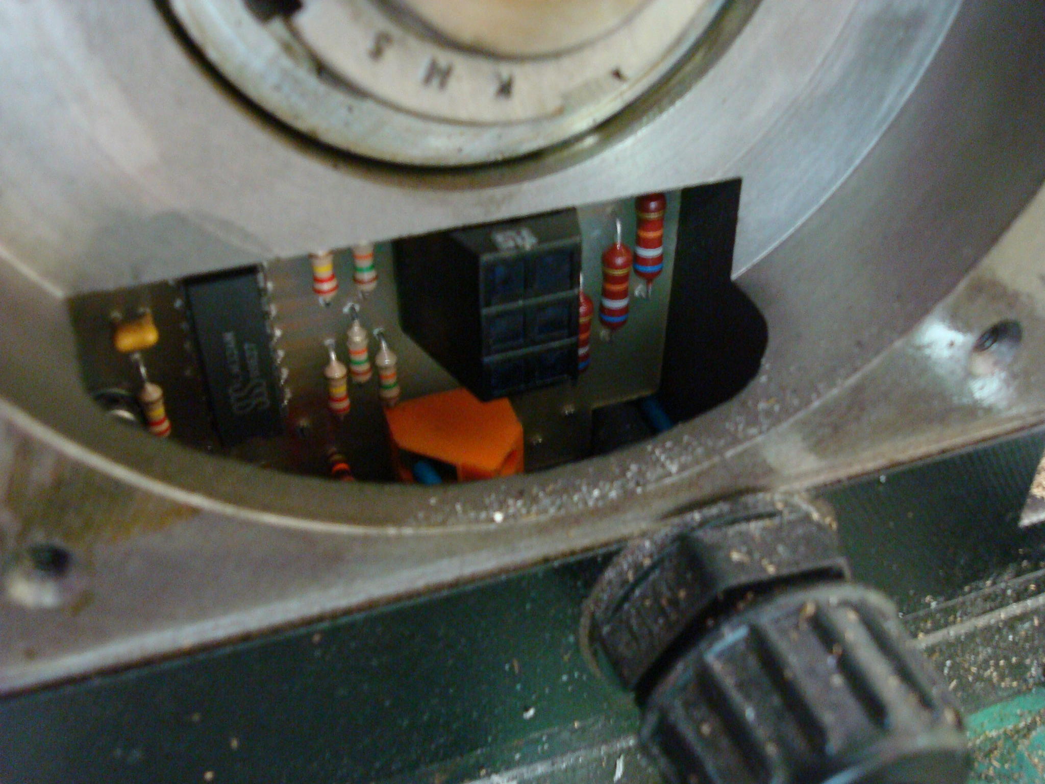

    one of my main issues and where i get totally lost would be how to run the ATC turret, as standard it runs from a small dc motor driving a worm that has a constant 12vdc reversing on to the paw, and 24vdc is applied forward to index, i have no idea what i'd need hardware wise
    there are some sort of optical sensors inside the turret but how i would get mach to read these is beyond me.

    some pics of the turret
    back plate off
    close up sensors

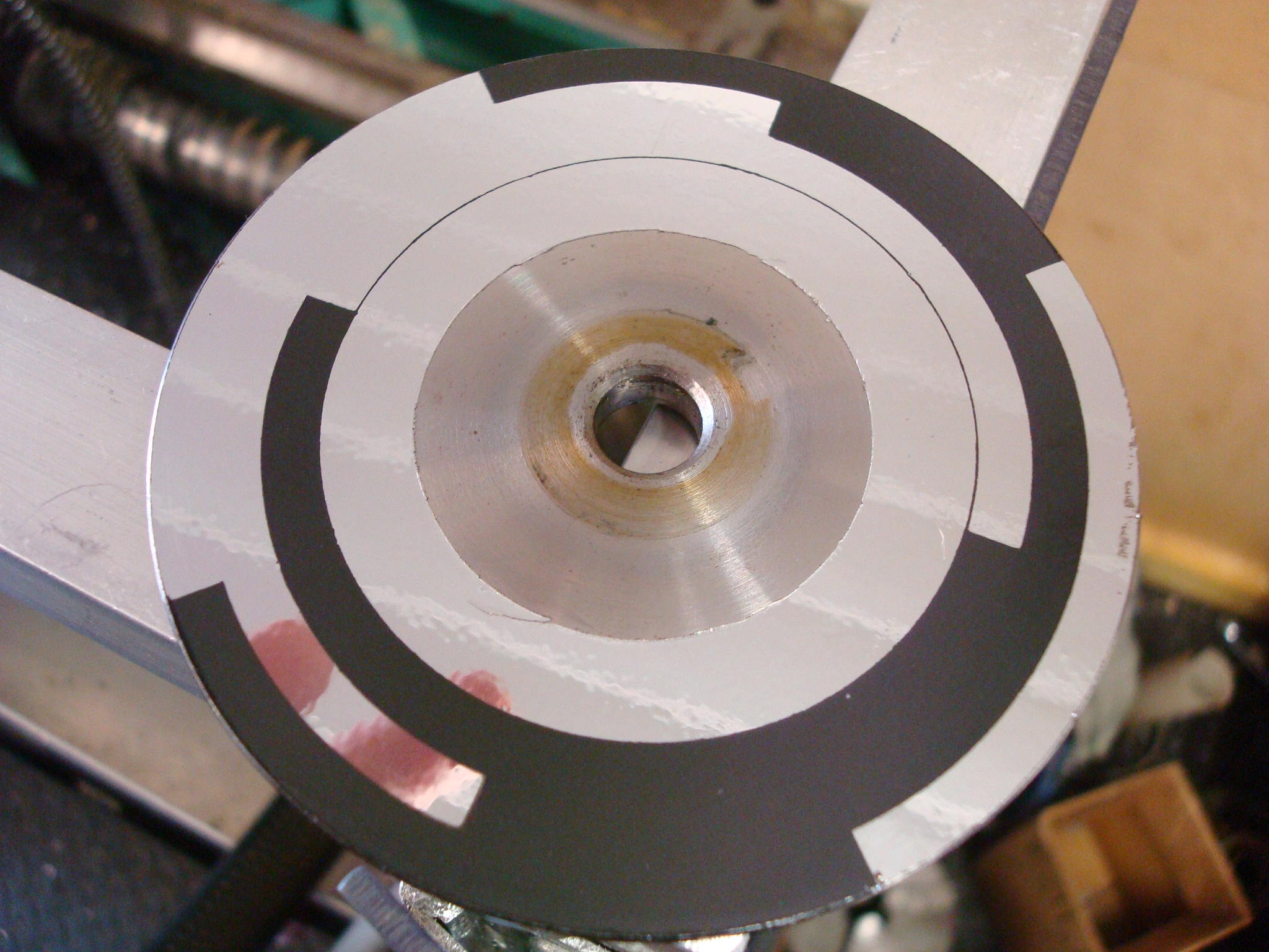

    back plate for sensors
