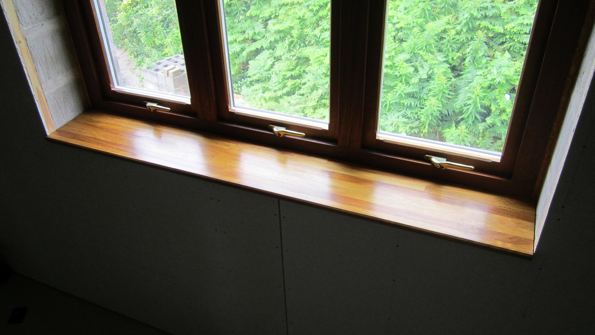

    I have used some glue i purchased from a guy on ebay and it has been fine for a few jobs i have done, one was a internal window sill, 3mm Iroko veneer onto a laminated softwood base this is holding up fine and Iroko is very oilly so I was quit impressedClick image for larger version.

    Will check my records for the trader if your interested

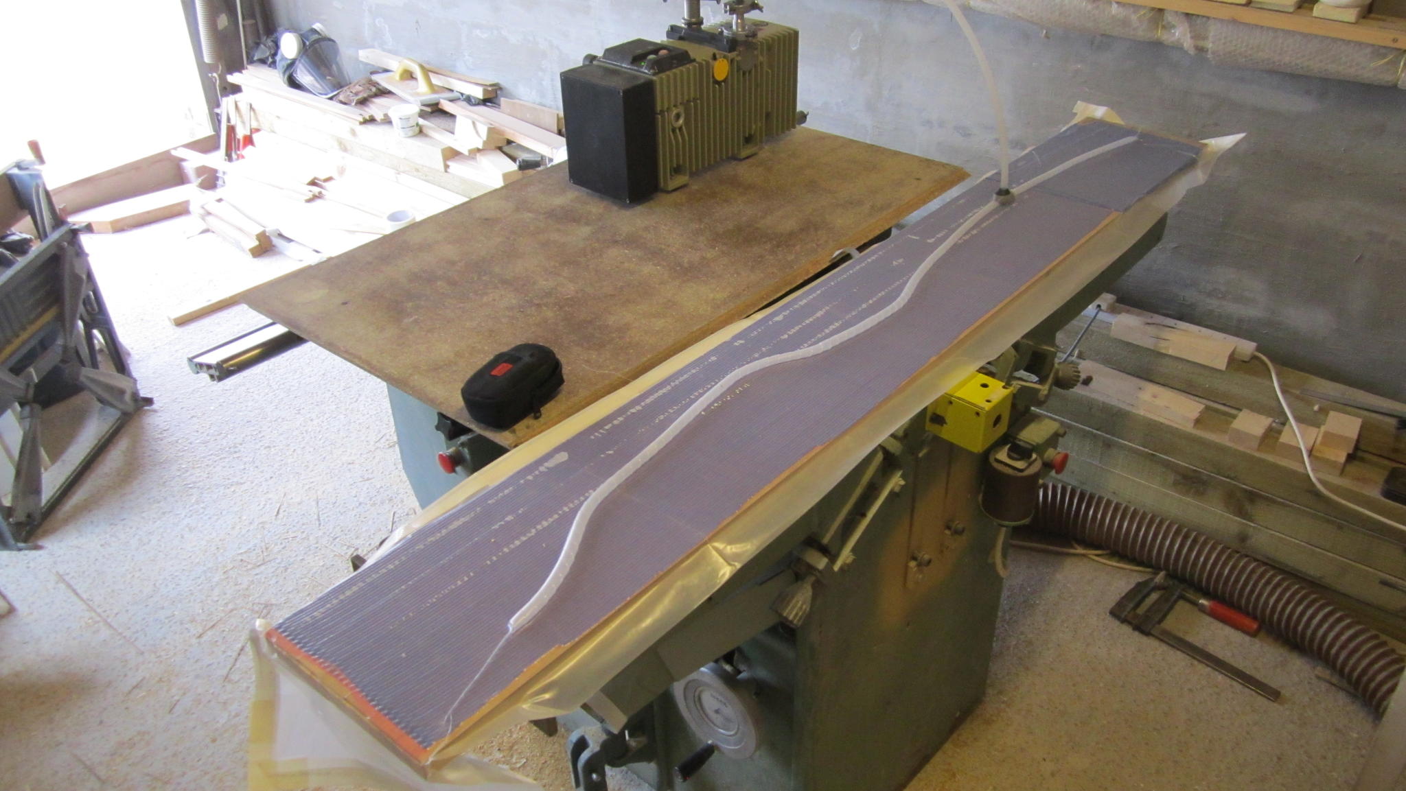

    Just out of interest did you have a breather mesh over the veneer ?Click image for larger version.

    I just had a piece of MDF on top of the veneer to help press it down and absorb some moisture but obviously it didn't do a lot.
    What is a breather mesh? You mean like some kitchen towel or more like a wire mesh?

    Hi Tenson
    If you look @ my setup you will see that the veneers are covered in a blue material, this is a plastic mesh that i use for doing vacuum infusion jobs, if you go to any online dealer that sells infusion resin you will find some there, the white tubing is spiral wrap. cheapest place to get this is Maplin(or it was when i bought mine) it's used for holding loose wires to tidy them up.
    If you notice you will see the glue extruded through the joints between the veneers. This was a trial run to see if i could make a half decent job of it as i intend to do all my sills the same (the windows are Iroko also)
    Hope that helps and good luck with your next shot.
    Mike
