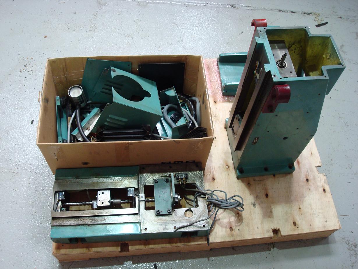

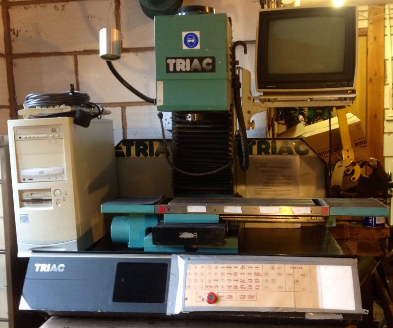

    I bought a Triac (The green one with stepper motors) and I started the conversion to run on Mach3.
    Here are some pics of what I've done so far...
    first, machine as received, then disassemble and got reed of the base (too big) ready for transport home!
ID:	6592Click image for larger version.

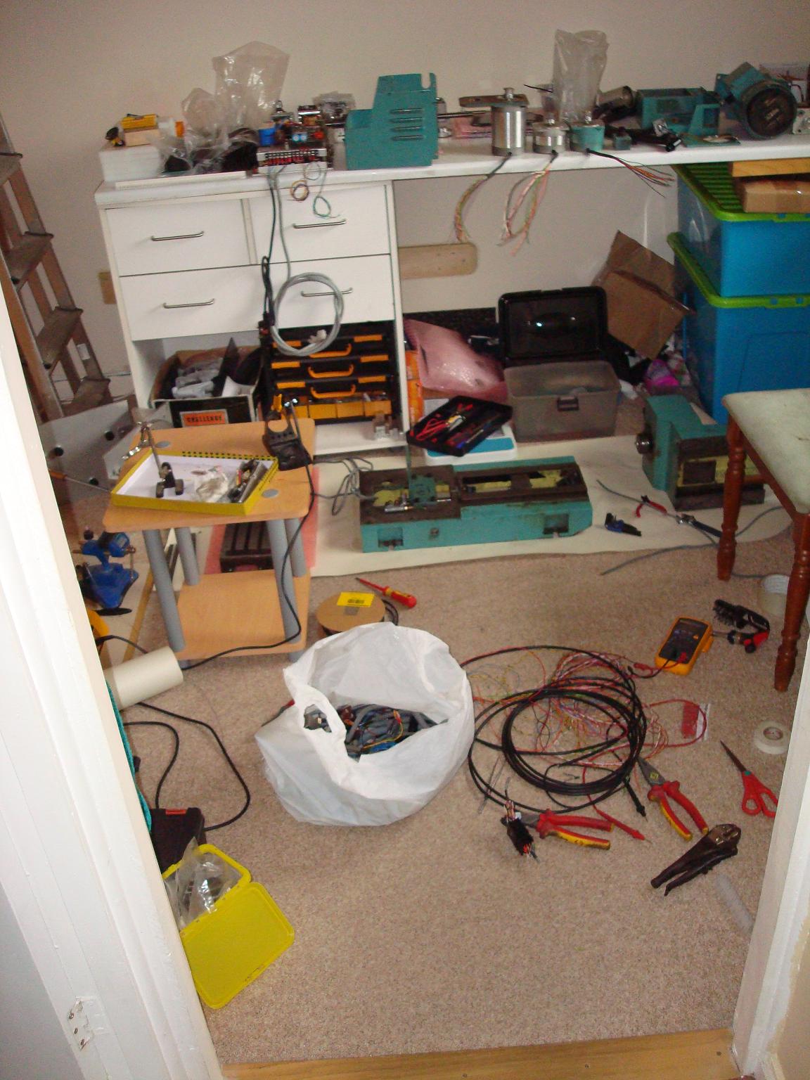

    Now, move upstairs in the side bedroom (yes bedroom... )

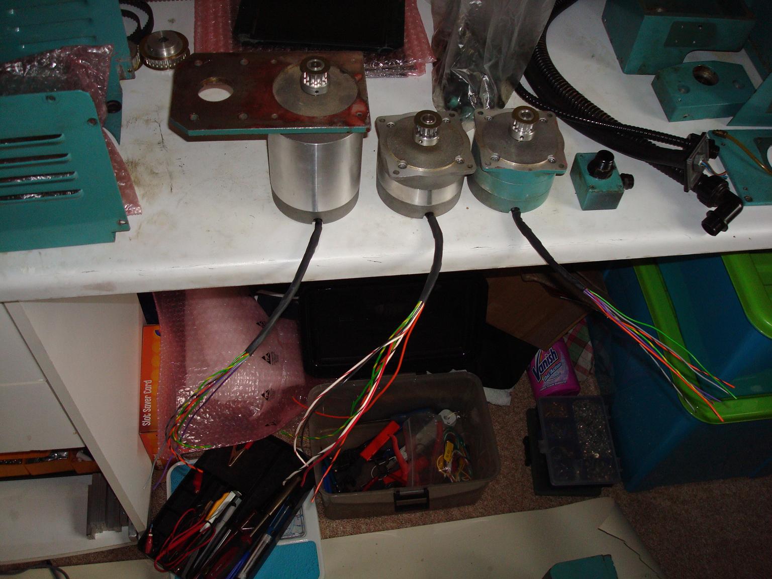

ID:	6594Click image for larger version.
ID:	6595Click image for larger version.

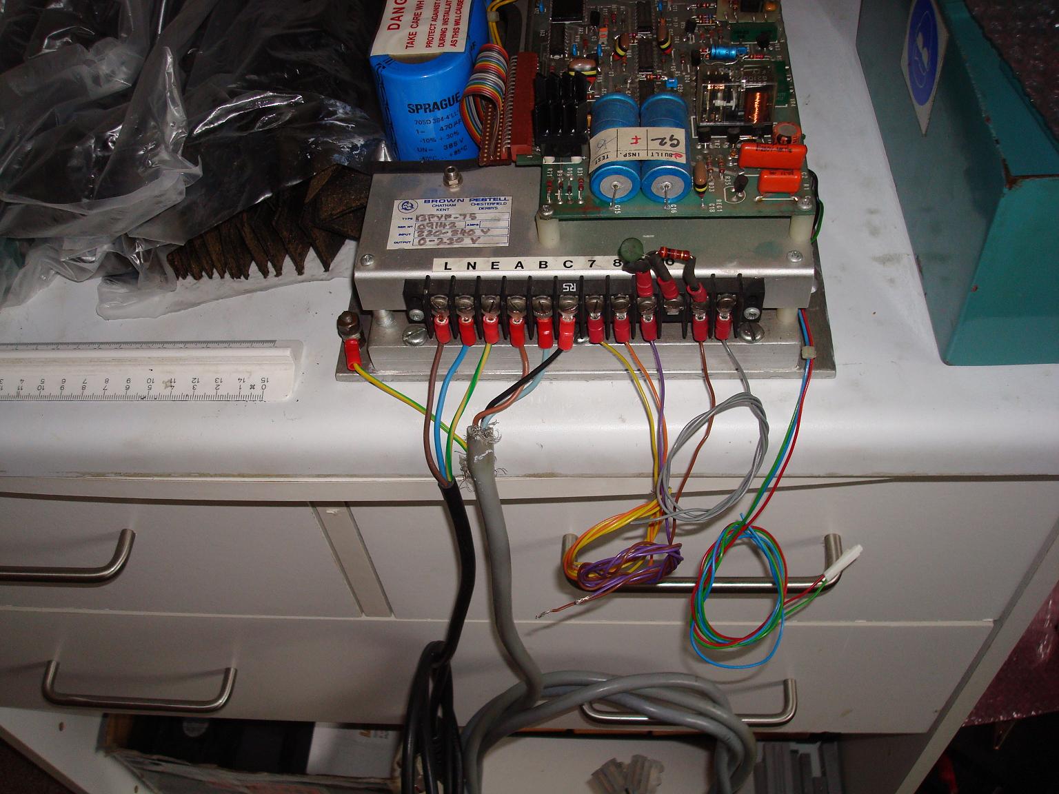

    Start wiring 3 Phase spindle drive and stepper motors.
    More coming soon !

    I received the electronic now, except for the 3 phase inverter.
    I got all 3 steppers running. Now looking for a suitable enclosure.

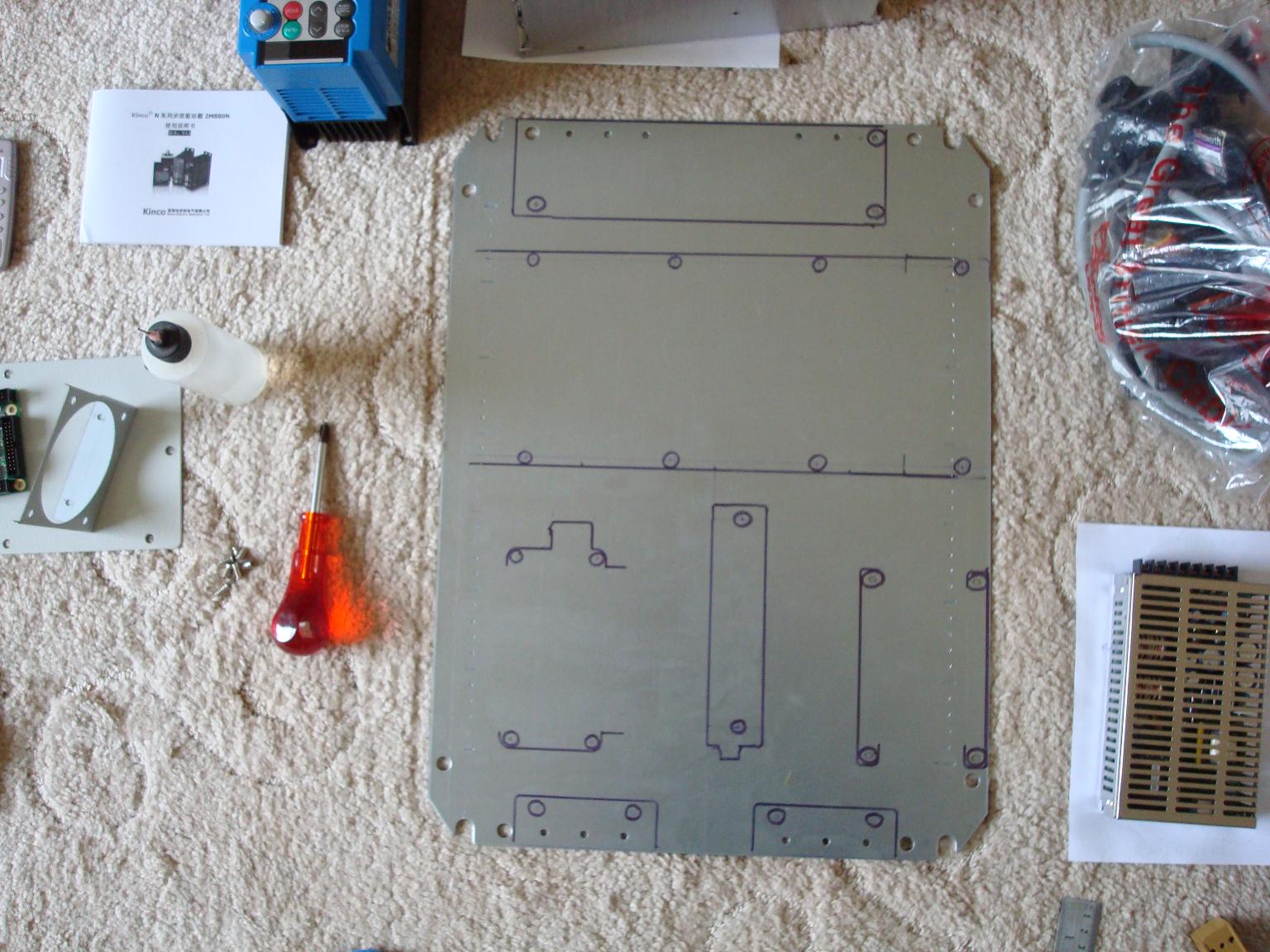

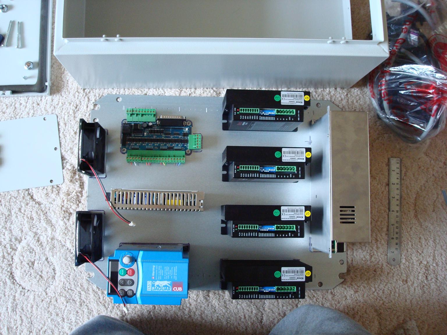

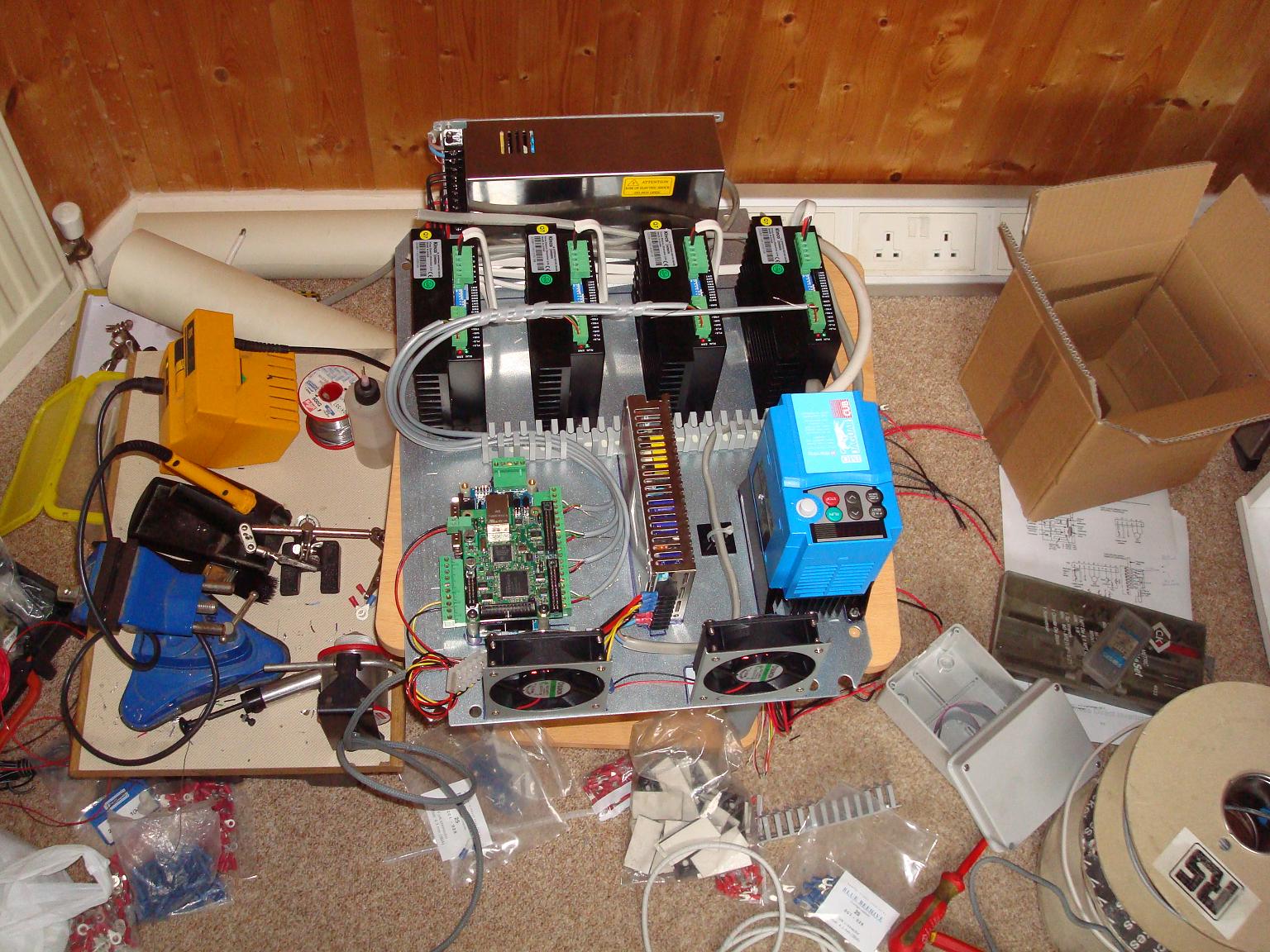

    Hi all,
    I started to put the new electronic together this weekend. See pictures attached.

    Waiting for more bits to before putting it all in the enclosure...!
