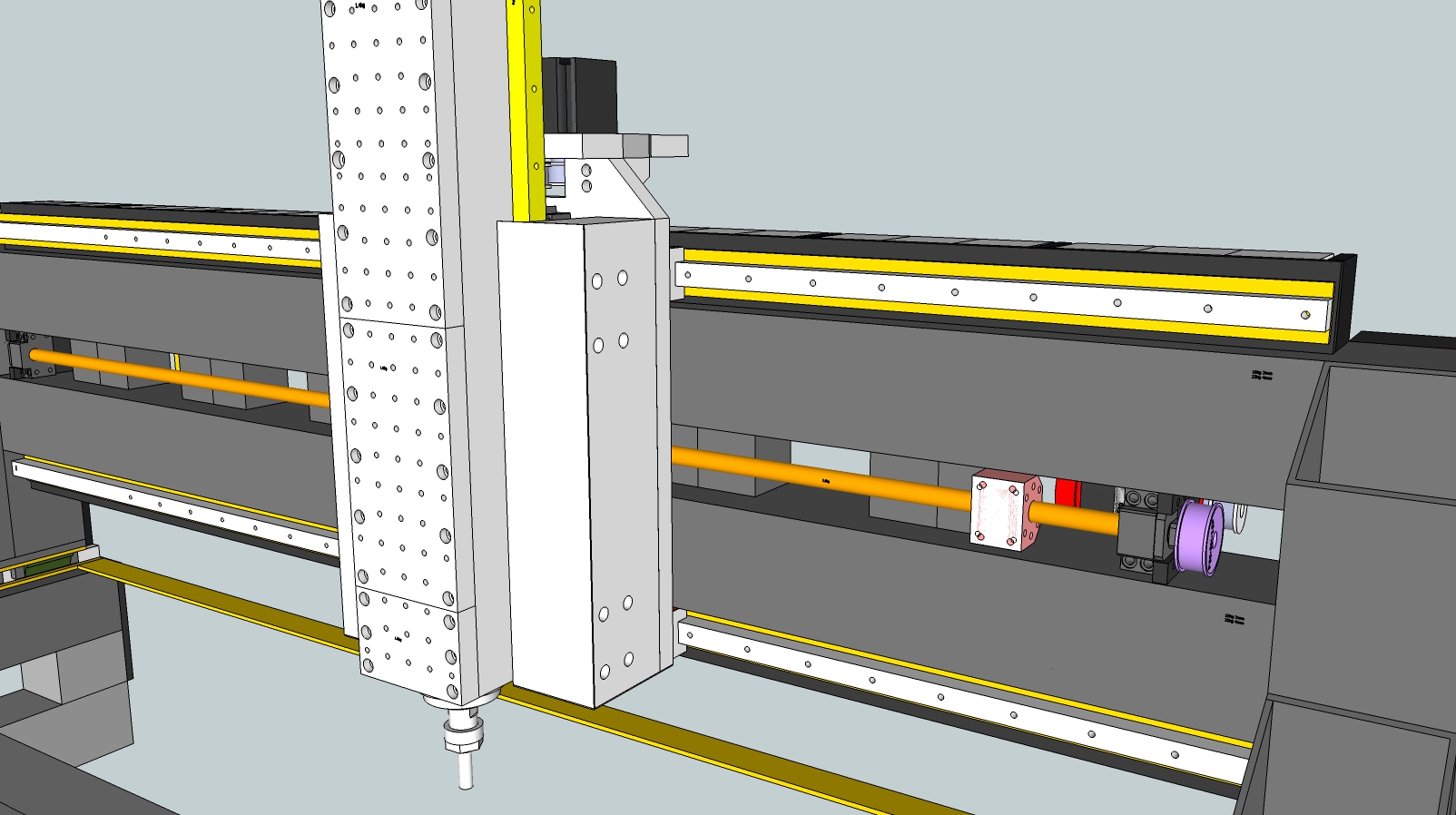

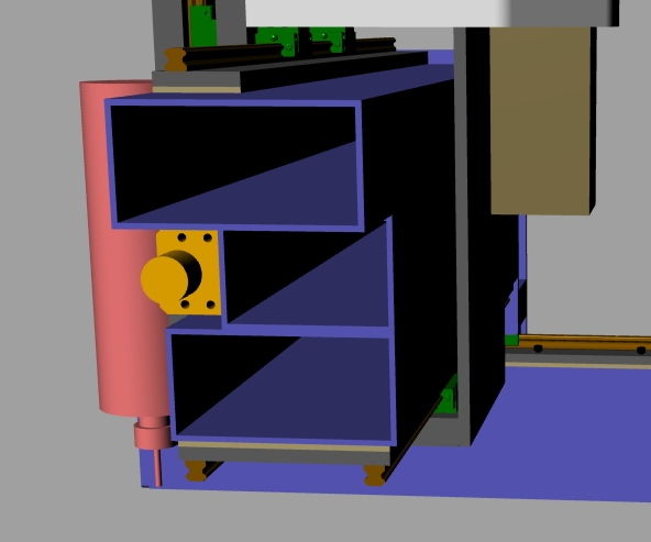

    Just saw your gantry. what size profile you use?
    I don't like that back plate there, only adds weight and no gain at all against twist nor against bend in the middle.
    Look how i do it on my build right now. Profile 100x100x4 up and down and in between 60x60x3 or 60x60x4 , 2 pieces soldered together, . The Z is 3mm from gantry. Just welded today my 1800mm gantry and confirm that is stiff as it could be. Will measure the bend tomorrow.

    The top and bottom is 160x80x3 each with a 120x80x3 between them as per below picture. The main benefit is a very simple construction and less parts but the down side is those three sections are quite heavy. Because I'll have to buy 6m of each section the plan was to use the same for the sides that bolt to the table.
    I agree the back plate does not offer much apart from completing the box instead of just a U so it might stiffen things a little but its probably not worth the weight and alu cost. Wow I like your gantry and ESPECIALLY the new Z design! Now you got me going back to the drawing board with mine :-) Will you please send me the link to the thread with your new design.

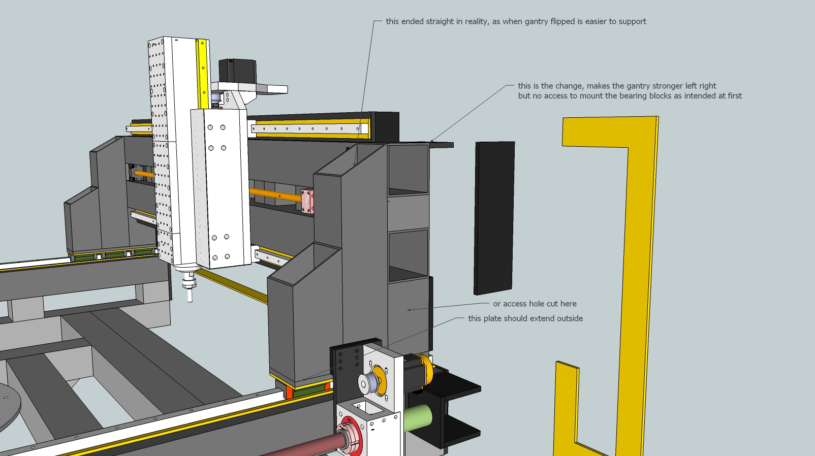

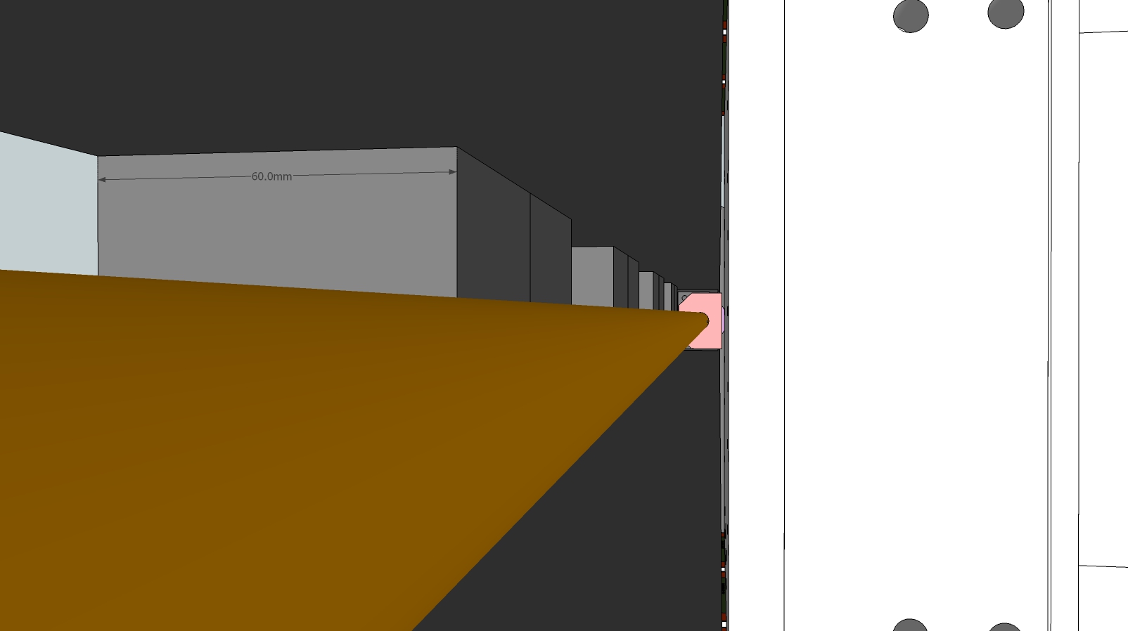

    Ignore the double ball screw, i will mount at least once a vibrating hammer so that's why. Same goes with the triple bearing blocks. 2 are enough. The 2 square bars on the Z plate can easily be substituted by structure of 20mm plate, but i don't have the time to fiddle with it so i will use solid alu bars.
    Today just soldered many things. Still no time to update the thread, but one of the things i most like about this design are the gantry legs, save some money on plates, cutting and welding. Cheap profile i mean instead of laser cut plates. As i changed some bits of the design, the gantry legs will have a plate below slightly larger or access hole for mounting the bearing blocks. But i wanted it strong left right, that's the change from the initial plan. look below:

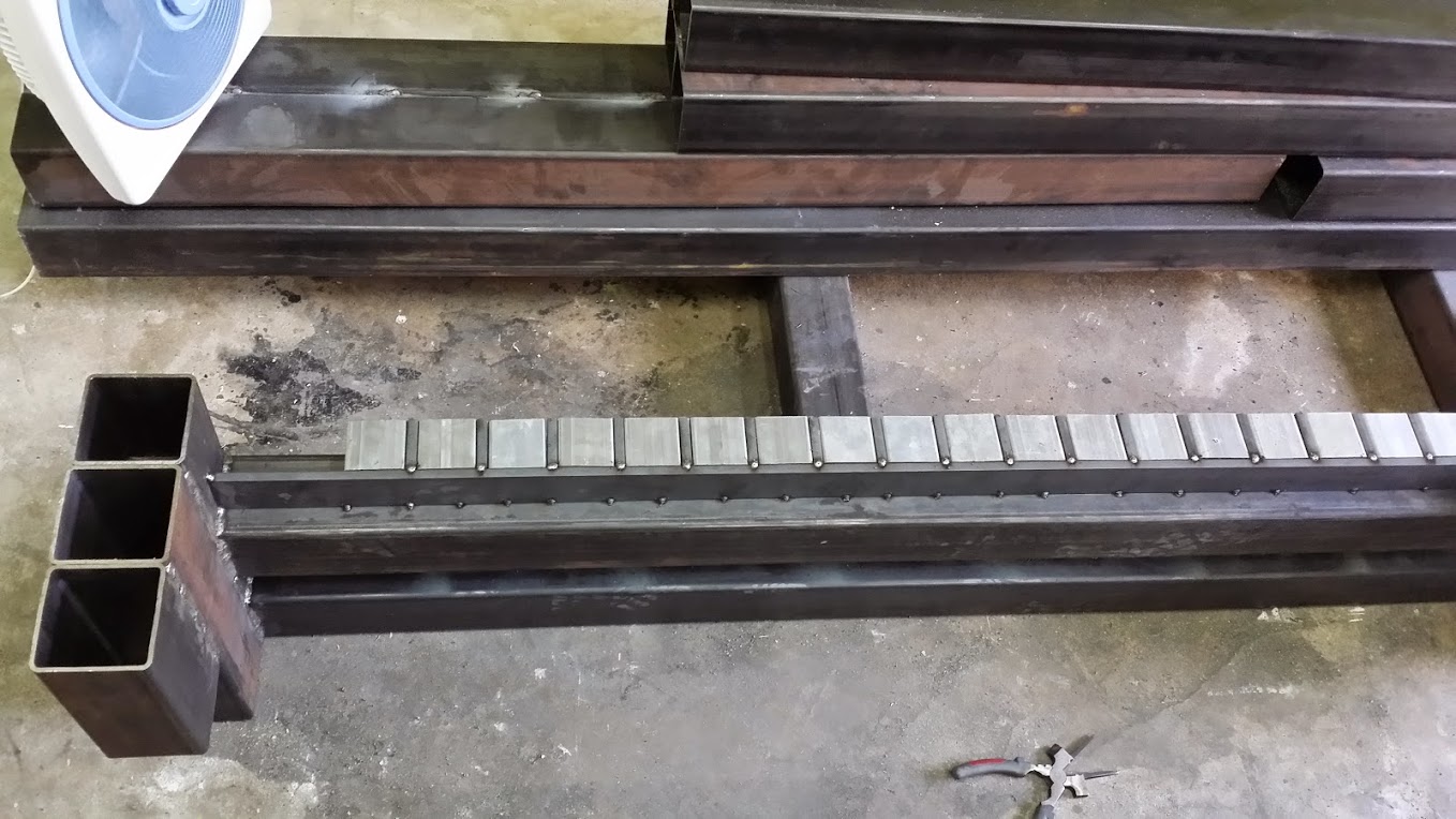

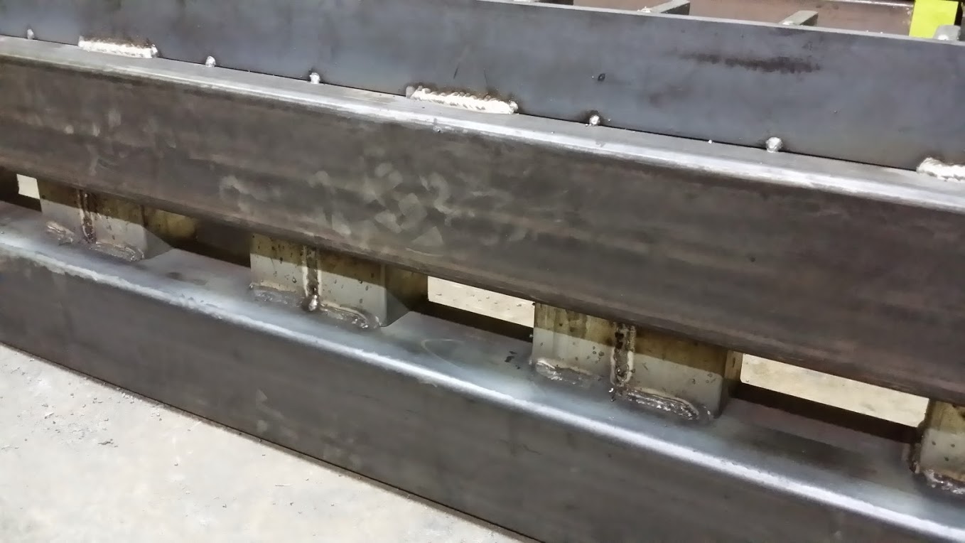

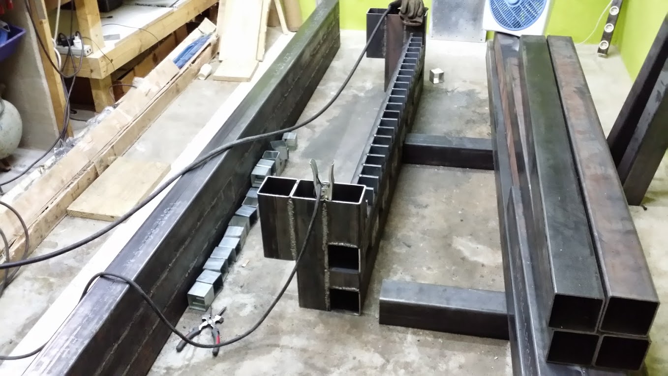

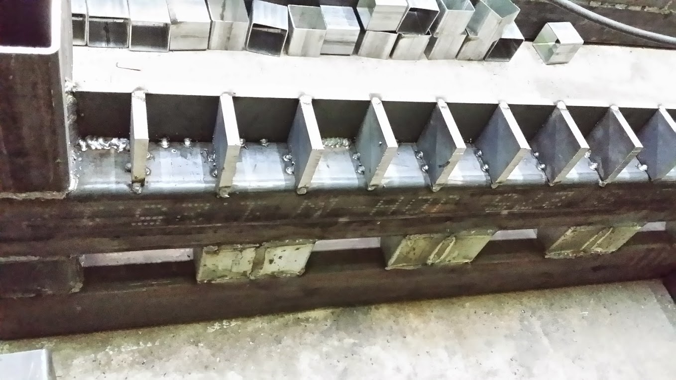

    if speaking about the gantry, today while soldering changed the idea. As it was impossible to weld it well from all sides. So did not use the square tubing for support. Just made more ribs. Anyway i have bought 6m for the 2 plates, so i had enough of it. Instead used the square tube pieces/60x60/ to align the ribs. Its ridiculously strong. the gantry i mean. but the welding goes ridiculously slow. Great care should be taken. First spot weld, then short passes, then wait, then short passes... Still have to finish it tomorrow.

    Thanks for the photo's Sylafski. VERY nice!! That gantry looks extremely solid.
