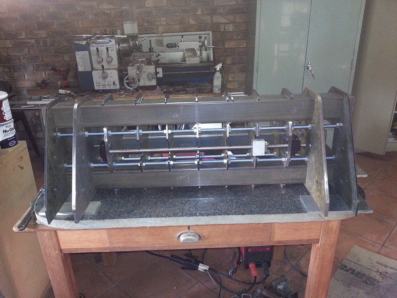

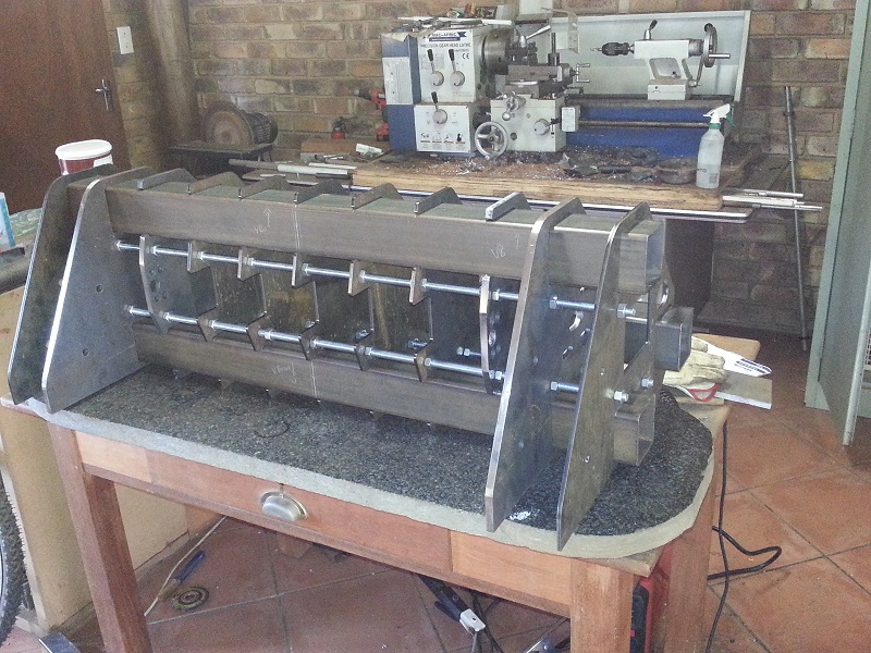

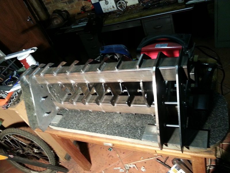

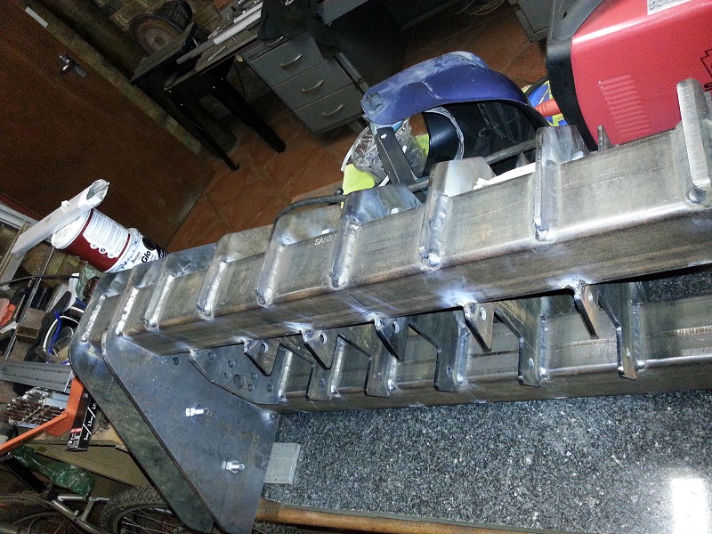

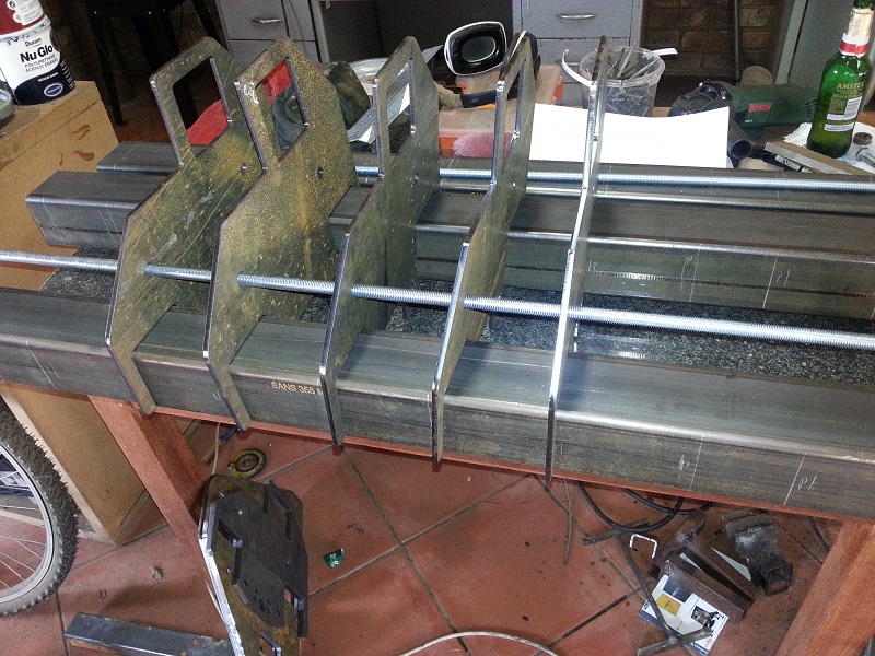

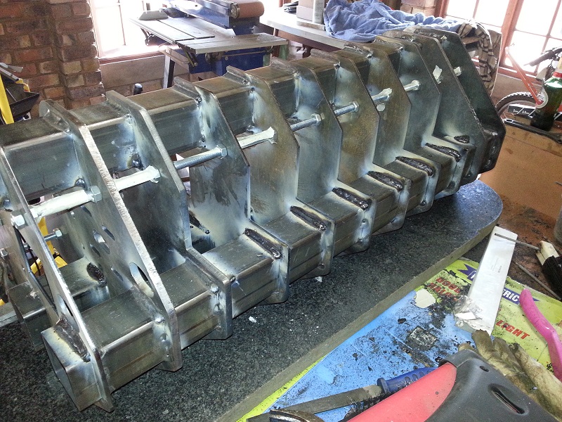

    Anyway, here's a few pictures of the gantry build. Took 3 full days to assemble and weld. I certainly know my little red arc welder much better now
    Setting it up was relatively easy but took a lot of effort. Think 4x1m threaded rods + 88xnuts and you'll get the picture.
    setup and squared.
    test fit ballskrew before welding
    Weld, weld, weld, weld... Remove flux, turn over, weld, weld weld...
    Welding done apart from the 2 base plates which can only be done later. Very relieved it turned out pretty straight and no twist.
    Would I recommend this approach for other first time builders? Well, if you are the kind of person that would describe three days of Chinese water torture as an interesting experience, then this is definitely the design you should go for...
    Have to say its an amazing feeling to see the drawings turn into reality!
