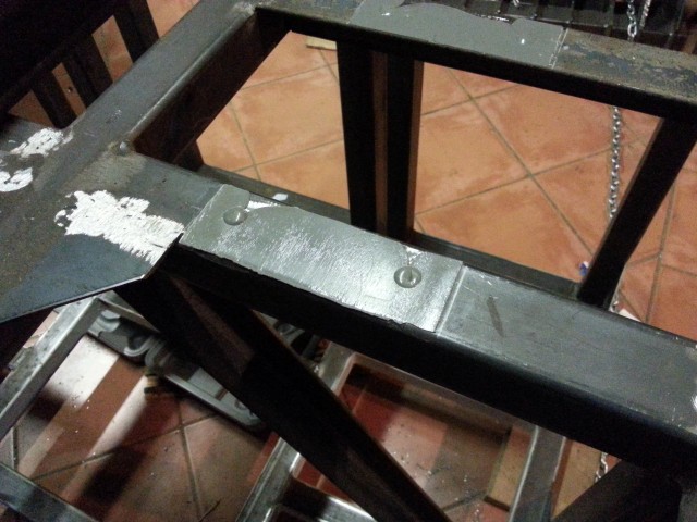

    @Jazz

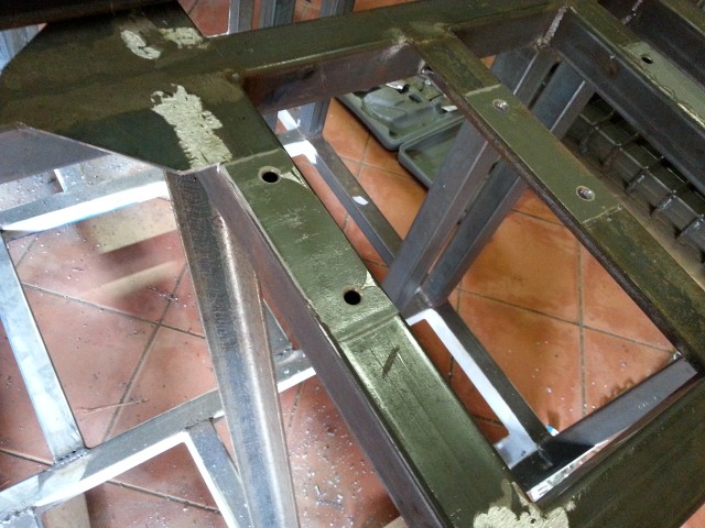

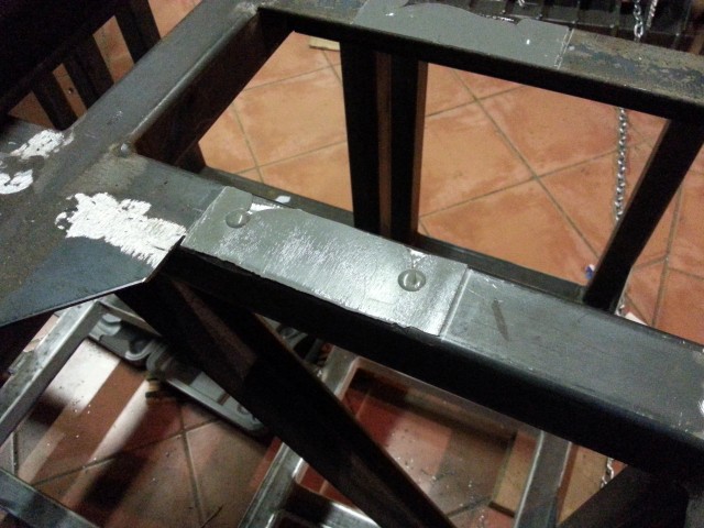

    Thanks for the cling film plan, it works great and is a lot less effort than the release agent. Yesterday I was mating the surfaces where my x sides bolts to my frame and I already laid down the epoxy when I realised I don't have enough cling wrap left and had to make a plan in a hurry so I ripped a page out of a magazine that was lying there. That glossy paper worked remarkably well. The paper obviously stuck to the epoxy side but I removed it with a wet cloth afterwards. Funny thing is the ink remains so you end up with an inverse print on the epoxy surface of what was on the paper.

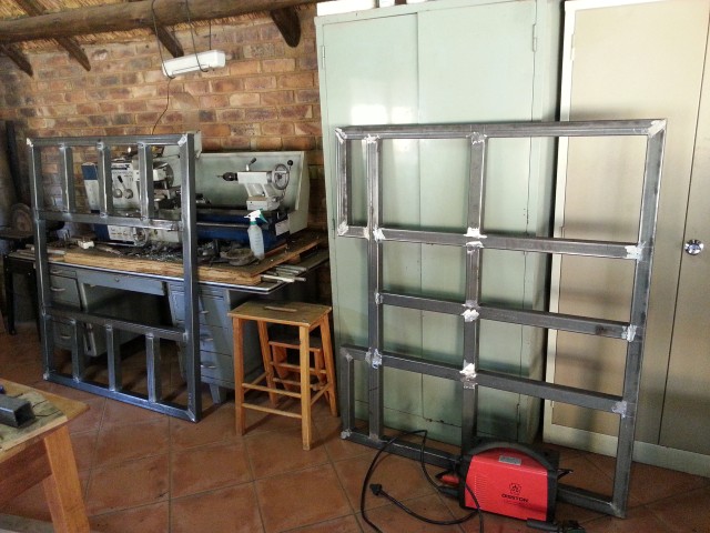

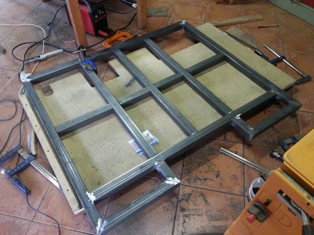

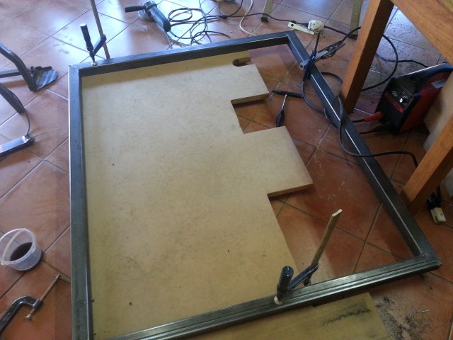

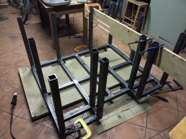

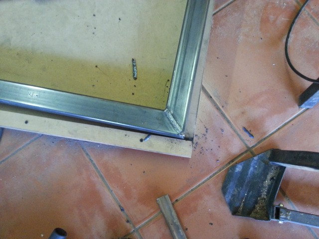

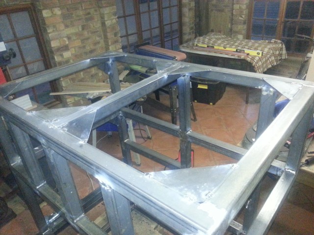

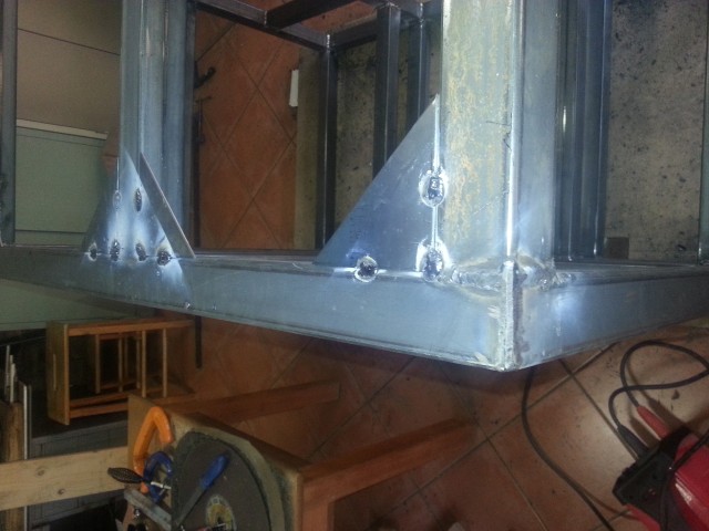

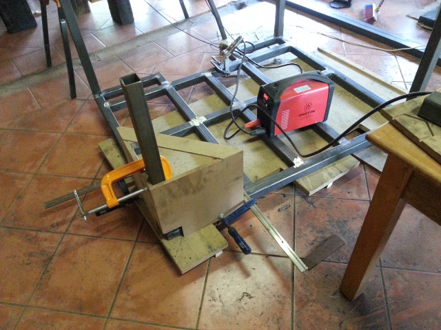

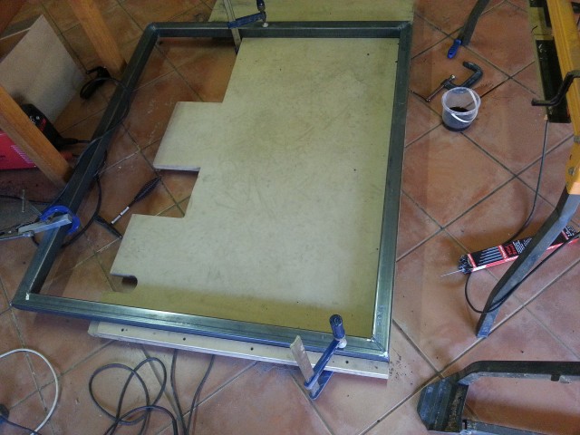

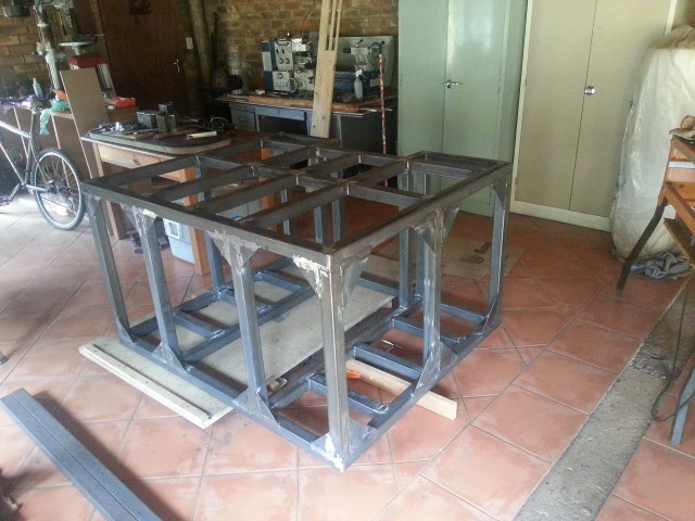

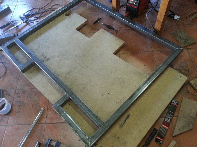

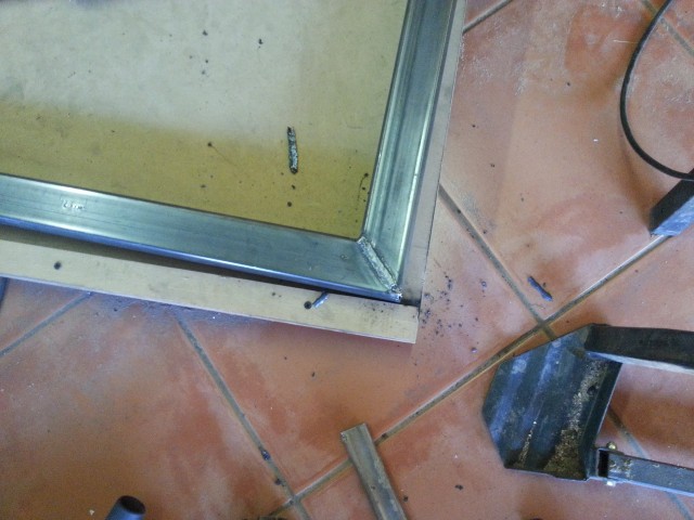

    Some progress photos. The base was done a while back. I figured its a good place to start to learning welding.
    Started with a flat work area and made a jig to get the legs square
    welded lower frame
    welded upper frame
    lower and uper frame done
    spot welded legs into place using the jig
    welded in braces after the top and bottom frames were welded to the legs.
    basically done apart for some diagonals

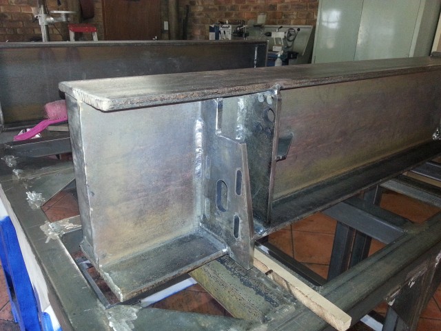

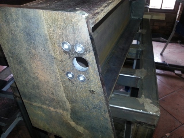

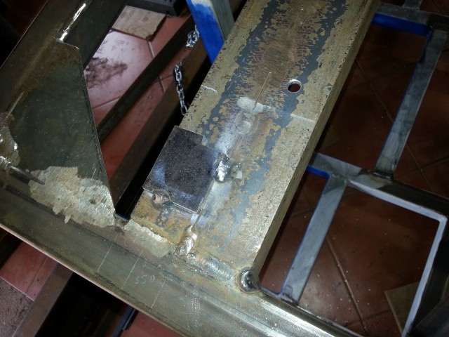

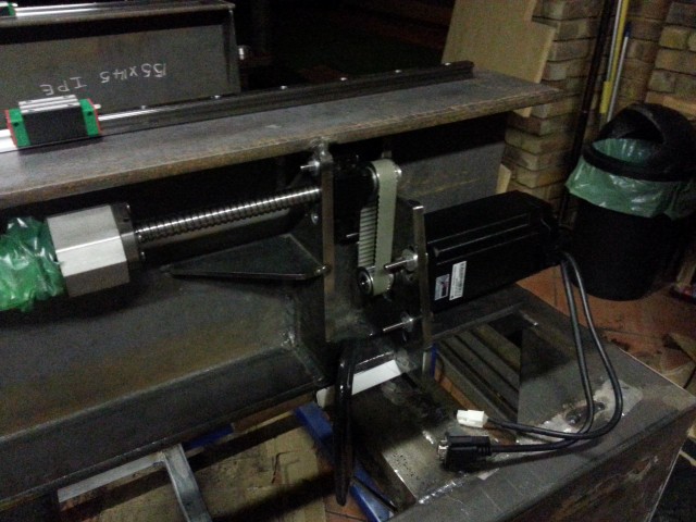

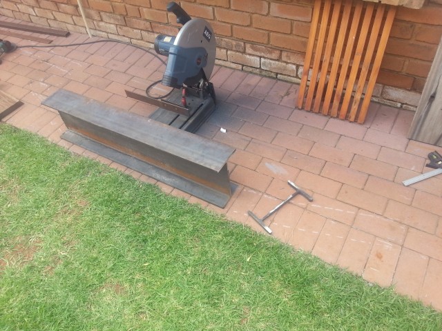

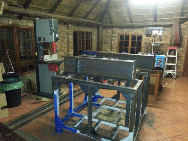

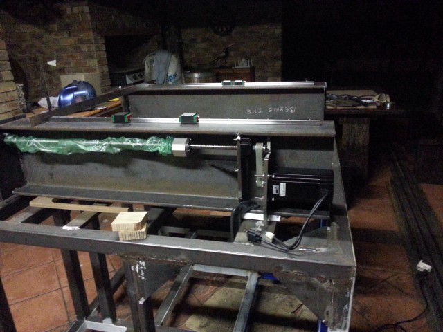

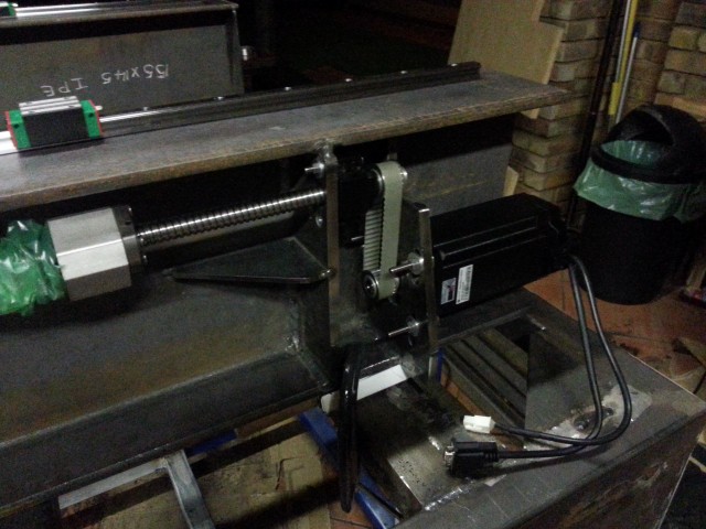

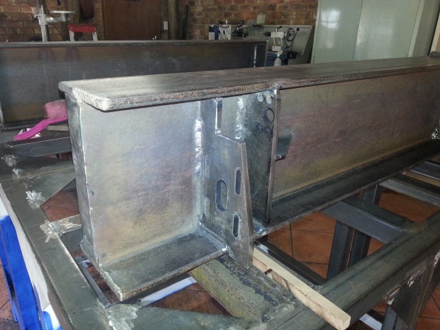

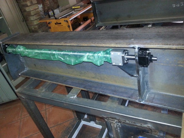

    Building the x sides with I-Beam and laser cut parts.
    Cutting the i-beam. Thought this was going to be a huge issue because the beam I got is much larger than my cut-off saws capacity but it was done a few minutes later using two cuts and the angle grinder for the remaining bit in the middle.
    I got all the holes lasered way oversize and made alu inserts for them. Just figured its a lot easier to ream alu bushes should I need some adjustment later to align things
    welded in ball skrew mounts
    welded in motor mount
    some test fitting just to see how these parts goes together
    I think using i-beam for the sides were a good plan and really easy to assemble and I can recommend this kind of approach for other newbies.

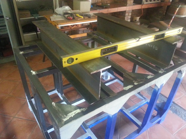

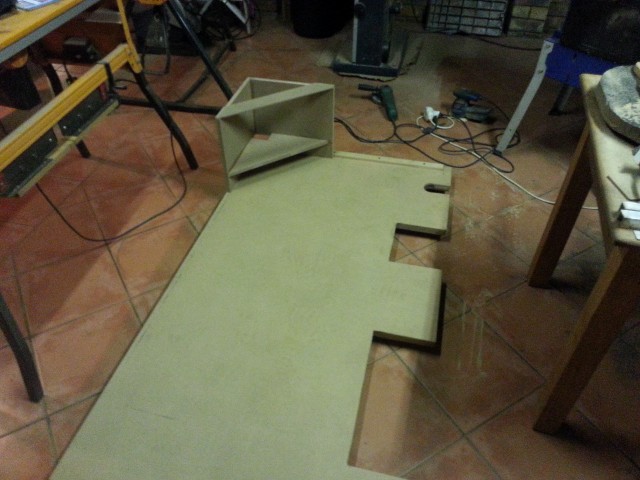

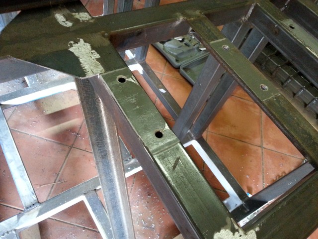

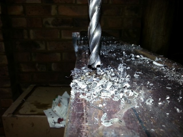

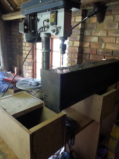

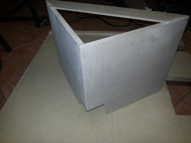

    More work on the x sides. Drilling large dia holes by hand in the thick I-beam turned out to be a mission so I made two mdf boxes and drilled it on my small bench drill.

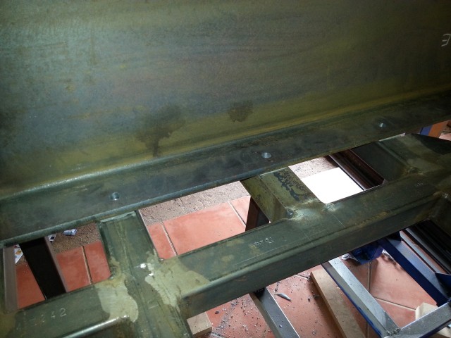

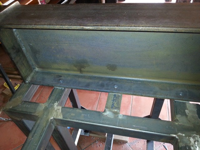

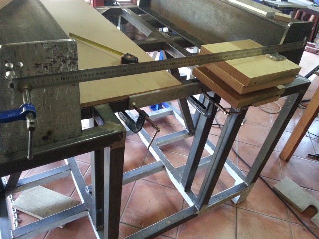

    For basic alignment of the x-sides I used the centres of by ball skrew mounts
    Once aligned I welded in tabs to make re-alignment easy
    Used steel epoxy putty as per Jazz's suggestion for shimming. Worked like a dream. I can't imaging doing a steel home build without this stuff as there's just no way a beginner is going to weld something of this scale together and end up with perfectly square mated surfaces.
    x sides almost done.
