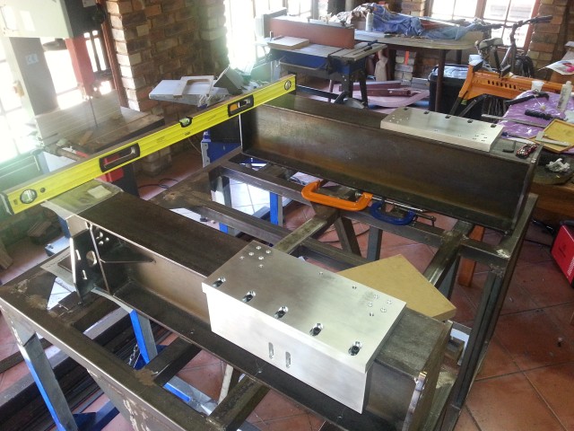

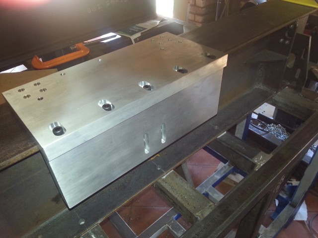

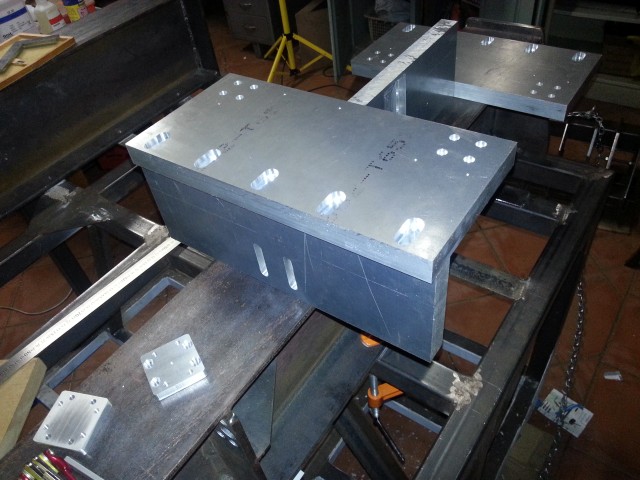

    Completed the alu base plates that joins the gantry to the x rails. I've made the plates adjustable in both y and z direction so I don't have issues putting it all together later. Had the spacing of the ball nut mount wrong on my cad drawing so I had to make little adapter plates and pockets.
    Ran a belt sander with 80 grit belt over the alu which did give it a rather rather nice brushed kind of finish.
    Done and all holes drilled and tapped. Thought these we going take a few hours but ended up more than a days work
    Like most of my parts the actual size of these surprised me when seeing them in the flesh and I probably could have gotten away with much thinner material?

    A few more pics of progress on X.
    Went with the Silyavski 8mm epoxy dams.
    Thought I'd cast a T shape on my base to eventually use as reference to do initial setup of the gantry and Z. Things got out of hand as per usual and I had spare epoxy and did the whole base. Used modeling clay for the dams. VERY bad plan, don't do it. It works nicely to build the the dams but its a total bitc$%$ to remove the later.
    base done
    I made a little tent using a blanket and plastic sheet and stuck a little fan heater under there to get the temp up to about 50degC for proper post curing. You guys in the cold places might find that handy.
    X sides painted light gray. The base is just white primer and is not going to be painted as it will be fully enclosed anyway.
    X epoxy done and fully cured.
