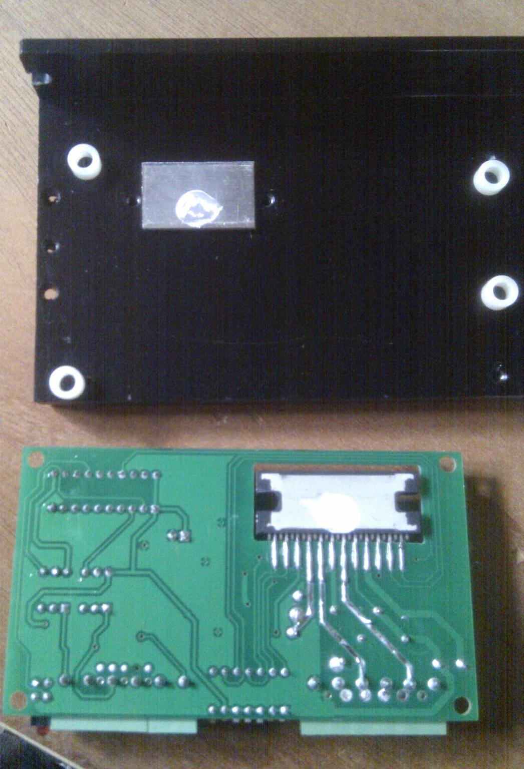

    2 new drivers arrived today. Everything now appears to be working. I took one of the dodgy ones apart and the heatsinking was poor - blob of paste covering about 25% of the surface area. A nicely ground bit of aluminium plate between chip and heatink, but it had been chopped leaving a burr which lifts the end!
    Before I do any sustained work, I think I will take my good ones apart and ensure a good heatsink connection.
    Also spotted one very poor solder connection, so there is a posiibility of fixing the bad ones.
    I did take the goods ones apart, and made sure the heatsinking was good. The 2 replacements, and the one original that worked had smaller (but flatter) heat sink pads than the faulty ones. Indicating that the design is at least evolving! The pad edges still needed a clean up though, and the paste was still only 20% coverage.

    So what was causing the faults / resets when jogging from the keyboard ? did you change the breakout board ?
  4. #34
    2x faulty Tongka M542 drivers. It would appear that the original BOB is OK.

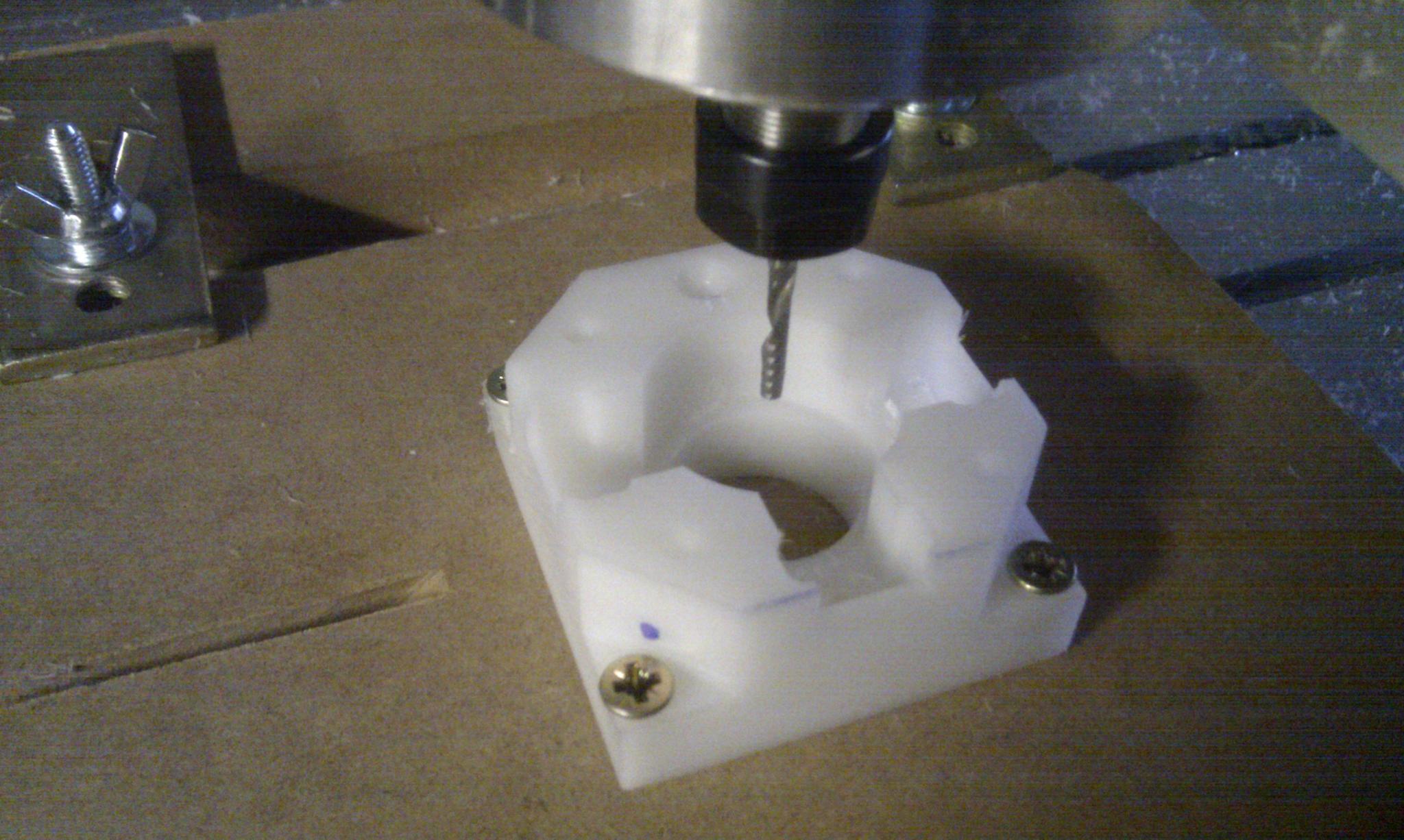

    Somewhat risky for a newb like me to have metal screws in the work area, but I took a chance. All went well until I hit the z-axis limit switches (piss poor planning) in the middle of my job. In the confusion I did the same as before, started the job mid program but I'd done a goto zero. I should have noticed it was heading off inthe wrong direction but I wasn't ready ready to pounce onthe stop button.
    The tool scored a direct hit on a holding down screw.
    Hopefull no damage to my spindle.Click image for larger version.
ID:	13240Click image for larger version.
    All seemed to be going well but I've got one concern. The third pocket, is undersized slightly eg 13.85mm instead of 14.0mm in the long axis direction. Does that indicate missed steps?
    I ran it again at 70% feed and another sliver got taken off one face, so now 0.10mm undersize rather than 0.15mm.
