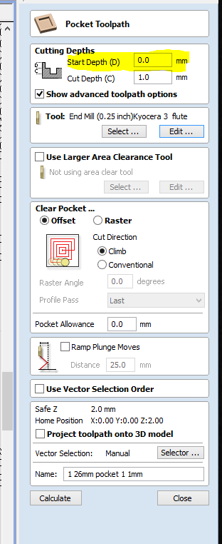

    On my version its on the right hand side under Toolpath operations (setup material and rapid gaps) set your Z to the top and Gap above model to zero. ..Clive
    Ok, Material setup screen on RHS reads as follows....
    Material Z Zero, red spot top left corner. Thickness 13mm.
    XY Datum centre spot selected. No Use offset" ticked.
    Rapid gaps above material
    Z1 45mm (Need to clear a clamp) Clearance
    Z2 4.8mm (Plunge)
    The preview shows the cut ass I would expect.... about 4mm into the work surface
    I'm thnking I've set something wrong here...
    Will post the actual file from the machine tomorrow into this thread somewhere... I'll open it in Notepad and see if I can see what's gorn awry too

    Check this:

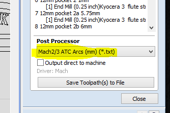

    The post processor is this inch or mm with or without the ATC/adds tool change command/ and the out put is txt in both cases, not .nc

    Thanks Jazz, I actually believe it's me getting it wrong tho... I only have the facility for XY offset in V Carve,
    I wonder if plain G Code in txt will work, even though the PP program suggests .nc extension... Not sure why there is a difference....

    Hi Silyavski,
    My PP file extension needs to be .nc according to the instructions. Not sure if it will accept metric .txt, but I may try.
    I'm setting the machine toolpath in "Profile Toolpath"...Do you think I should be using the "Pocket toolpath" instead ? The setings in your picture are the same as the ones I my program too,
    My intention is to cut 4mm MDF/Ply on a sacrificial backing board to allow the cutouts to be used/pushed out then finished after for sale... Items like hearts, stars, letters and numbers etc
    If you can't fix it with a hammer you've got an electrical problem !
  9. #19
    Sorry , i though you use mach3. Though you can just rename the file.
    Looks like I'll be installing Mach3 and getting someone clever in to convert the machine board otherwise
    The file .nc extension will open in notepad. When you click it to open and get the message saying choose software to open with then use notepad and save as default for this file type.
    If you create file in note pad then just replace .txt with .nc and it will work. Both are just plain txt files the .nc extension is nothing special it's just the DSP will be looking for .Nc extension. Chances are it will use .txt as well and just defaults to .nc.?
