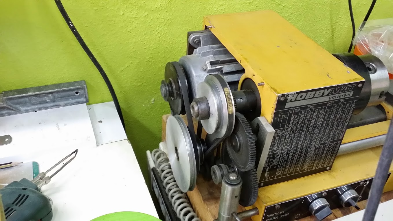

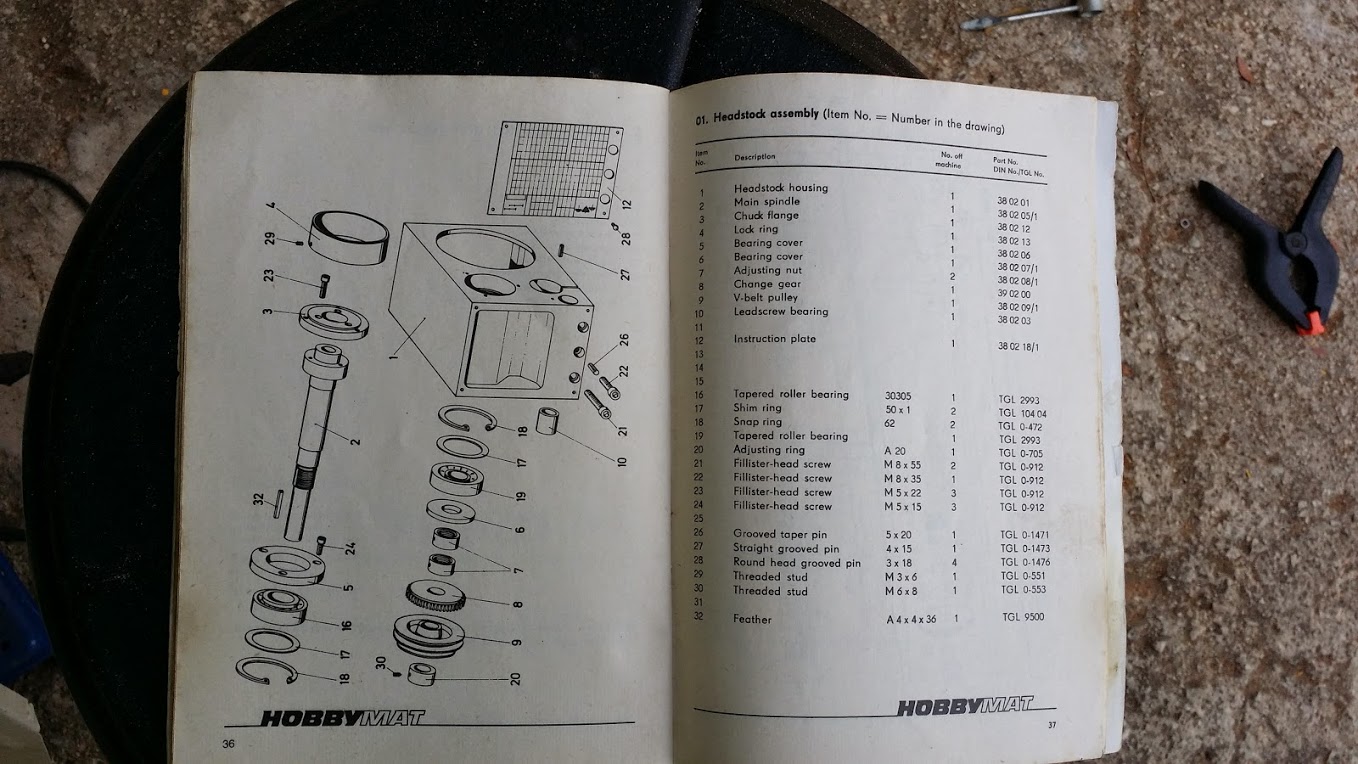

    Here is the lathe, it seems obvious enough what to do. Have to disassemble all and take measures of the shafts and pulleys that will need.

    I assume the correct motor will be 400w, will have to make some calcs and if 1 or 2 pulley. The original motor is 250w.
    I assume the final ratio should be something like 1:6 to 1:9 . I am a bit lost here as this is my first lathe and still haven't had the time to go deeper in lathe jobs. and what speeds i need for what.
    I assume the holding torque of the servo works just like the power, so if geared enough the force will multiply.
    Have seen very cheap taper roller bearings on eBay + the housing is aluminum, so heat will not be e problem even if rarely i need to spin it faster.
