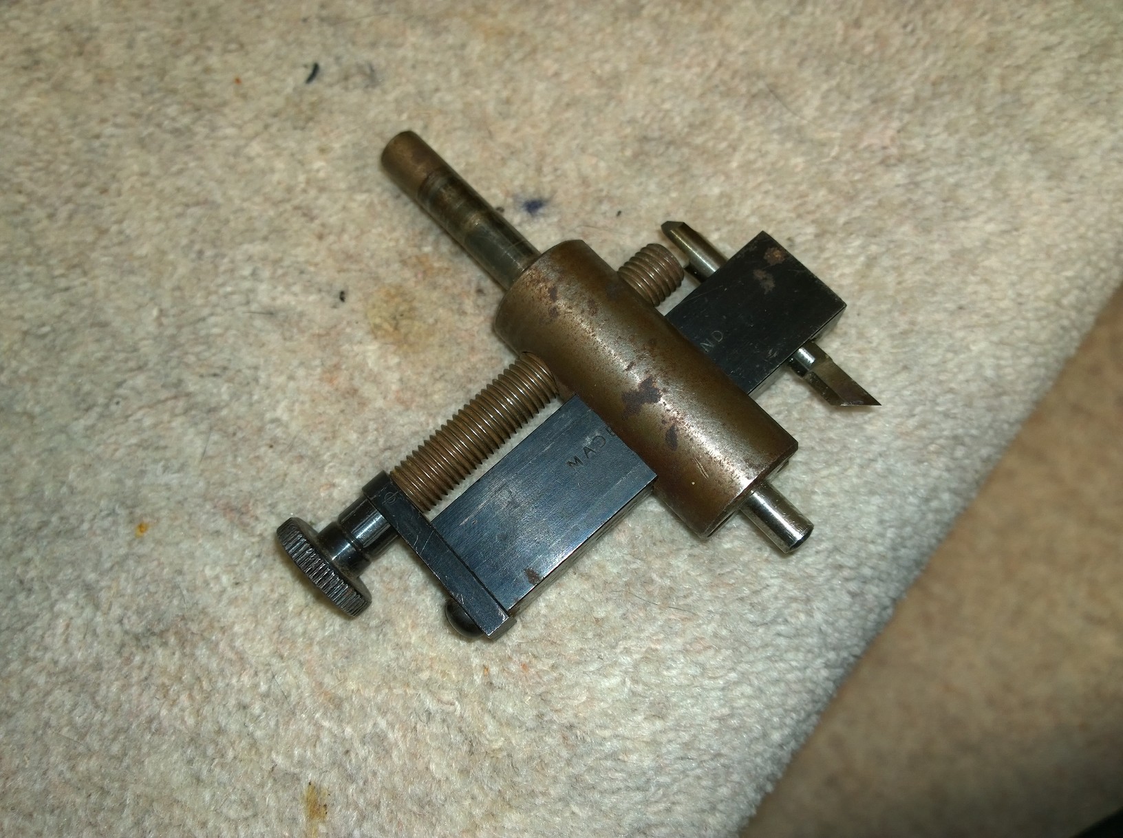

Depending on what you plan to do with the machine, you might choose to ditch this lot and start again. But I wouldn't! That's a great set of starter tooling. Use the Autolock chuck with the screwed shank endmills, with the ER32 as backup if you get any metric shank cutters (assuming that the Autolock is imperial) or plain shank cutters. ER32 is also useful for larger drills that don't fit the drill chuck. I use ER32 for all my cutters (including screwed shank) as I don't have an Autolock but the latter gives a better grip on the cutter. Facemill - useful for cleaning up faces, obviously, and covers a much wider surface than any normal endmill. I've added a boring head for accurate hole-making. After that, you'll be thinking about work-holding - machine vice, clamping studs, t-nuts, etc, but maybe those were part of the deal. 3 axis DRO as well - that's a pretty useful set of kit you've got there.

Well I plan to cut aluminium and steel - Mainly to make parts for a new diy cnc - I can see a boring head would be used a lot. I know there is a boring head with a lot of cutters in one of boxes of bits but I haven't checked it out yet.
