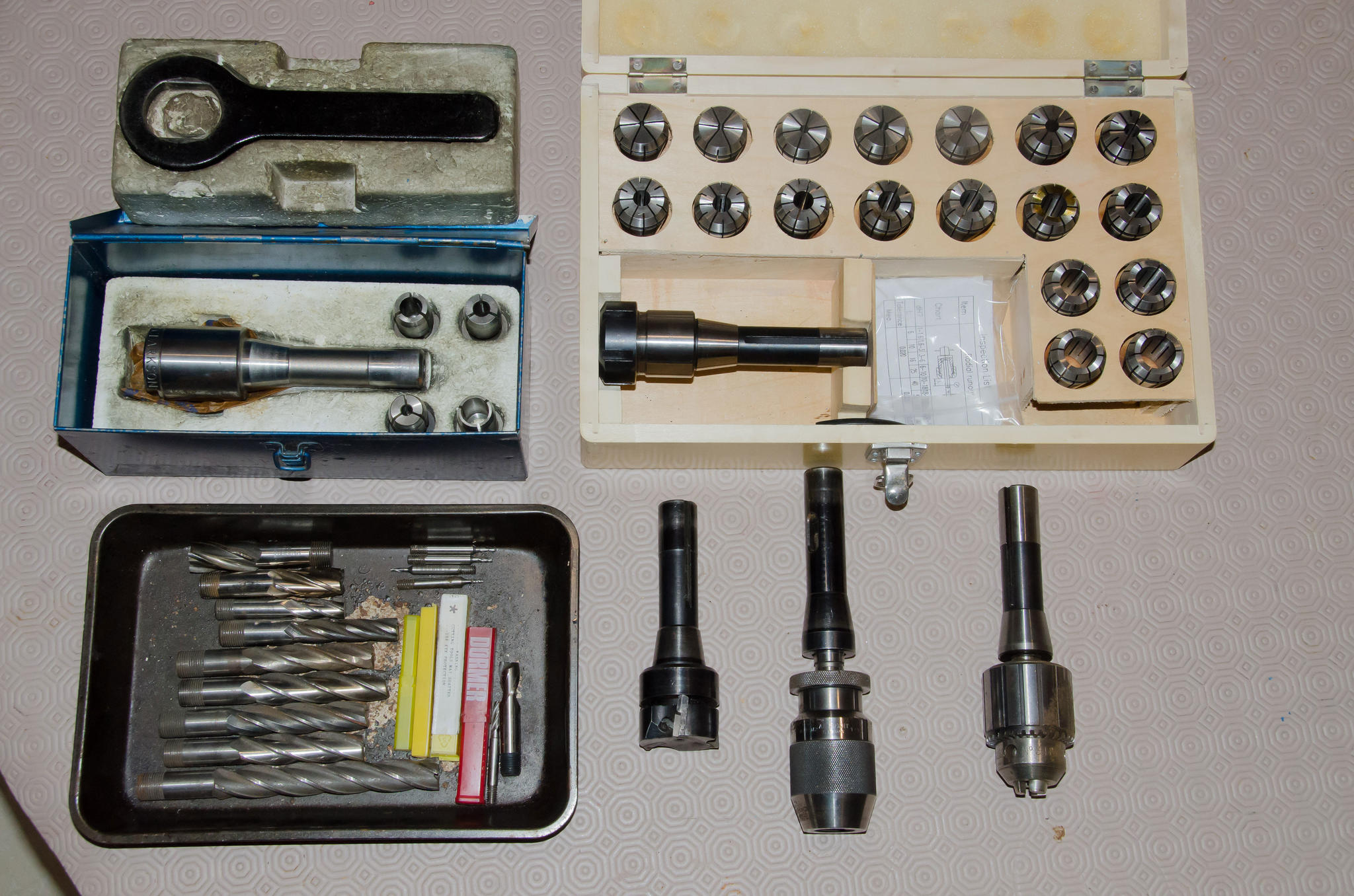

    Hi everyone,
    I have just picked up up a Myford VMC and am trying to get me head around how to use it and the different tooling (and terminology!) that came with it.
    I have worked out that the machine has a R8 taper and it came with a few different tool holding parts.
    The picture shows the following:-
    Clarkson Autolock Chuck (and a load of end mills to fit)
    ER32 Chuck and collets
    A face mill
    An Albrecht drill chuck (in a R8 adapter)
    A Jacobs Drill Chuck
    So my question is is any of these worth keeping or would I be better selling them and buying something else? The ER32 set looks like it would be very useful but the Clarkson autolock chuck already had a load of end mills with it (more not pictured). I guess I cant use the threaded end mills with the ER chuck?
    Not sure if the drill chucks are worthwhile as I have a pillar drill? Or I guess the mill would be more accurate (Mill also has 3 axis DRO's).
    Any advice to this novice would be most welcome!

    Depending on what you plan to do with the machine, you might choose to ditch this lot and start again. But I wouldn't! That's a great set of starter tooling. Use the Autolock chuck with the screwed shank endmills, with the ER32 as backup if you get any metric shank cutters (assuming that the Autolock is imperial) or plain shank cutters. ER32 is also useful for larger drills that don't fit the drill chuck. I use ER32 for all my cutters (including screwed shank) as I don't have an Autolock but the latter gives a better grip on the cutter. Facemill - useful for cleaning up faces, obviously, and covers a much wider surface than any normal endmill. I've added a boring head for accurate hole-making. After that, you'll be thinking about work-holding - machine vice, clamping studs, t-nuts, etc, but maybe those were part of the deal. 3 axis DRO as well - that's a pretty useful set of kit you've got there.

    Interesting that you have used the threaded end mills with the ER chuck. Have you had any problem with this? I imagine you need to make sure that the collet has enough non-threaded section to grip?

    Even threaded shank cutters have enough plain section for a collet to grip - haven't had a problem (although most of my cutters are plain shank anyway).

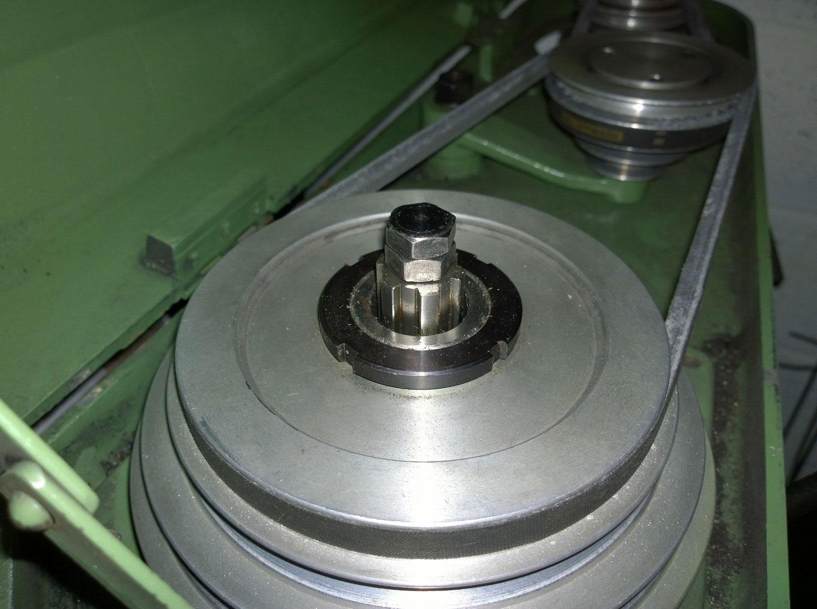

    Yes that is what I had to do to release a cutter that was already in the autolock - It was VERY difficult though (took far longer than it should have), could not for the life of me get a good grip on the pulley. Maybe I will get use to it but I think I will try and come up with a easier solution. Maybe I could make a tool to slip over the "cog" part (or maybe one already exists?).

    To unlock a tool, I would hold the spanner in place on the chuck nose and give it a tap with a rubber mallet. The inertia of the drive system means that most of the shock goes into undoing the locking part. Helps if you put the machine in lowest speed as well. Hopefully that's the last time you will need shock tactics, though!

    Good tip! I suppose the other consideration is tightening the tool...

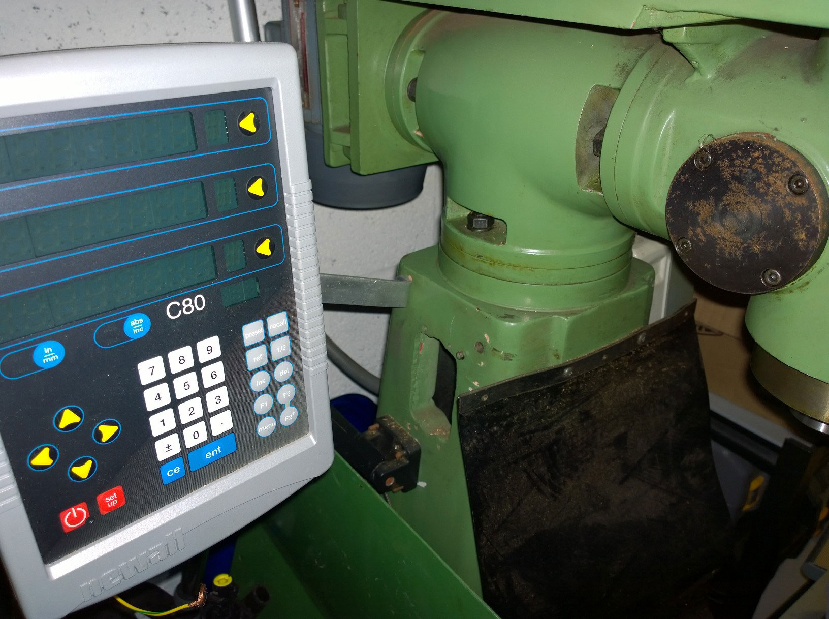

    I don't suppose you know what is missing from the side of the mill do you? Does your Warco have a similar hole on the side?

    Congrats on your new purchase you have a good selection of kit with it and i couldn't see you needing much more, only disadvantage of using ER32 is the posibility of the tool coming loose and marring the collet, the Clarkson tightens the cutter hard into the rear centre so is not an issue, but i am not fortunate enough to have anything so exotic and it seems to work for Neale.

    It worried me a bit at first, Mike, as my previous mill had an Autolock-style holder. That was on a 2MT shank, though, so not so useful with an R8 spindle (and having used both, I would have R8 over MT anyday). I haven't done any really heavy cutting, but no problems so far. It does mean that I'm not restricted to screwed shank cutters. I mainly use imperial size cutters and I only have metric ER32 collets, but they seem to grip OK. I have wondered about buying a few specific imperial collets to suit my cutters, just to minimise the closure of the collet and get maximum grip. I could imagine that the Autolock would be better for CNC work, where you might want to change cutters and go back to a known Z height setting; CNC conversion is on the plan but still a fair way off for me!
    Not sure about the hole in the side. Might have been for some kind of switch box? Access to internal wiring? My machine has a removable panel on the back. The Warco version actually has a couple of 1" or so holes at that point, one each side, so that you can stick a bar through to take lifting strops.
    DRO appears to be Newall - decent make, hope you can find a manual for it. It has the 1/2 button for finding mid-lines, so you're in luck there!

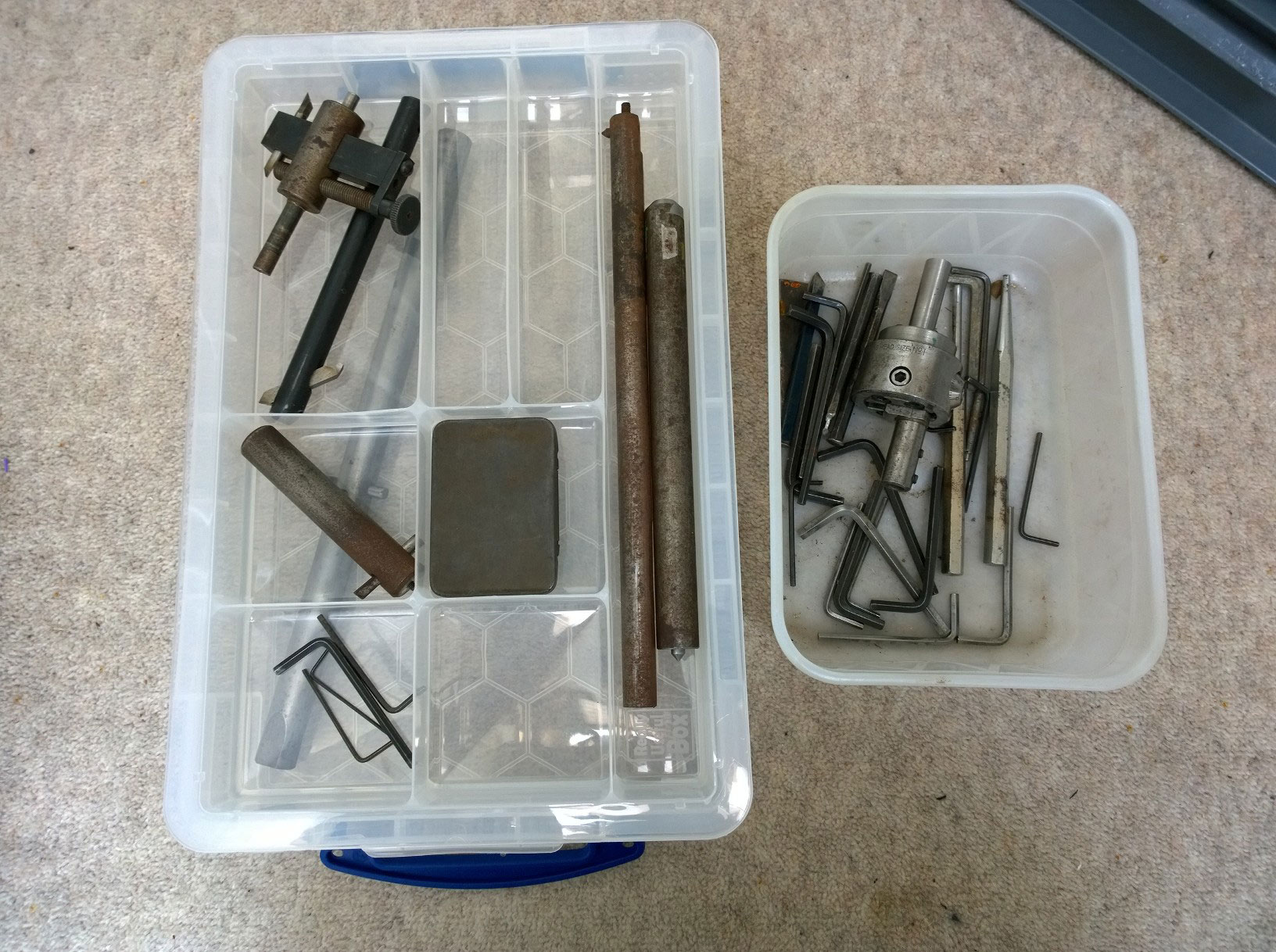

    This is the latest find - a boring head and a number of different types of homemade looking boring tools (I think!). I guess the longer ones would be more useful on the lathe?

    Hmmm it is odd - There is a control box on the other side. I will investigate to see if its hiding a matching hole behind it. I think I will make a plate to cover it, maybe attach a flexible light to it.
    Dead easy to find the manual for the DRO - Good spot on the 1/2 button!
