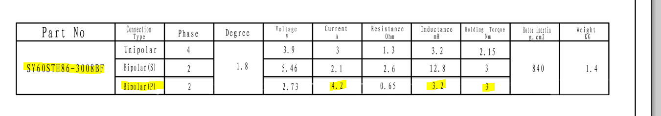

    i know that name 23's is better specially for gear reduction for high speed iam looking for without loosing torque but available name23 has high inductance 6mh which mean require 78V PS and the biggest available PS is 60V only
    Nema 34 has 3.4mh which mean more appropriate for 60V PS

    The motor you point to is not a very low inductance motor. You need similar as what Zappautomation sells:
