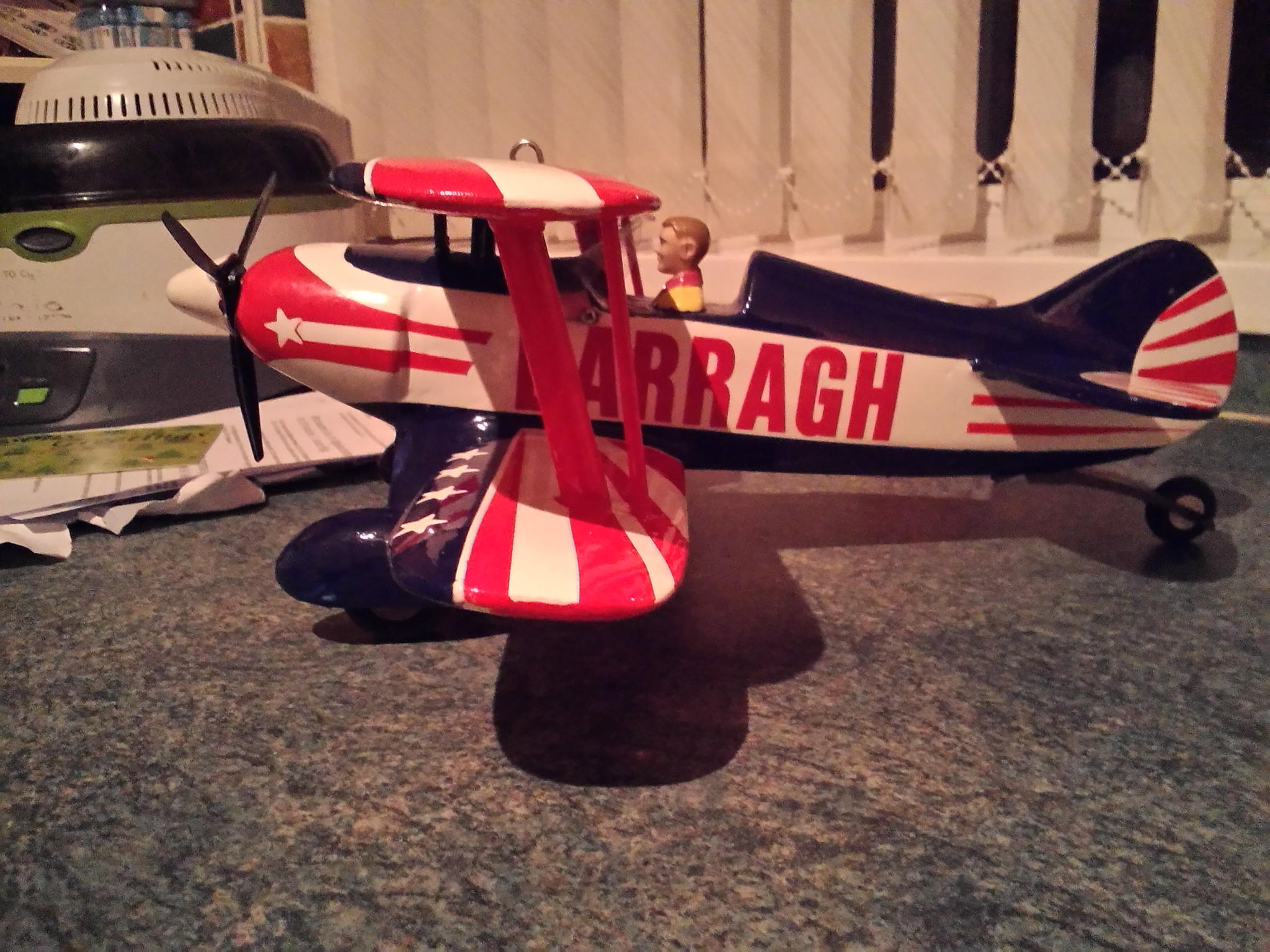

    I usually make my models with whitewood pretty cheap wood you can find anywhere,I want to make more intricate stuff with more detail,also I want to learn a new skill this winter so im excited about getting the machineClick image for larger version.

ID:	13364it Will be a learning experience !here's a Pitts special I hand built for my son Darragh last Christmas:-)
    Nice little plane, have you thought about you are going to cut the parts on cnc ?
    Dunno,I obviously need to do symmetrical wing sections and elliptical fuselage etc,so thats where you guys come in,is it possible on a cnc machine?
    Quote Originally Posted by owen3371 View Post
    Well your machine will likely have X,Y,Z axes, so it's a 2D and 2.5D machine. 2D can be thought of as cutting shapes out a sheet of material, specifically the outlines in the X,Y axes.
    2.5D is using the Z to cut curves, pockets, etc. it's not true 3D becasue it can't undercut. To make a statue for example with undercuts you would need a 4th axis that rotates the work, having said that, it is possible to rotate the work by hand provided you have used a 3D model in your CAD software and calculated each toolpath in your CAM software as the model has been rotated.
    So taking your fuselage, you would lay it on it's side and do 2.5D cutting up to the halfway point, then turn it over and cut the other side, basically like joining two halves of an Airfix fuselage.
    So yes it's possible to make the plane with your machine if you think creatively about how to position the stock and how you calculate toolpaths in your CAM software.
