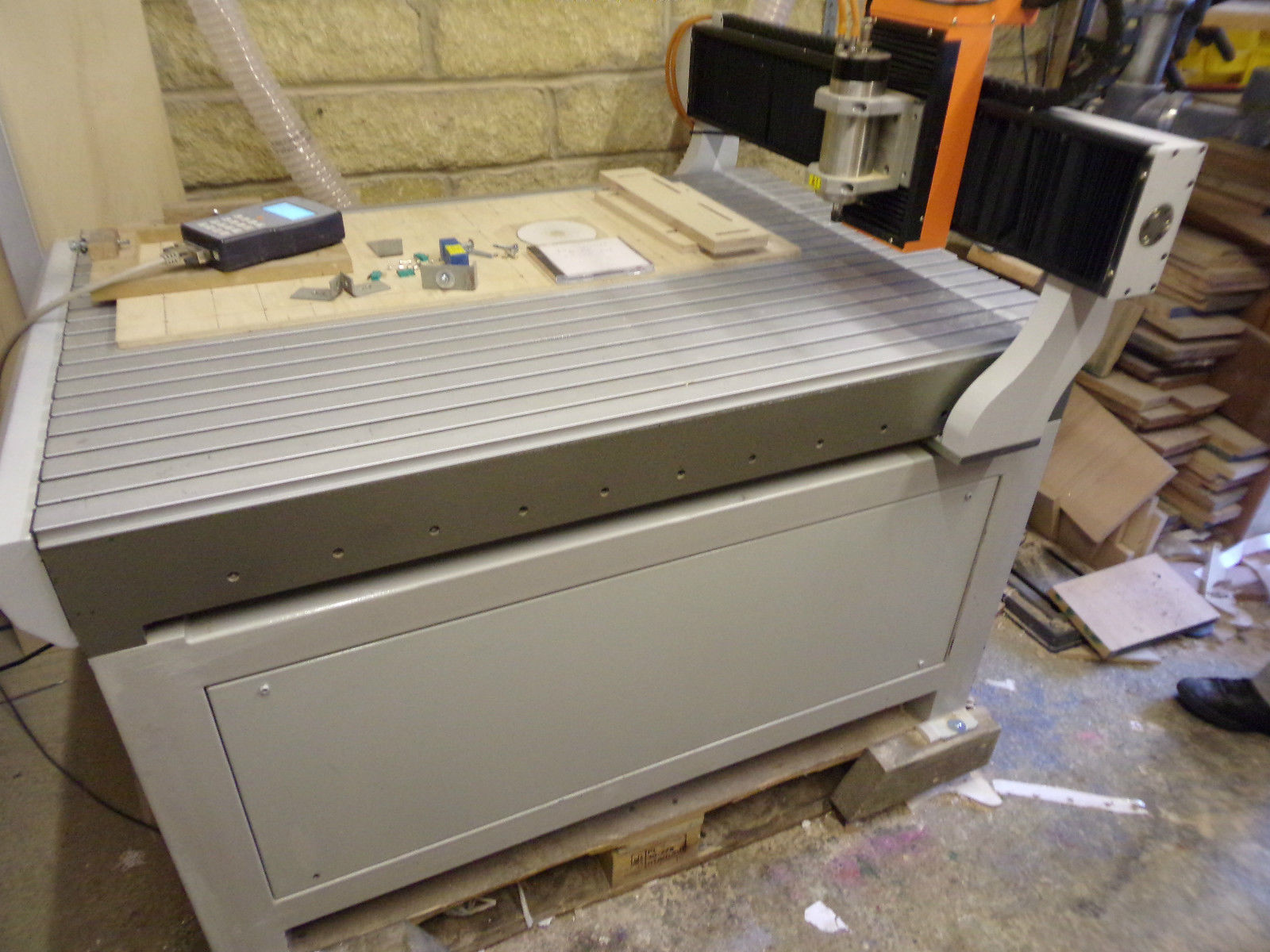

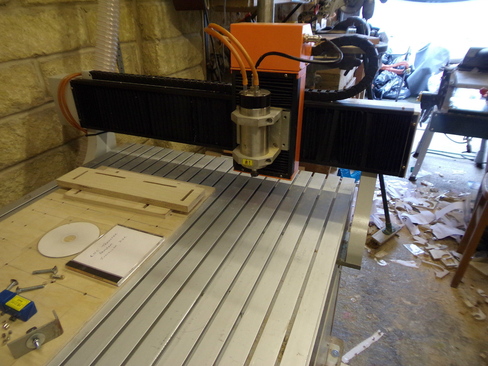

    Hi Guys,
    It's an eMach EM900 ..Yeah..I've read various reviews and understand they've gone belly up and others have had problems...But it works (I'm told) and wasn't a bad price.
    I hope you experts on here can help out occasionally as this machine is for my wife and I to start our new business.
    Here's hoping....

    Got a feeling that is a chinese import and won't have been made by Emach.
    Provided you can figure out the DSP controller and it as enough memory to take the G-code you need then you shouldn't have any trouble working it.
    How it performs will depend on what components the machine is made from and how worn, ie linear rials and ballscrews motors etc.
    Often these chinese machines are built to price so they cut corners in key areas that cost most money so chances are it uses supported round rails in place of profiled linear rails, Cheap low power analog drives and could use lead screw not ballscrews. Thou doubt it as ballscrews are cheap in china and have been for a long time.
    If there's no slop and it works for what you need then none of this matters and if there is any slop or worn out they can all be replaced easy enough.
    Often the one thing people want to change on these machines is the DSP controller. It's not unusual to see folks wanting to convert to Mach3 or Linux Cnc because the DSP controller is limiting what they can do. This is a little more involved and will require a little electronics hardware and some wiring changes but again no big deal if needed.
    Have fun watch your fingers.!

    It has an emach badge and serial number on the side, so I naturally assume it was one of theirs. 2006 model, so perhaps made before the rot set in at the factory.
    The current owner is the son of the (Late) granddad in a family "Oop Norf" in Halifax, the old boy bought it in 2007, had good service from emach at the time and used it very little. Allegedly it's had very little use overall and comes with a small selection of tooling.
    I'll know more after Sunday when I collect it and get it back for a proper look-see, although I'll be unable to actually produce anything just yet as I'm still sorting somewhere to put it and use properly.
    Having fun with the designing using V Carve trial, quite intuitive. I'm hoping it's post processor is simply G code as well.
