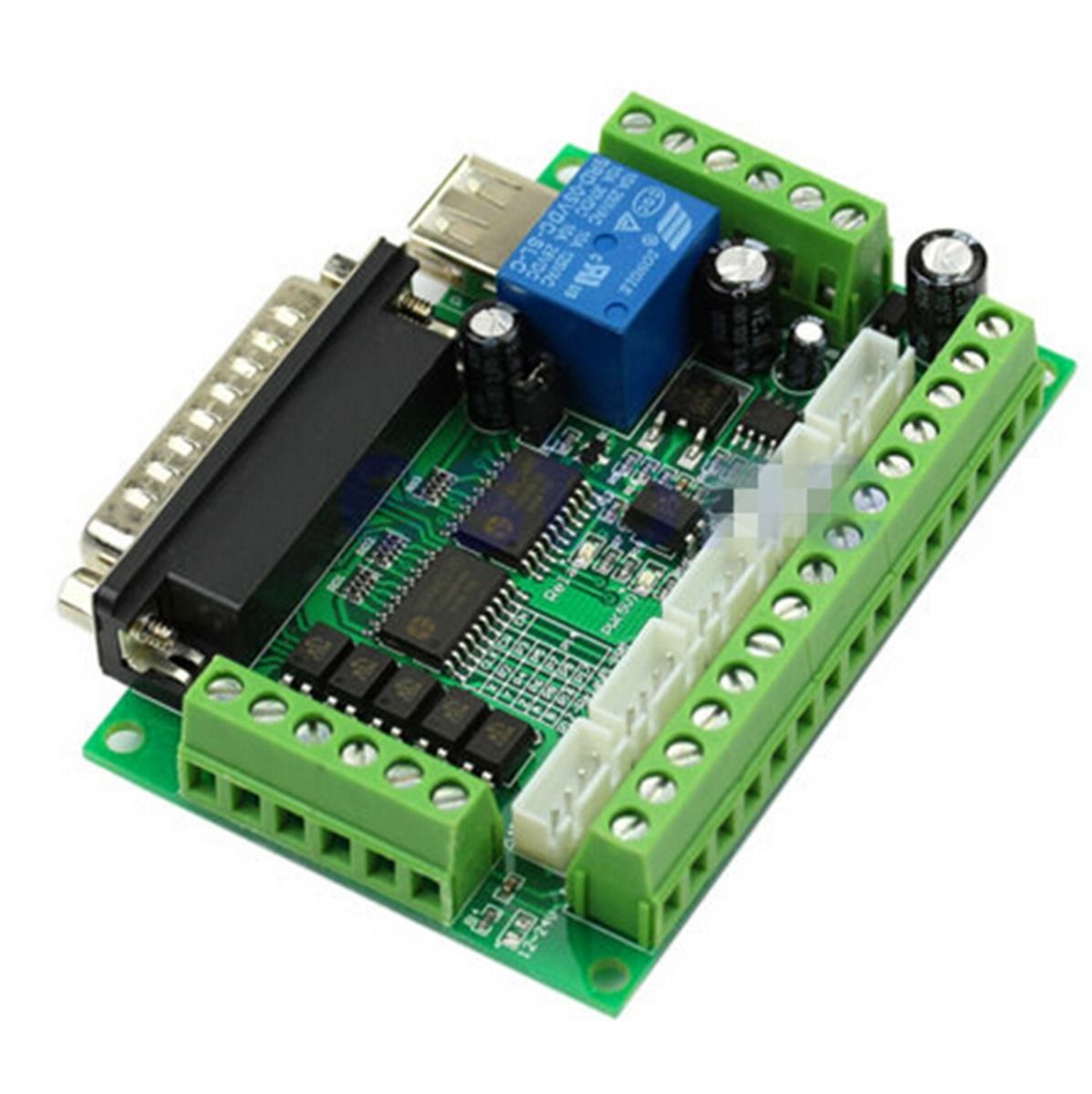

    Next problem was that on and off (mostly on) and for a prolonged period when it happens, x+ and z+ wouldn't jog after doing y+. but doing y- would make them work again. I swapped the X and Y leads at the control box, and the problem switched axes. Therefore the problem is inside the control box, either the BOB or the M542s. I will swap the M542s next and test the grounds. See if that helps or tells me more.

    I'm pretty sure I've narrowed the controller problem down to the BOB ( I knew having separate drivers would pay off :) ). Each axis works OK by itself when other are unplugged. And swapping the BOB outputs to different M542s moves the problem axes around.

    Regards the drive problems check the STep & Dir connections at the drive giving the trouble this as been a cause of trouble in the past on these machines along with shity wire quality.
    I'm not familiar with what the diffferent wires are, but the BOB has a 4pin connector for each axis. 3 of the 4 pins are used and the 4th pin has a loose wire hanging from it. The BOB looks like it has also the option of output via screw terminals, so I could cut the terminal blocks off and use those. But I'm wary of doing that before I hear from the seller, and if I get a replacement BOB Id rather just plug it in.
    The wiring all looks pretty nice to me, but I'm not an electrics person. All the sockets into the controller feel like plastic, but they are conductive, I've tested the continuity of the casing.
    Just grabbed this pic of my BOB from ebayClick image for larger version.

    Ok well I'm not a fan of those silly plugs and I'd wire to the terminals every time but your correct to wait untill seller responds.
    That said if the problem moved then it won't be the BOB and chances are it's a drive or wiring to drive.? . . Again I would check the connections at the drives.
    I moved the outputs of the BOB to different drivers. So the problem changing axis shows that the driver is not the problem as the problem follows the BOB output independent of which driver it is wired to.
