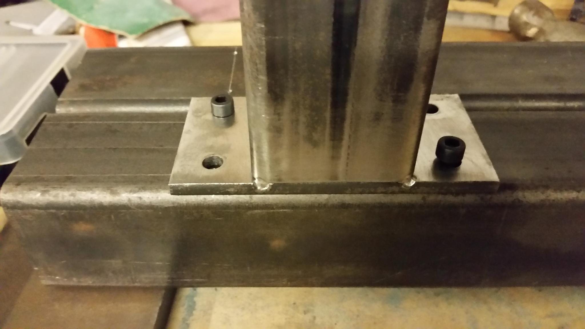

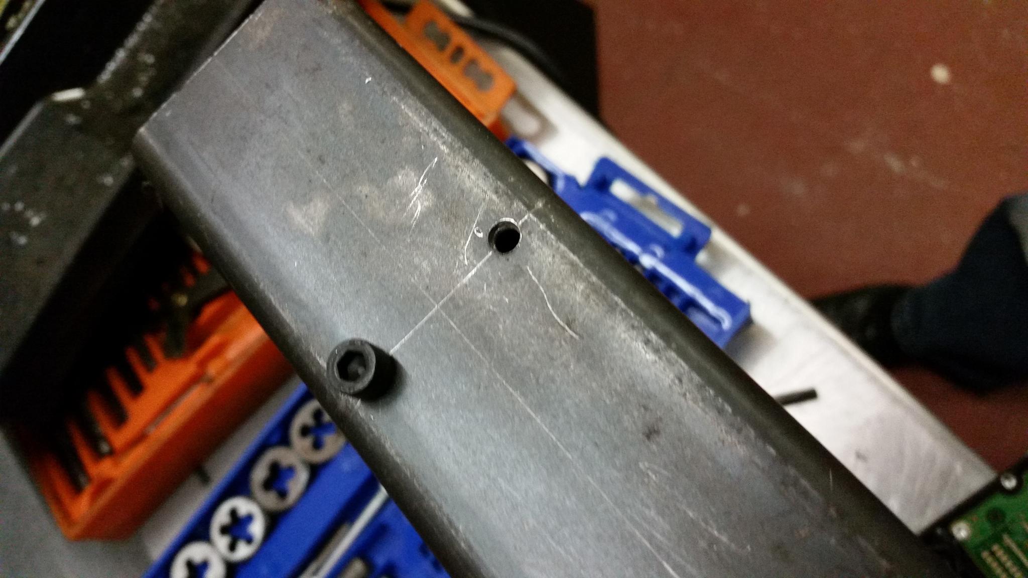

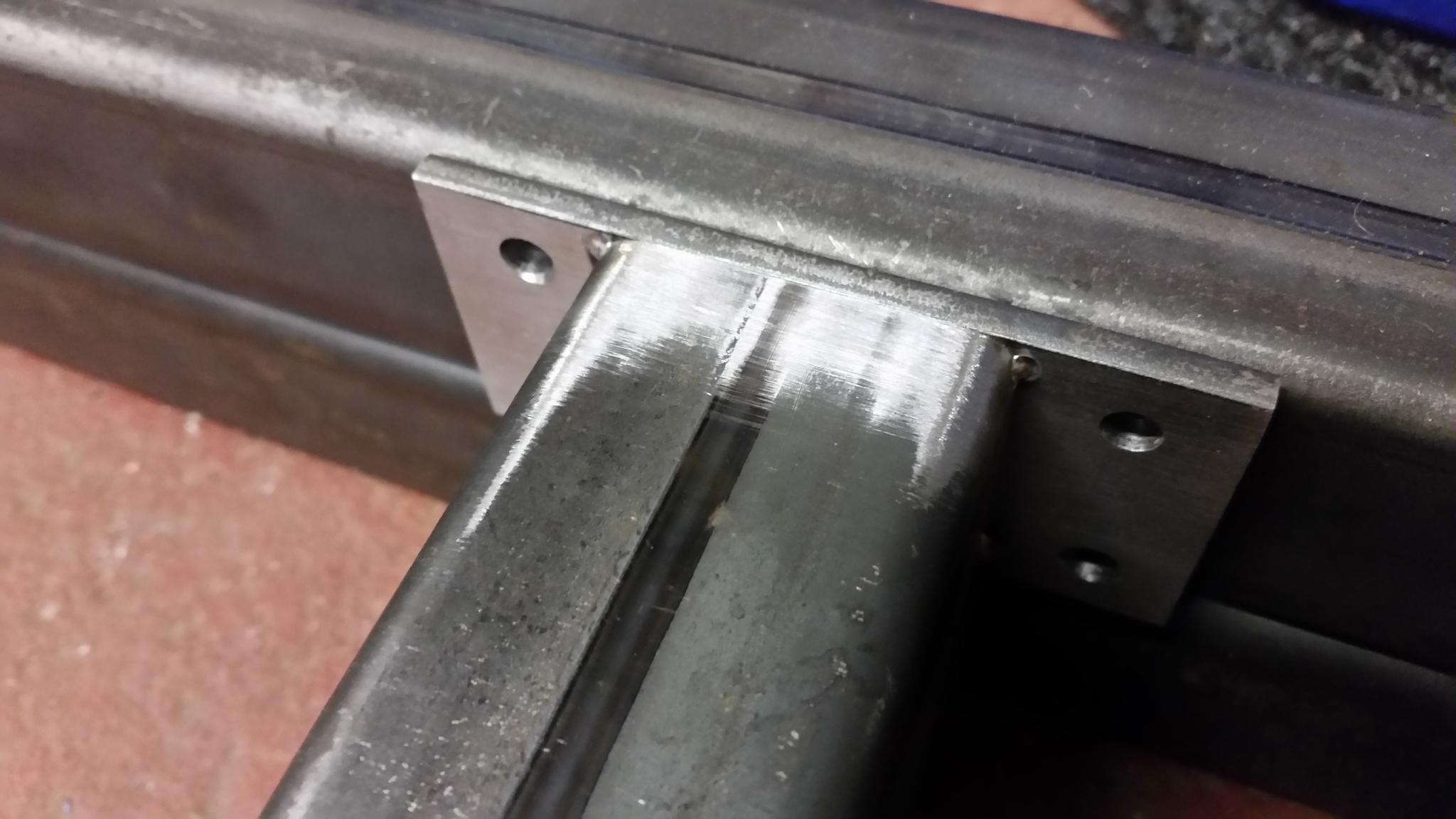

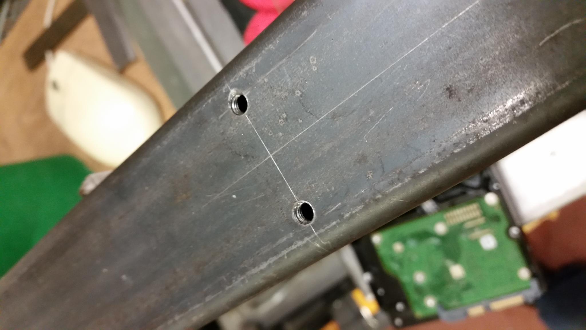

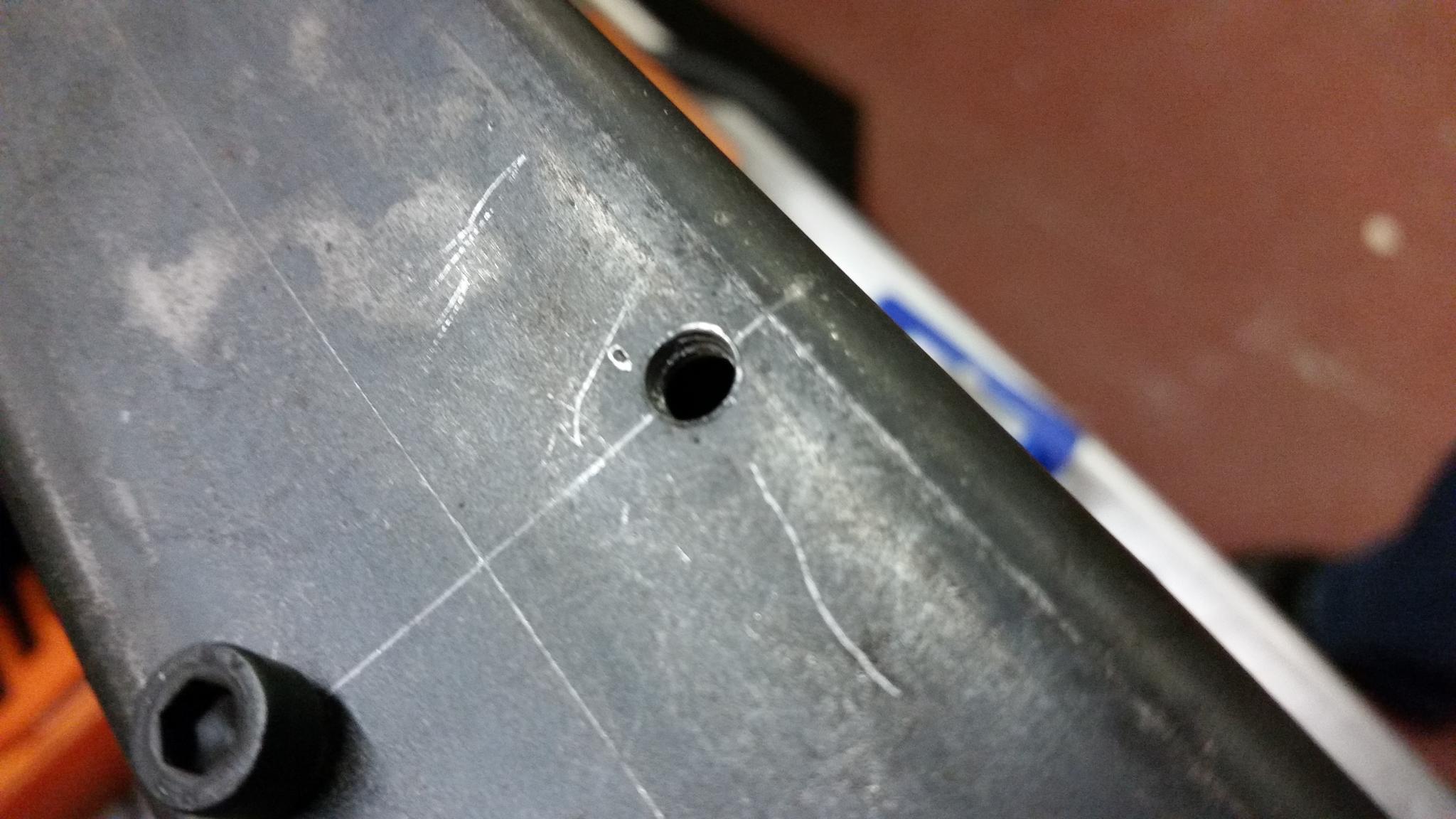

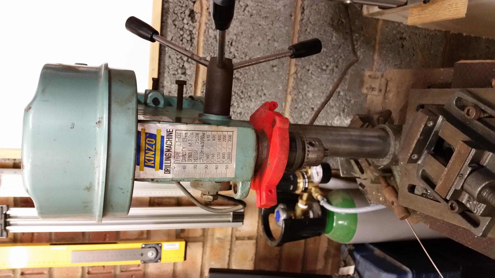

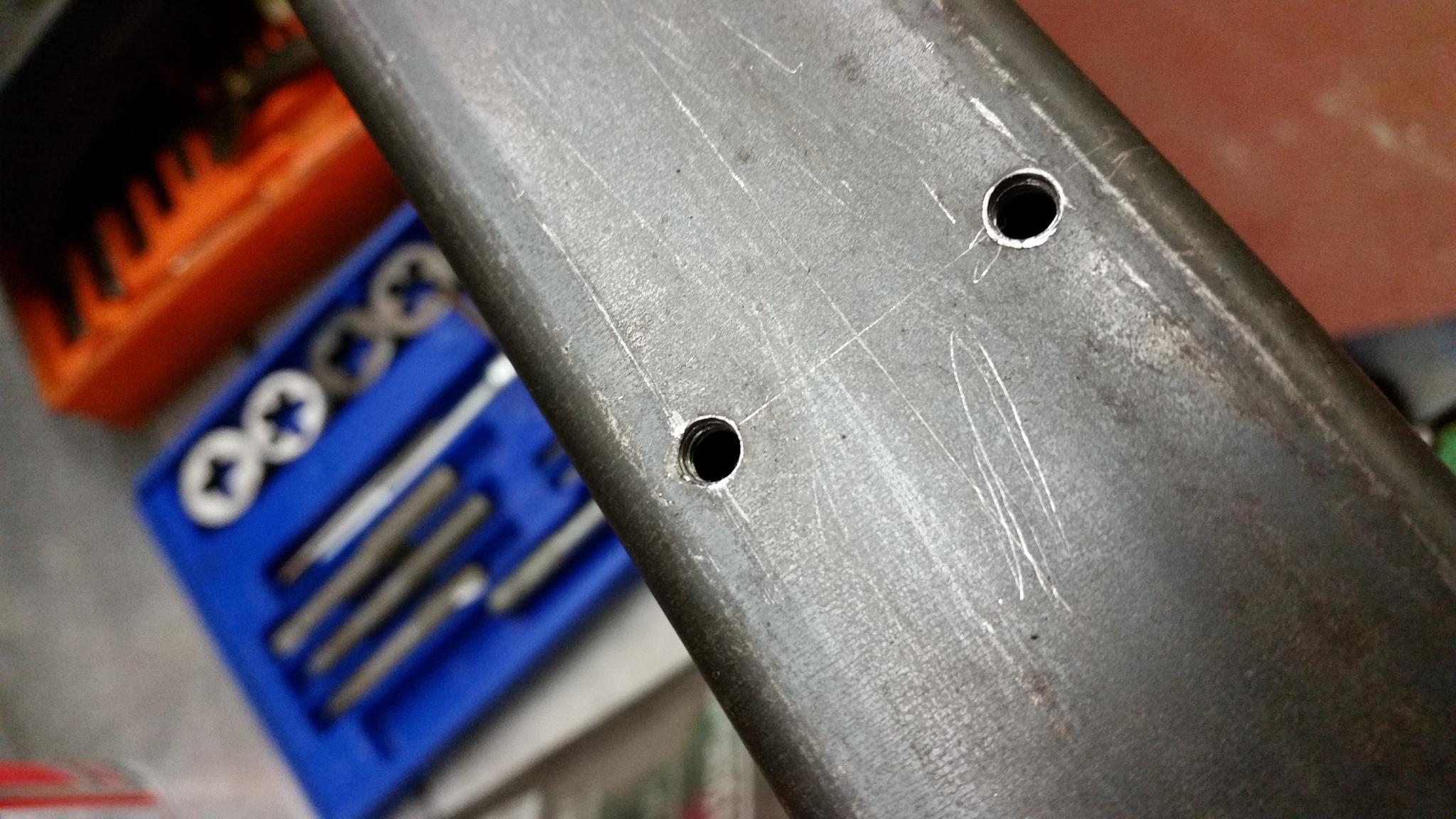

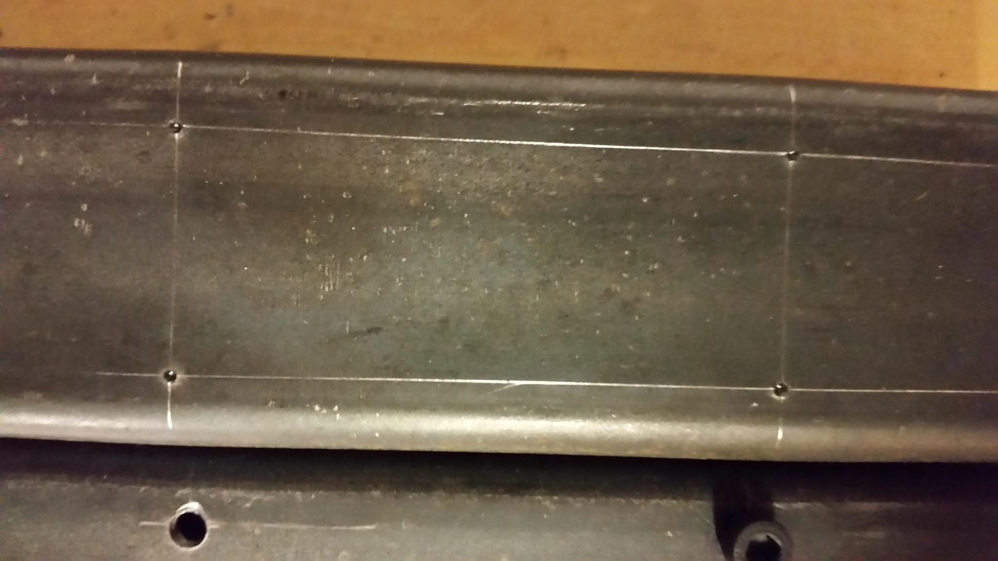

    Hey all
    Well I though I would pop a couple more pics on here as I'm doing bits to keep me motivated too. I'm having a tapping Issue for some reason at the moment. I have used a 4.2mm Cobalt drill bit and I have used a centre punch and then I have used the cobalt but it wanders I have then even turned the pillar drill by hand a few times and I was surprised but it did cut which I guess is because its a new drill bit and then started it and unfortunately it still wandered so I stopped it and put a little pressure on the work piece and then started the drill and that works better but still not good. I think My holes have then gone oval even when the wandering stops when in a decent start for the bit.
    I'm thinking I might even get a better job done with a hand dewalt battery drill. Yes I know its a cheap drill but Would have thought it should drill holes but maybe its me.
    I have even tried to use a stepped drill of 4mm and better rigidity but they are the worst with one side ok and the other only 1 thread
    The Culprit

    The Holes (Although it does screw in and hold when tightened but not right somewhere)
ID:	17093Click image for larger version.
ID:	17094Click image for larger version.
ID:	17095Click image for larger version.
ID:	17096Click image for larger version.
ID:	17097Click image for larger version.
ID:	17098Click image for larger version.
    I have ordered a new tapered tap but wondering if the 3mm just isn't thick enough. Luckily On this bit I can put nuts on them but won't be able to weld them on.
    Oh Well I will carry on.

    Then You need a spot centre drill bit to start the holes.
  6. #76
    Typically you would spot drill the hole first with a spotting drill bit (like a normal bit but shorter and so stiffer) or a center drill bit, a smaller diameter drill bit maybe used as/or well, just take your time as they snap easily at those sizes.
    I can't see this would be a problem with your bench drill though, would continue to use it instead of going free hand personally.

    A very small drill bit can be used to find the centre spot made with centre punch,(spindle not moving), work should be clamped lightly but adjustable, clamp the work tight when positioned and check again to confirm it has not moved. Drill a small hole to confirm position then full size. A smaller drill bit will not move off centre as much as final size. If you still have problems use a centre finder (point) as shown here. https://www.youtube.com/watch?v=RhtBdar4iVg . I was informed as an apprentice many years ago that using the pointer method an accuracy of 1/64th inch (0.4mm) is achievable.
