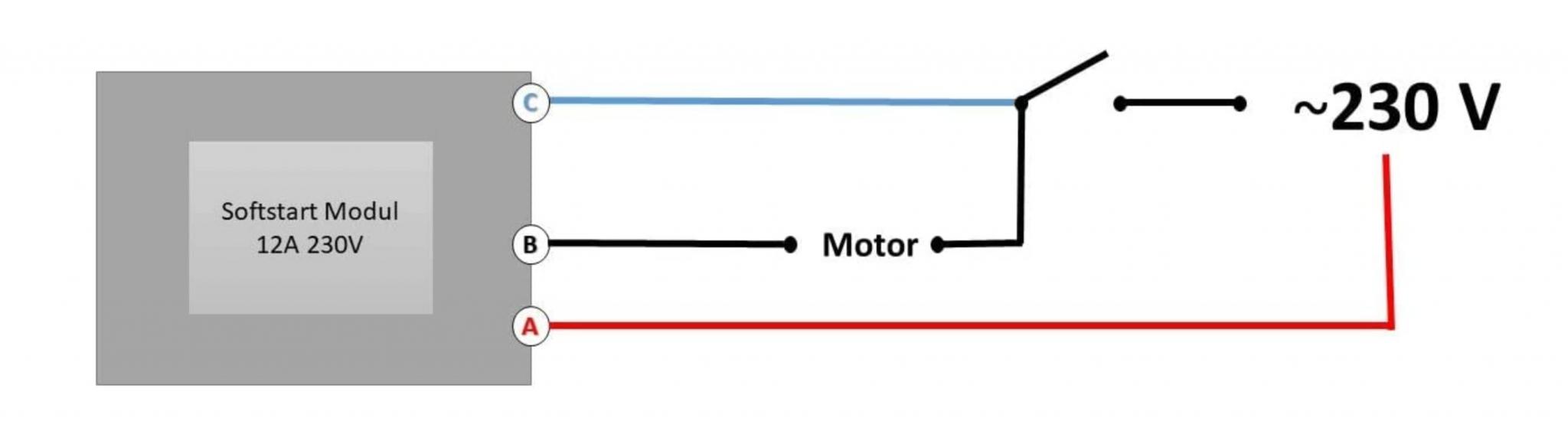

  8. #128
    After m_c had said about the inrush limiter I have been looking at various options but I have found this on amazon and just wondering if I could use that
    https://smile.amazon.co.uk/gp/produc...SBGN3D0P&psc=1
    The Description shows
    Soft start for power tools with brush motor from 220-250 volts max. 12 A (tested to 2500 watts)
    Includes extensive accessories such as cable extensions and plugs/terminals
    Suitable for angle grinders, table saws, hand circular saws, routers, chop saws and mitre saws
    Restriction of the inrush current, protects the bearings
    Compatible with machines of leading manufacturers
Name:	SoftStart Motor.jpg
    or if there is a better way for the inrush limiting.
    thanks
    Rob
  9. #129
    Lives in East Lothian, United Kingdom. Last Activity: 15 Hours Ago Forum Superstar, has done so much to help others, they deserve a medal. Has a total post count of 2,992. Received thanks 375 times, giving thanks to others 9 times.
    A basic thermistor is cheaper, such as https://uk.rs-online.com/web/p/thermistor-ics/2579500
    Although they do take about 2 minutes to cool down and prevent a surge, if you need to turn the machine off and on again.
