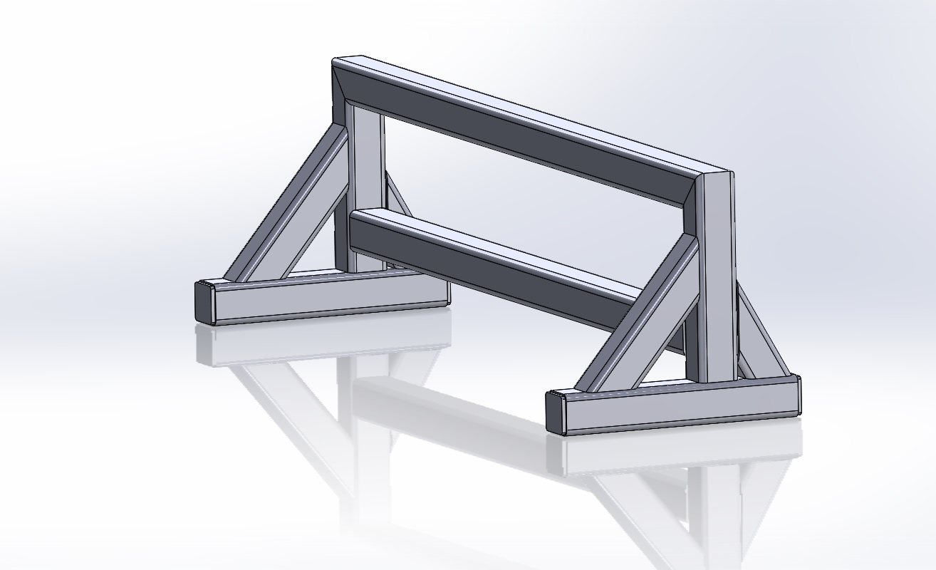

    Quote Originally Posted by grain_r View Post
    I am really sorry when you say move the rails back do you mean so that the spindle is inline with the upright box section of the gantry ? would it maybe worth going for something like 100x50mm box section for the sides and then put the 50x50 towards the rear to the spindle so it is more inline with the uprights of the gantry, I'm sorry if I've misunderstood.
    No was meaning offset back something like this for better centre of gravity and balanced bearing loads while cutting.Click image for larger version.
    Regards bearing distance then I work on Half the travel required.!

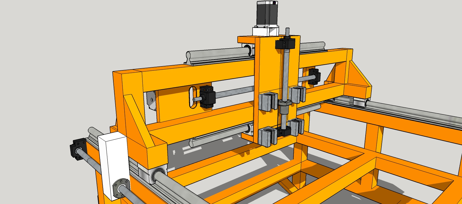

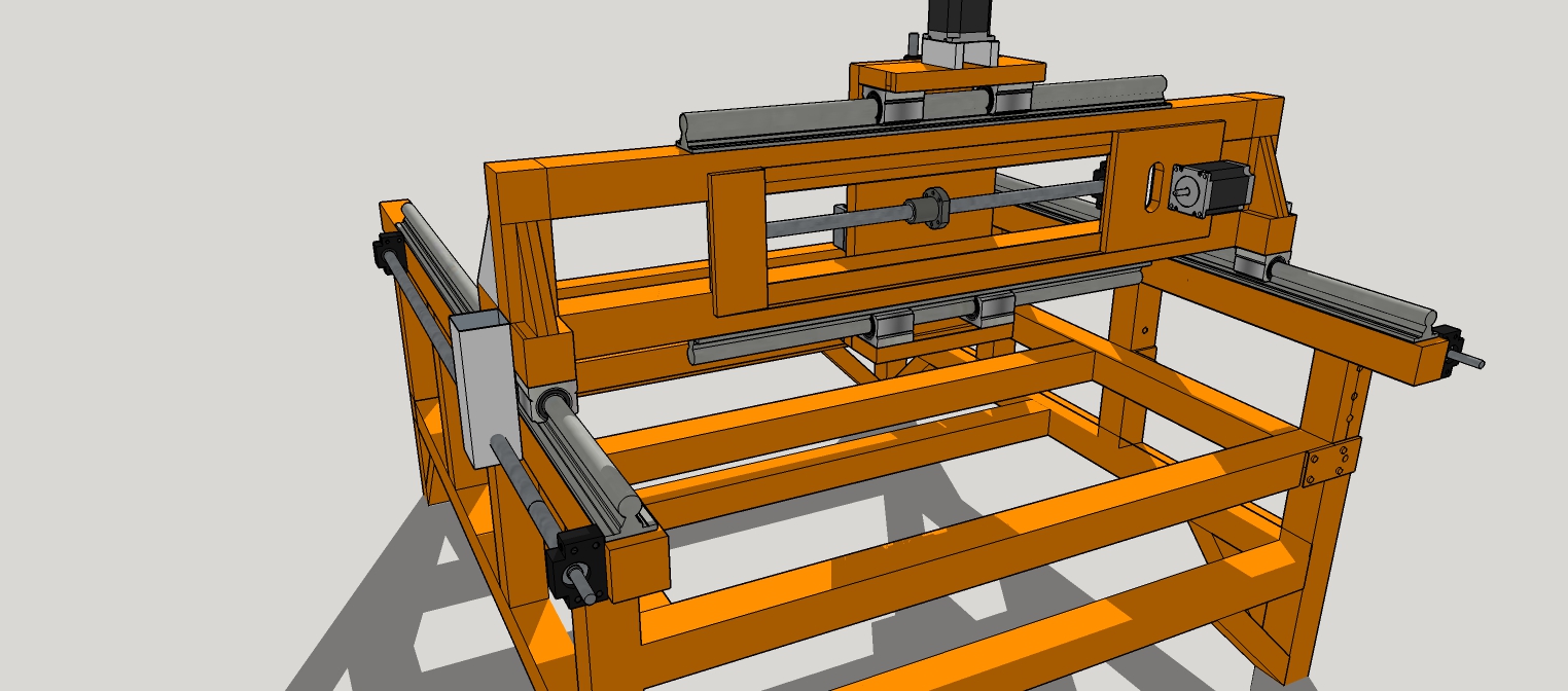

    Oh I see. great thanks I like that. So that I might save a little welding heat is there anything to stop me mounting the screw on the base of the box section although It won't be in the centre or is it best to put some uprights in and then mount to that ?
    Rob
  5. #25

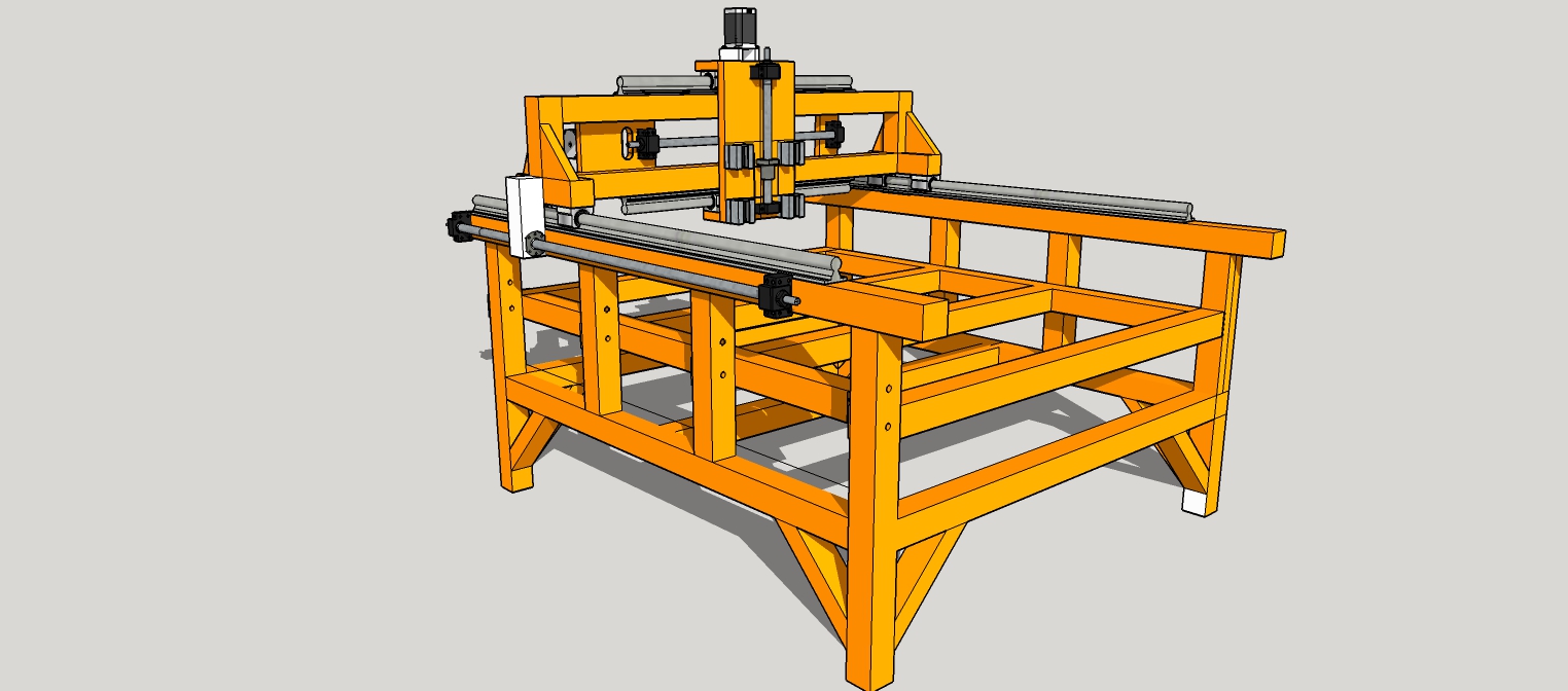

    I have been working on the updates and getting there now because I intend to make it my build log I thought I would keep updating with work in progress for my designs so people can see for the future . I'm getting pretty happy with the design now it seems to feel much better and thanks to you guys I am learning so much with each design change.
    I am having a problem with the X axis I want to use one motor as people have suggested in the past because of Binding and using belts but I cant think of an easy way without using quite a few wheels to send it around the frame if I go directly across It would hinder the work pieces if they hang over the edge.
    Any comments would be most welcome. I havn't put the cable trays or the front axis as yet thats being done at the moment.
    Rob

ID:	13678   Click image for larger version.
Name:	CNC Design full.jpg
ID:	13679   Click image for larger version.
Name:	CNC Design V3 Gantry.jpg

    I know it's a bit more expense but why don't you make the Y axis rails longer and have the bearings spaced further apart on the top and botom rails? It would give you a stiffer machine and looks like the space isn't needed for cuting as you're rails are shorter than the Y axis already. Eddycurrent hinted at this in a previous post I think.
    Neil...
    Build log...here
  7. #27
    For some reason I don't like the look of the box section as brackets for X ball nuts.
    You seem to be loosing a fair amount of travel in Y direction by having short rails and ball screw.
    Think about how you will access grease nipple on Z ball nut once it's all assembled.
    Will you put adjustable feet on the frame legs for uneven floors ?
    Can't see how you will adjust belt tension for the stepper motors shown.
  8. #28
    Also think about how you will bolt it all together, you'll struggle to get the bottom Z axis bearings on as the bolt holes will be covered at the back so you'll have to take it all apart if you need to gt at them. If you extend the top Z axis palte back you can machine into it the adjusting slots you need and also it tucks the stepper down out the way and lowers the height of the Z axis.
    Also don't forget that steel box section comes with rounded corners not nice square ones as you've drawn so you'll possibly need larger section (60 x 60) to be able to bolt the bearings to? I'd also extend the small plate you've got on the back of the Y axis for the floating bearing (small) mounting to provide a bit more stiffness for the Y axis, that way you'll not need any diagonal bracing.
    If you're not sure what I mean attach the sketchup file (if that's what you're using?) and I'll show you what I mean.
    Neil...
    Build log...here
  9. #29
    Hey guys Thanks very much for the replies, Unfortunately I was a silly boy and bought the supported rails kit before I knew anything about the subject from Aliexpress. the plan being I will use what I have for now but then look to either create another or upgrade to rails. I have made it wider also so that I can slide work pieces around a little and work with larger materials and then make a second continued cut although most of the things I do will be sheet material and smaller pieces but I wanted an all-rounder for things like my daughters dolls house I intend to make with the machine and other toys too for her and me !
    I didn't even think about the tensioning in all honesty that is a very good point I will make it on a movable faceplate. I couldn't think of a different way for the box for the ballnuts otherwise the other option being the ali route but though this might be better on the strength I might be able to make a silicone hose to the grease maybe although I'm not sure if it would just pop off.
    I will have a good think to see if I can make those better
    Thanks so much guys.
