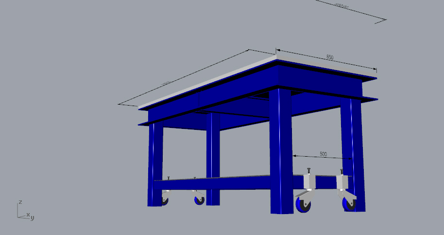

    2. Designed my steel workbench, which will be built first to get into a bit of welding practice and to assist in having a good surface to square things etc. I had in mid to utilise this to also act as a stand/ frame for my Router (to minimise workshop space), but eventually dispelled that notion when I realised my 'portable benchtop' router was a little heavier than expected!
    On that note, if anyone has got a good design for attaching raising/lowering wheels so I can move both router and bench around, I would be most appreciative. I have designed wheels utilising an inner and outer SHS, with a bolt, Contemplated inserting springs which can carry the load when bolt released, with springs compressed (and wheels up) when bolts tightened? Not sure how practical it will be?

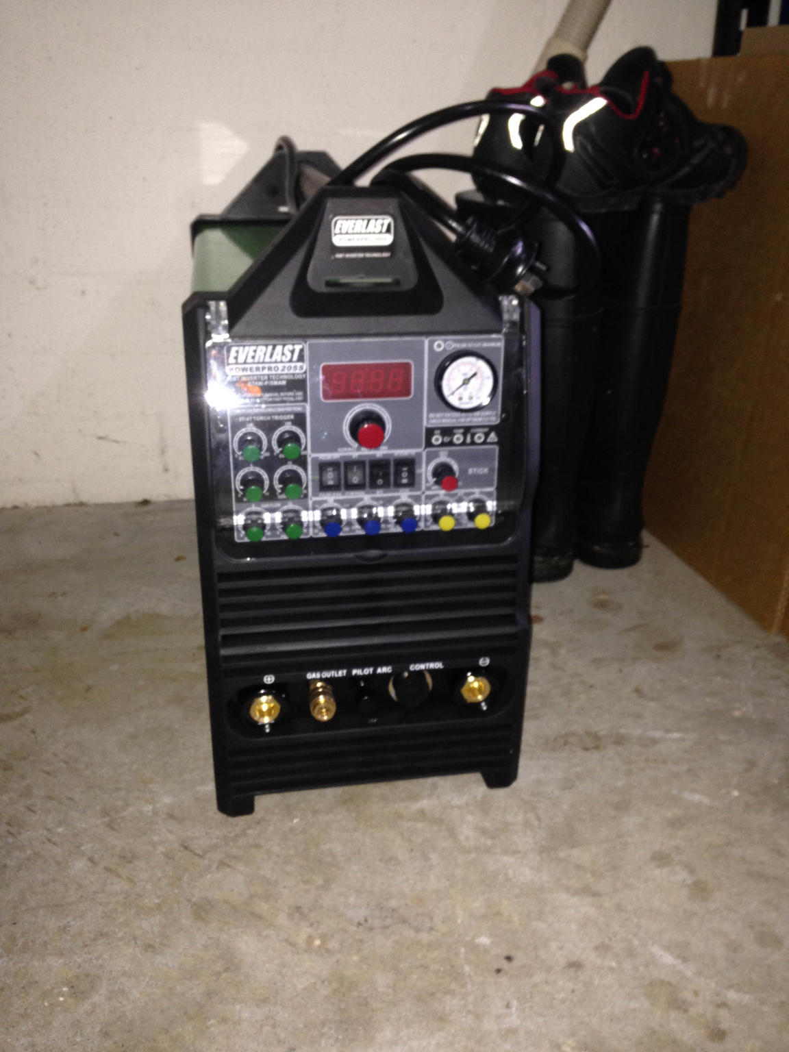

    Pictures of phase I, steel workbench and welder - it looks too clean to use. Will be having a play with welder this weekend.

    Just going out now but will reply better later, however for the wheels design have a look at this video, at about 4:20 min. into the video it shows how to move it, I have one of those machines and the idea works great. It's two fixed wheels at the back and adjustable height feet at all other points.
    http://www.youtube.com/watch?v=J2ry1DxNFA0
