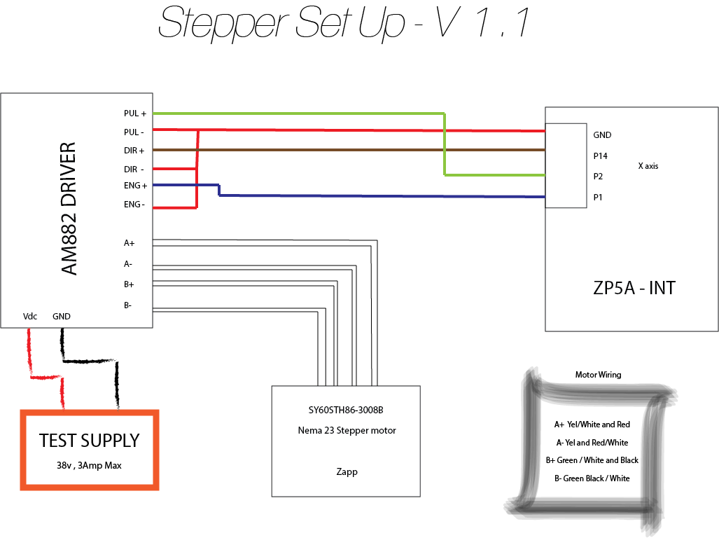

    Thanks for all the advise, however the motor is still refusing to turn smoothly. I did not really explain the set up too well. I am running a old foxconn desktop to control the cnc machine and using my laptop (mac) as a wireless monitor and keyboard using a simple rdc and self dedicated wireless router. I have now clamped the motor to the table. I have attached below a image of the wiring and model names.

    Ok well every thing looks ok wiring wise but I would dump the PC/Mac setup and use dedicated PC setup.
    Set the drives up using the settings Eddy provided.
    Then as a little test using this PC/Mac setup try this. Go to MDI screen and type G0 x100 and see how it moves. (G0 is G (zero) not "O")
    If you still have harsh movement then I would try another PC setup before doing anything else.
