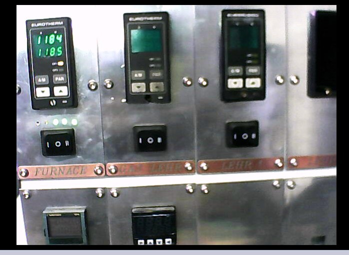

    I have just made and installed a control panel for a glass blower friend. The labels for the modules are fibreglass circuit board. If you put LEDs behind them the lettering shines though beautifully. Next phase of project ??? I might even go full steampunk. maroon and green with gold striping and ornate Ibis carvings in the blank areas of the panels and , of course I would have to change the stainless metric button head screws to whitworth bronze slothead.
    The picture btw is a screenshot of an IP camera set up to view the panel from anywhere.
