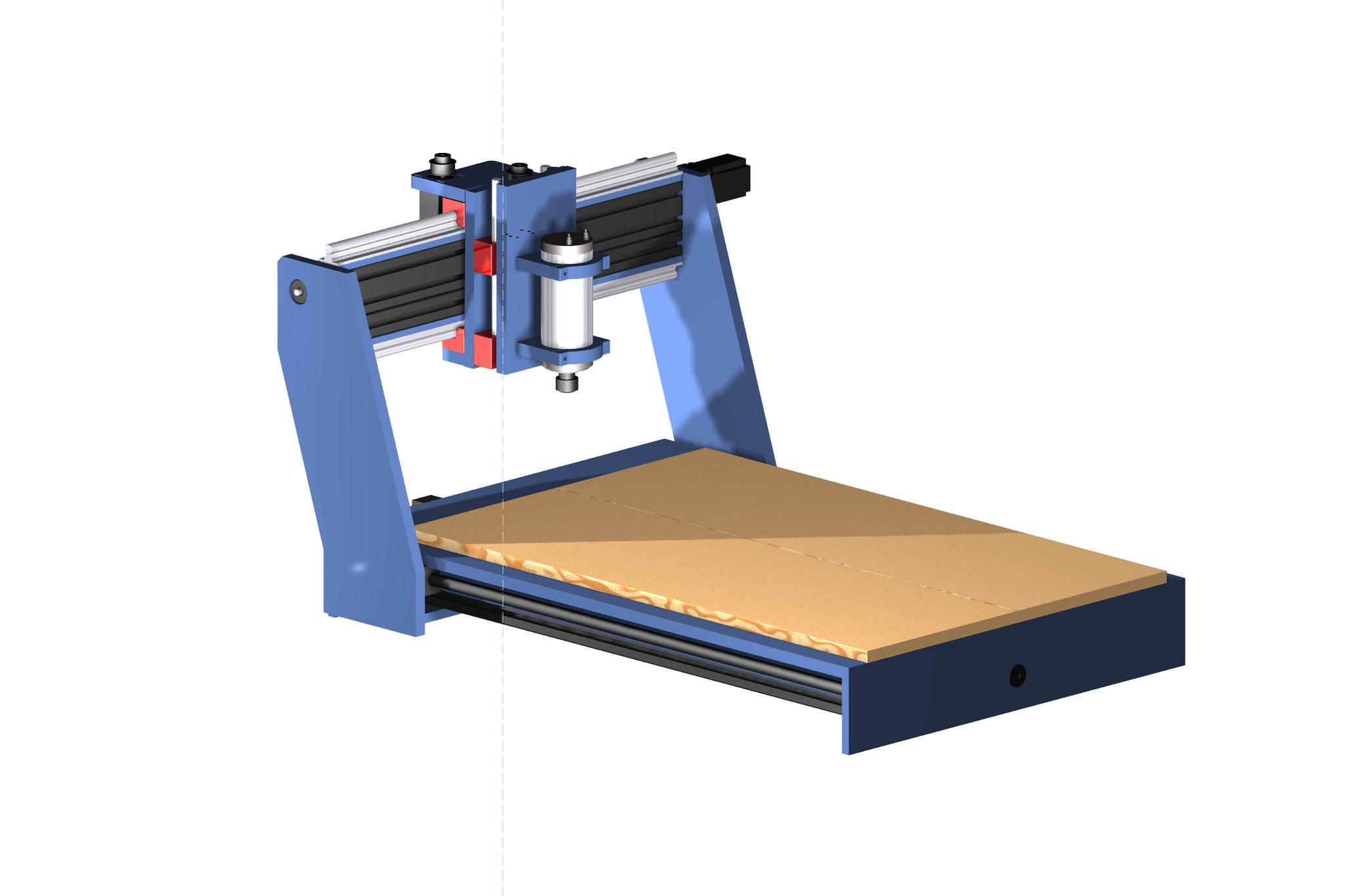

    Hi Clive. I will be driving 1605 ballscrews on all axes 1100 x 700 x 300 nominal flying gantry style router from alu plate and extrustions (see pic attached)
