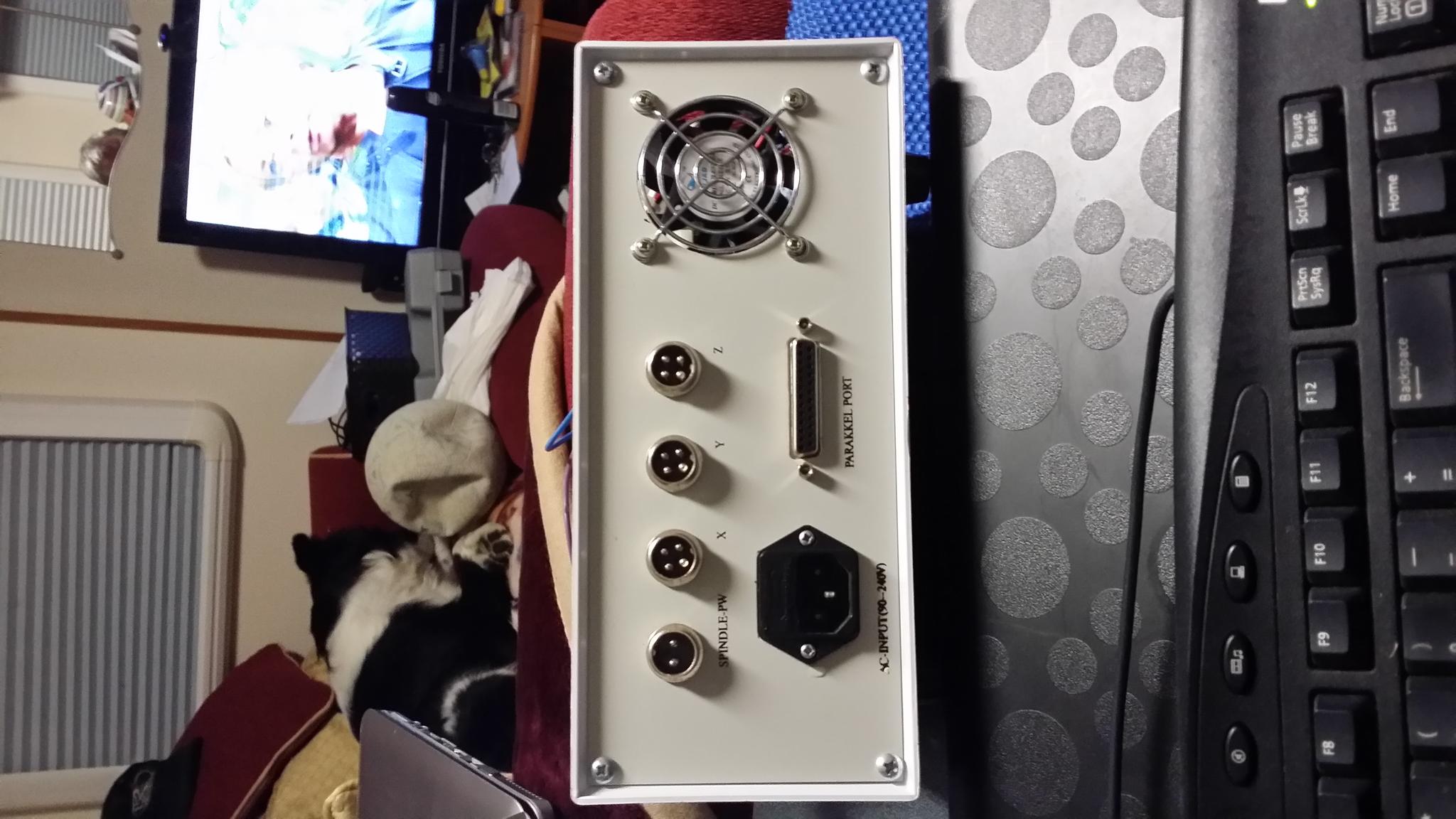

    HI I am a bit wary of posting as I have seen some of the replies on other threads lol.
    However I need to get my small CNC engraver working.
    When I purchased it second hand it was supposed to have a part missing. Allegedly a power supply but it does seem to have one.
    I know its a parallel interface and my computers dont have parallel ports anymore. so I am going to take a photo or two and see if you can assist. bear in mind I only really want it for two things. one to learn how to program and use CNC a bit and 2. To use it on its end to raise and lower a platform about 6 inches or so with a degree of precision.
    I forgot to ask where can I get spare parts for these things and can any one tell from the photos what parts are missing. Please bear in mind the controller board is there but I wish to use USB so will need a new board..
    regards Andy T

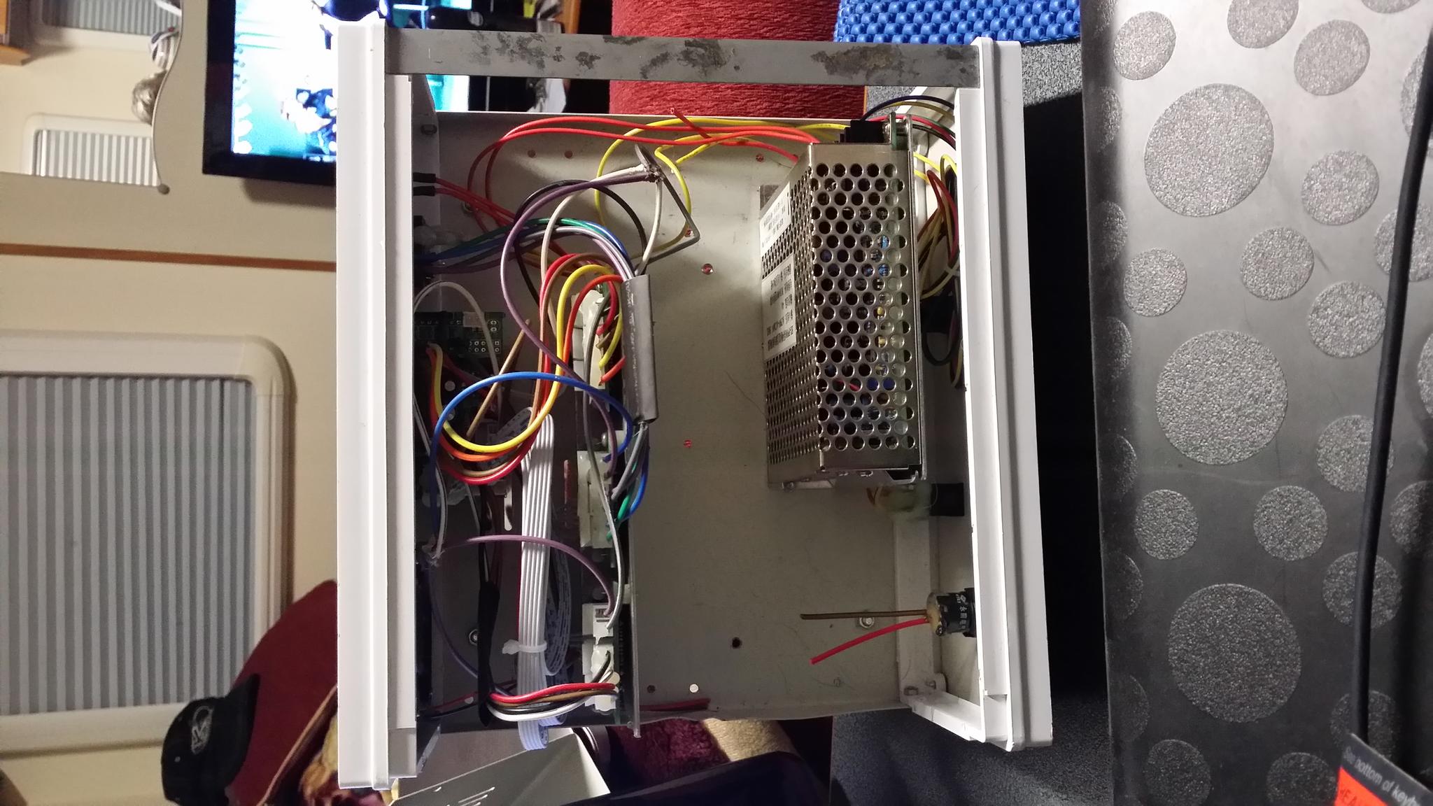

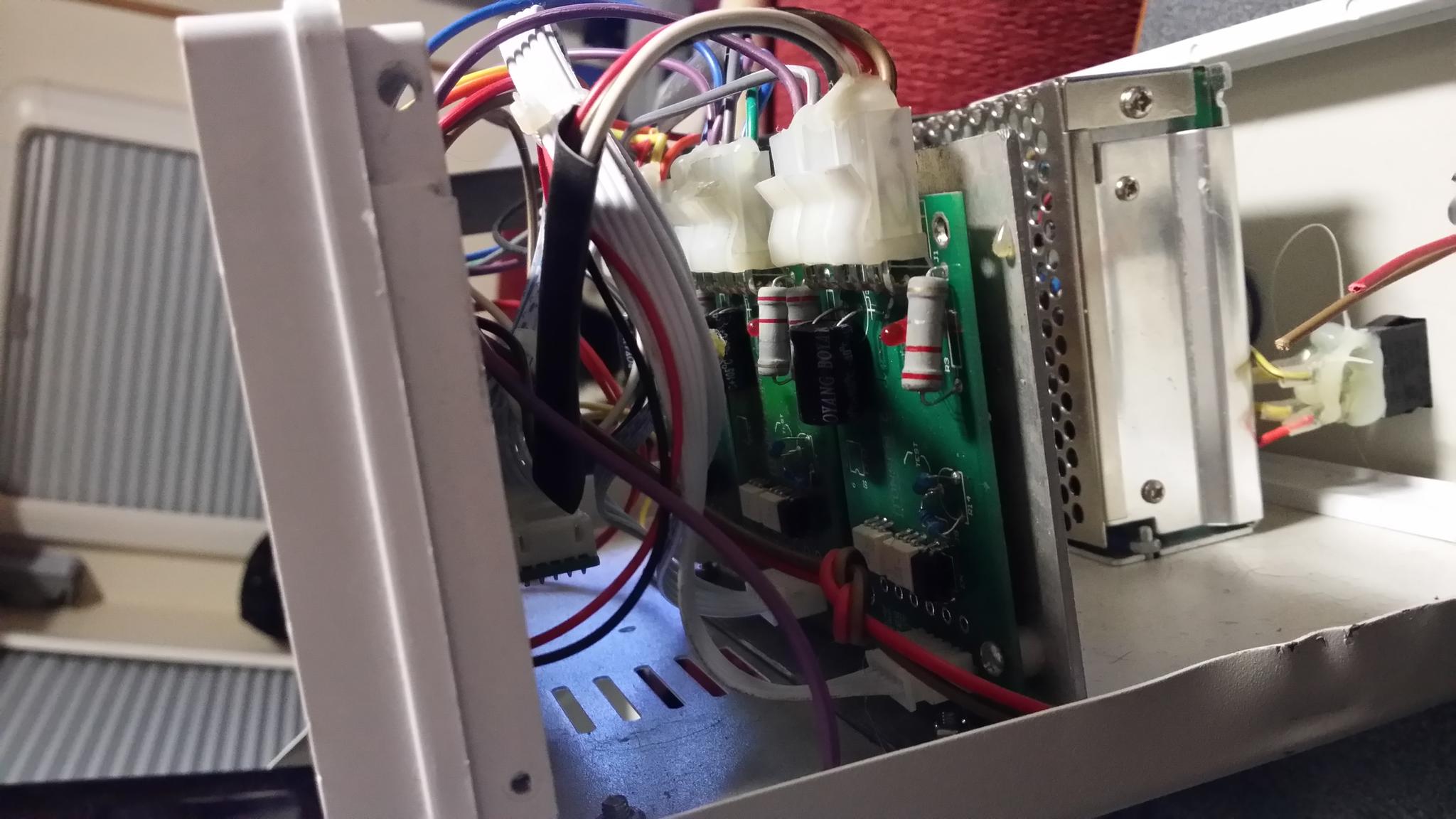

    I was hoping someone who has one of these machines (there are loads on ebay like this lol) would be able to tell me whats missing...there is a big gap and a couple of wires cut for some reason.
    I appreciate the machine is not overly useful BUT I plan to stand it on its end to just use it to raise and lower using one axis.
    I DO appreciate you get what you pay for but my project is at a very very early stage and I dont want to throw money at it unless I know its the right direction to go......even if I have to use the parallel controller to test it ...I do need to know what is actually missing as I can see a power supply but not sure if it should have two???

    Hi Andy,
    Ok what you have there are 3 motor drives and breakout board that takes pulse signals from a 25Pin parallel port connector.
    To use USB connection then you need some other way to generate the Pulses that the parallel port would normally provide. Unfortunatly due to the nature of high number and critical timings of these pulses you can't just use any old USB to Parallel converter as USB on it's own is far to slow.
    Instead you need an external device which takes signals from the USB and buffers them along with other trickery and then generates timing critical pulses reliably and that's why you need the UC100 or some other External motion controller. These external motion controllers still connects to the 25pin connector on the Breakout board which is really just a distribution device to make wirirng easier but provide much better quality pulses at a lot faster rate than the parallel port can provide so this increases reliabilty and performance.
    Unfortuatlly because of the complexity and critial nature of pulse timing there is no cheap way to get around the parallel port.
    Regards what you have hardware wise then from the few pics you provided you should be set to go other than a little rewiring for maybe a E-stop etc.
    Hope this helps.
