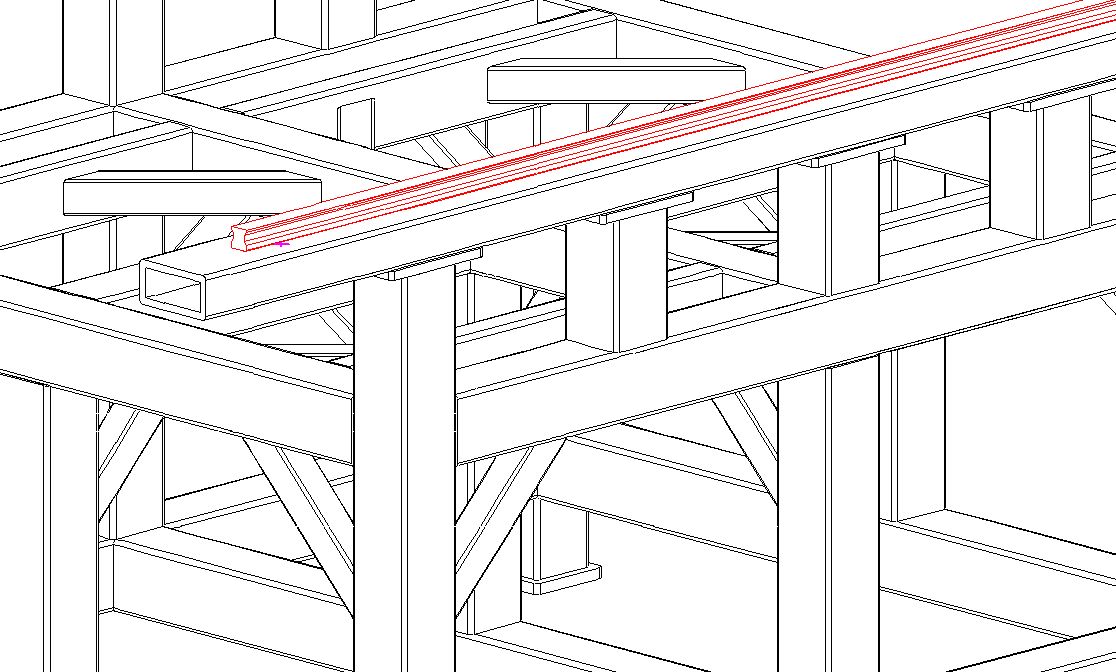

  2. #22

  4. #24
    Quote Originally Posted by Wobblybootie View Post
    you poured your epoxy in small sections ... how did you get them any more level than the posts they were poured on already were?
    Sorry I don't understand this, I poured all at the same time in one big section i.e. two rail beams and two bridges.

  6. #26
    Eddy, I saw the little square pours and the 'joints' between the uprights and the rail beams and thought that was where you had laid the epoxy, then I read backwards ...
    Okay so epoxy will correct minor differences in the rails and the beams, where else can I build in adjustability I don't include basic adjustment in the feet (they were there to take up floor unevenness)
    I can get the rail carrying beams milled top and bottom to give me a sporting chance and have a the lip milled in for the datum edge of the rails.

  7. #27
    As Jazz said, try to design your top rails with adjustability built in instead of relying on epoxy to save the day. If you look at my frame design you will see 10mm plates at the top of each upright on the frame. These have 10mm bolts going through them to fix the top rail in place. If I need to adjust the levels of the top rails, with this design I can use shims under each plate to tweak the levels. I may still need to use epoxy but the chances of getting away with it are better with this design.

  8. #28
    I assume you have fitted a plug into the uprights with a tapped hole then drill a hole in the top of your beam large enough to get a socket through followed by a smaller one through the lower part for the bolt. Close the holes when shimmed and pour epoxy onto the upper surface of the beam ...

  9. #29
    No, I bolt upwards through the plates into the bottom of threaded holes on the top rail.
  10. #30
    Quote Originally Posted by IanS1 View Post
    Like he said, and with your 5mm section it might be okay but if not, as in my case, I glued in a piece of 30x6 flat strap using Gorilla Glue to increase the wall thickness.
