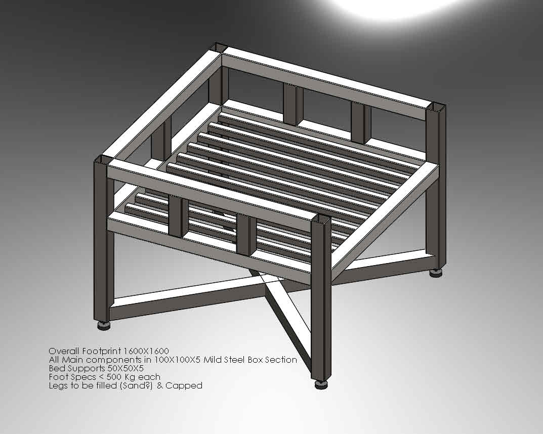

    Thanks everyone. BUT all change!! (for the better I think, read cheaper and Easier!!) I have spent the day on the floor with paper templates that I will be using. I have discovered that I can fit the the templates onto 2 half sheets IE 1220 X 1220 with very little waste.
    So Ball screws all round and Hiwin 20mm blocks and rails.
    I have sketched a frame for your perusal and comments that I will post shortly (when the kids have finished homework). Is there a preferred format?

    Just upload jpeg snapshots of the drawings from whatever software you use.
    First Draft.
    Gantry to fit on 20mm rails atop the frame. Z travel needed 350mm

    I think you would be better with something on these lines.
    http://www.mycncuk.com/threads/6565-...4294#post54294
    You don't need a back in it and your top beams are not suitable for carrying the X rails due to the legs coming up through.
    If you notice, my top beams are bolted to the frame, this allows for shimming to get it within a gnats knacks, ready for the epoxy.
