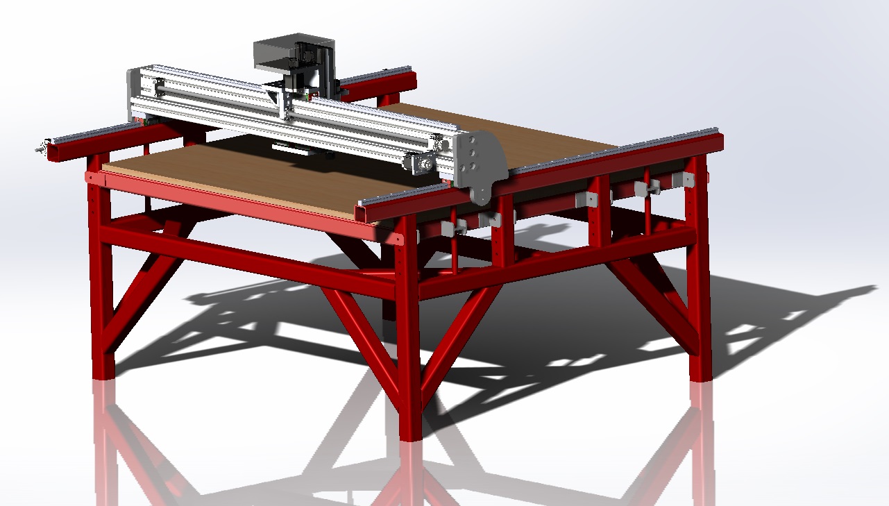

    First Draft.
    Gantry to fit on 20mm rails atop the frame. Z travel needed 350mm

    I think you would be better with something on these lines.
    http://www.mycncuk.com/threads/6565-...4294#post54294
    You don't need a back in it and your top beams are not suitable for carrying the X rails due to the legs coming up through.
    If you notice, my top beams are bolted to the frame, this allows for shimming to get it within a gnats knacks, ready for the epoxy.

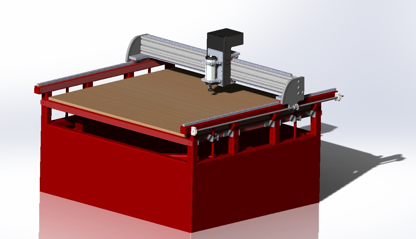

    No very difficult to build that way and too weak in key areas. Not enough bracing at bottom and the top rails will be very hard to get on same plane.
    Look at this and Work along the same lines as this with regards bracing etc but without the adjustable bed if not required with slightly lower sides and you won't go far wrong.

    This machine is in progress and will have 4th axis on the end when it's finished.
    Also Why 350mm Z axis travel.? That is quite a lot and if your planning on cutting anything hard you'll get lots of flex and resonance giving a poor finish.

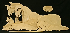

    Why 350mm? Because the whole idea of building the machine is it to perform two tasks, firstly to cut forms from 18mm Birch Ply and then when the forms are assembled by stacking one on top of the other to mill to the final shape. If I cannot have 350 mm of cutting depth I am throwing money away.
    I was hoping to be able to store ply sheets ( I buy 10 at a time) under the bed. However with all the triangular bracing everywhere that also appears to be a No No ... Oh well back to the drawing board.

    For some reason, after reading you're other thread, I had it in my mind you were laminating at 90 deg. to that shown in the photo.
    It's okay milling to 350mm depth but what length cutting tool do you envisage using ? you don't want the spindle crashing into the job.
  10. #20
    I'm sure I said fore and aft ... nose to tail anyway now you see the size of the profiles that are cut.
