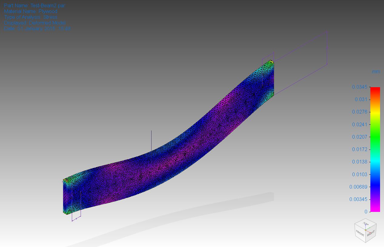

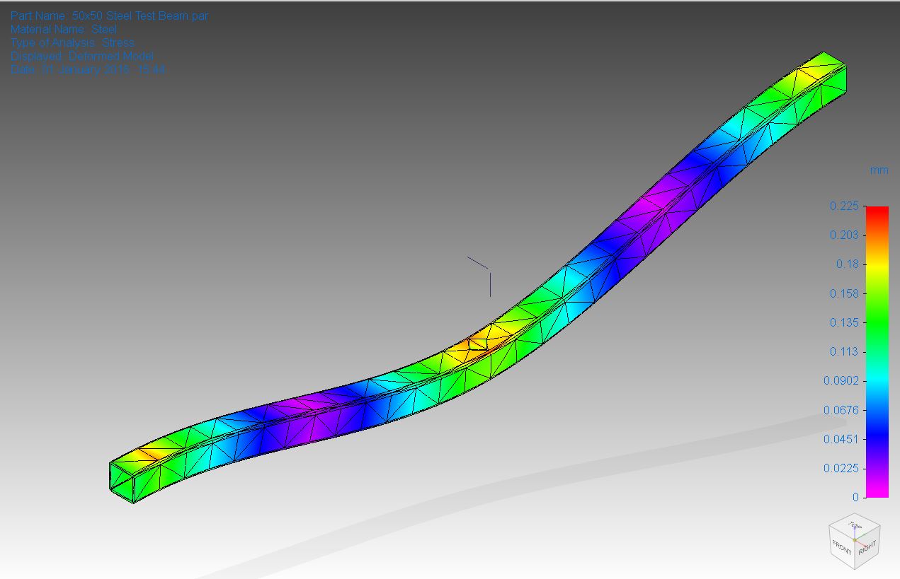

    Anyway to try and put some fact & data to it and to defend some use of wood haha.
    I compared two beams, one steel 50x50x4mm 1400 long. Constrained both ends and applied a 750N load in the middle. Deflection = 0.225mm
    The same applied to a Marine Plywood 25x200mm beam. Deflection = 0.0345mm
    OK the steel is the same in Z and Y.... The Ply only in Z. So perpendicular bracing required. (Ply also has lower thermal expansion and once sealed should be OK for humidity).

    Looking very nice! Wood and aluminium together is just sooo easy on the eye :-) Interesting comparison of the wood and steel, just keep in mind that the force in the direction you simulated is actually very small in gantry routers. Because the cutter is located relatively far from the gantry the force on the gantry is more rotational rather than straight in Z and Y, due to the leverage created by that offset. Would be interesting to see the same comparison with that in mind.
