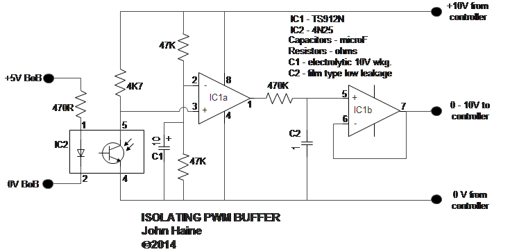

    STOP!!!
    The key phrase is written in the thick black box round the speed controller schematic. It says:
    WARNING. The electronics is at mains potential do not earth!
    This controller, like mine, is a thyristor type with all the control circuitry run direct from the mains. It also needs a dc input from 0 to 10 v on pin 3 relative to the 0 V on the controller to vary the speed. There is no sign of a low pass smoothing filter to convert PWM to the dc control voltage.
    To control the speed from the BOB you will need an opto isolator driven from the PWM output, which will safely transfer the PWM to the high voltage environment of the speed controller. Then you need a simple low pass filter to smooth the PWM, to generate the control voltage. The was a circuit on the Mach 3 boards a little while back, I'll try to track it down.
    To reiterate, if you connect the 0 V on the BOB to the controller as shown in EddyCurrent's picture, on switching on the mains will be applied through a rectifier to ground. If you're lucky the fuse will blow, but rectifiers blow up faster than fuses! Guess how I know?

    Lots of pots designed for mains isolation, that's how all TVs used to be. There is nothing wrong with designing a drive like this, as long as the speed control is manual with an isolated pot. My KB drive is industrial, they have a whole range of them.
    Miller, important to note that the circuit in the Mach forum has to have its own mains power supply to maintain isolation. The trouble is that it needs a supply above 10 volts to get 10 v max output.

    OK, I've sort of been inspired by this thread to work out a simple circuit to interface the PWM from a BoB to a non-mains-isolated speed controller such as the Sprint or KE type thyristor units. This circuit does not need an auxiliary power supply, it runs from the 10v available from the controller itself. It uses an ST Micro dual "rail-to-rail" op amp to hopefully get the full 10V control range. It isn't tested yet but offered just as an example, but I think it should work.
    I've just noticed an error in my labelling - on the input side the pin labelled "0V BoB" should go to the output you have selected for the PWM speed control, not the 0V rail!
    On the controller side, it looks like for the Sprint box that Miller has, +10 V comes from terminal 1; the control input ("0-10V to controller") goes to terminal 2; and 0V is on terminal 4.
    This could easily be made on a small piece of strip board, but take care with the IC2 connections as there will be mains voltages on pins 5 and 4 so make sure they are well isolated from 1 and 2.
    I suggest configuring Mach for about 25 Hz PWM base frequency. One problem you may find is that the low speed end where the machine may not start until the speed is turned up a bit from zero; or may run very slowly even though set to zero. It's quite complicated to replicate the function of the "min speed" pot in the controller.
    I do need to get round to adding speed control from Mach to my Novamill, so this should get tested sometime! But any questions or feedback welcome.
