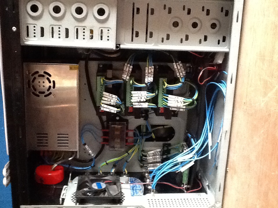

    I've made a cnc controller out of a pc case and it's looking realy good

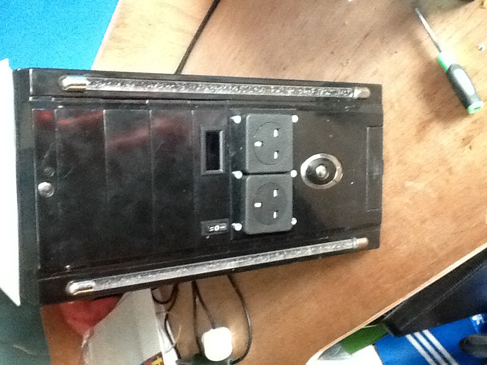

    This is my controller so far
    still need to hook the limit switches up

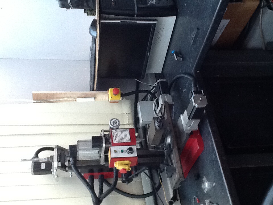

    This is my machine
    the controller is in the house at the moment so I can draw a nice wiring diagram for safe keeping and sharing

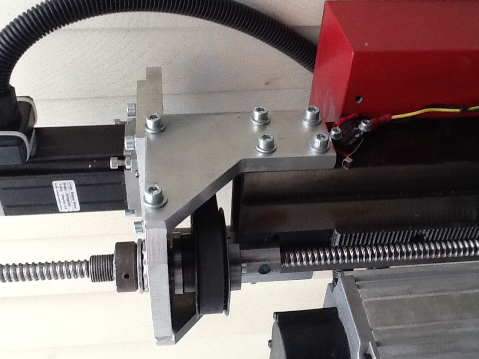

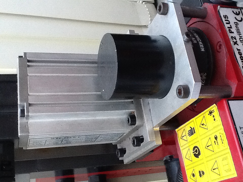

    My z axis mounts all made manually on this machine and ballscrew
    And nema23 425oz stepper
    I also had to move the spindle motor forward so I got a shorter belt of fleebay and made new mounts

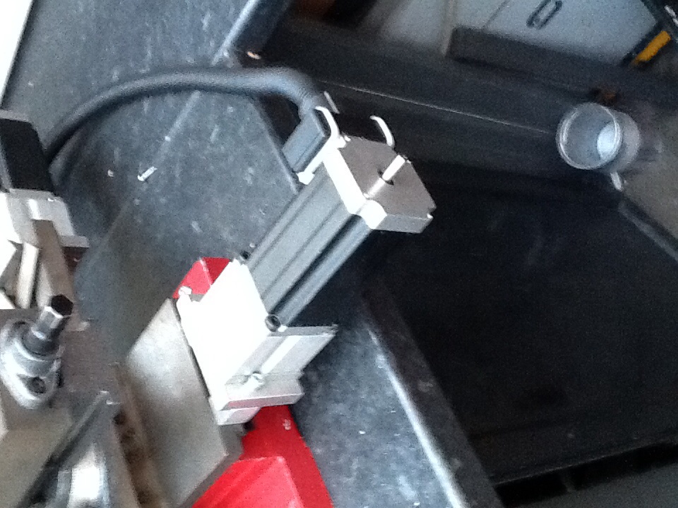

    Got the X and Y motor mounts of eBay and had to make a 6mm spacer to compensate for the length of the lovejoy couplers
    i also made a plate to house a bearing and thrust bearing

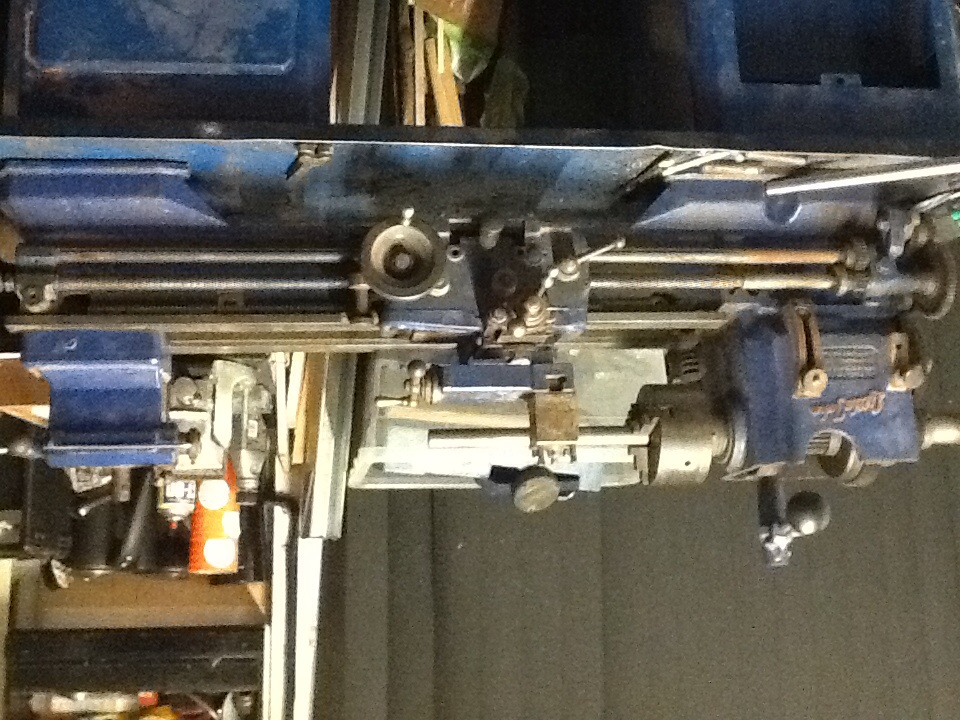

    Just got a lathe cheaper than what people where offering to end machine 2 leadscrews for me
    So over the next couple of days I plan to clean this bad boy up and machine my leadscrews for my sx2
    i will post some pics of my progress on the lathe over the next week or two

    A nice idea would be to post the pictures the correct way up. its difficult standing on your head. ..Clive
    That looks likie an Australian import....make sure it cuts the threads the right way round not upside down and back to front...
    Neil...

    Started cleaning the lathe and got a bit carried away lol
    i had some paint of a steel structure I fitted in work and it's fire rated paint so I thought y not
    Need a good vfd for a 0.5 hp 3 phase motor any suggestions?
    where can I get a tool post also as the ones that came with it are home made and don't look good?

    Finished the lathe up to now I have put a misubishi vfd controller and a 3 phase motor on it an it runs well. I can control the speed easily
    I bought new bronze nuts for the top slide and crossfeed and a new top slide leadscrew
