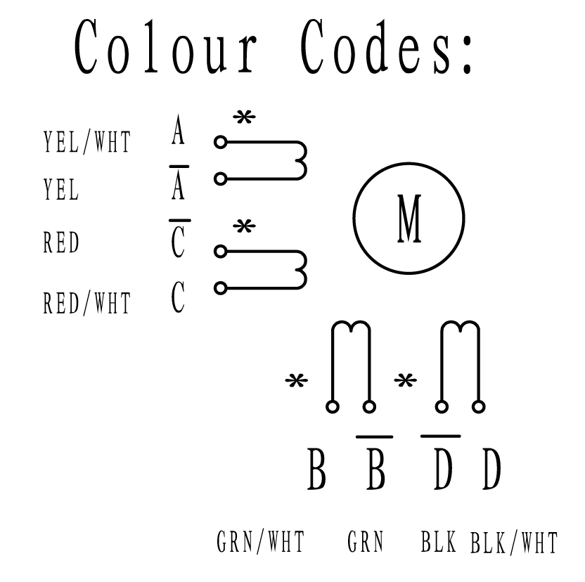

    I normally have a good friend of mine building my control boxes so ive never had the chance to see how its done. my question is to you good guys how the hell do i wire these things up, or more importantly can you explain the diagram for me?
    Could someone please explain the attached image please so i can try crack this once and for all ..

    Hey d-man, those curly bits are the windings of the stepper motor. So from your pic you would join the YEL and BLU together and the ORG and BRN. Then run the remaining 4 to your stepper driver.

    Are you sure you want to use that way to connect the motor ? that's a series connection, most would recommend the parallel connection.
    A+ Red
    A- Black
    B+ White
    B- Green
    Yellow & Blue, connected together but going nowhere, just insulate once joined.
    Orange & Brown, connected together but going nowhere, just insulate once joined.
    Well it was just to try get my head around it Eddie, then i looked at the parallel connection and started to smell smoke (From my brain!) Parallel connection here http://prntscr.com/4wyek3

    Ok so, going for the parallel connection am i right in saying...
    A+ - Red/Blue
    A- - Yellow/Black
    B+ - White/Brown
    B- - Orange/Brown

    Parallel connections
    A+ Red & Blue joined together
    A- Yellow & Black joined together
    B+ White & Brown joined together
    B- Orange & Green joined together
    Edit: Ha ha you just beat me to it but you got B- wrong (typing too fast likely)

    Crap ran into another stickler...
    Im using the MSD542 drivers with the Nema 23 SY60
    Motor diagram looks like this...
    However the Driver datasheed does not give colour codes http://www.motioncontrolproducts.com...ing-driver.pdf
    I have the wires joined, its just getting the 4 coupled wires into the A+ A- & B+ B- if you know what i mean.. how do you determine what double wire is for where

    A+ yellow/white & red
    A- yellow & red/white
    B+ green/white & black
    B- green & black/white
    see diagram on page 7 for parallel 8 wire connection
    http://www.leadshine.com/UploadFile/Down/AM882m.pdf
