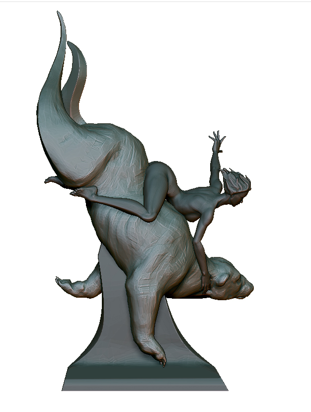

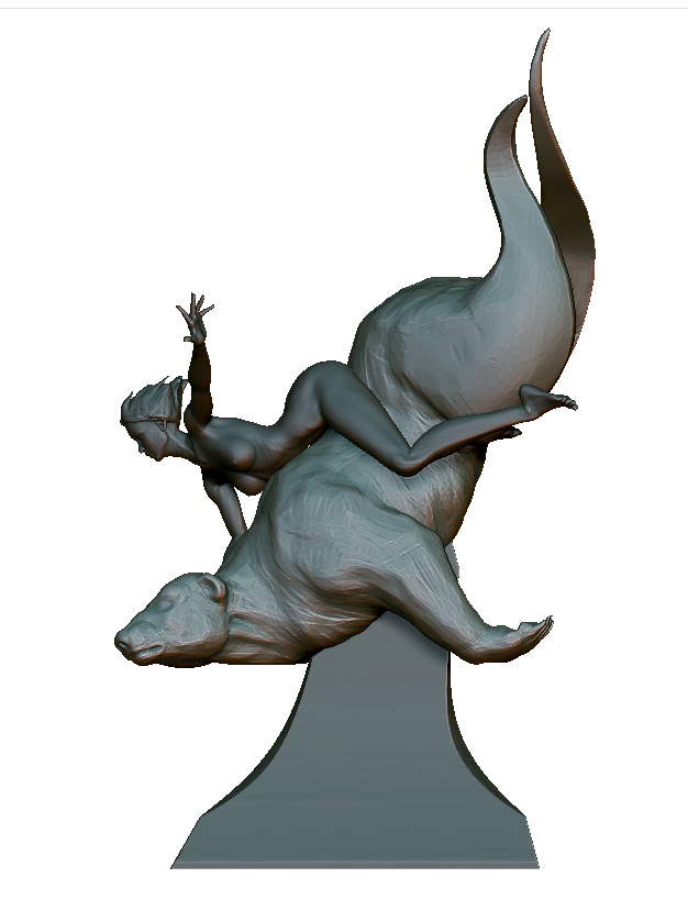

    But here is an example of something that would already make my happy and in fact it was done this way:
    Here is the 3d model that I have made :

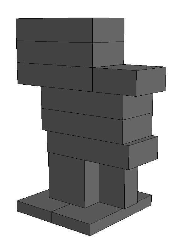

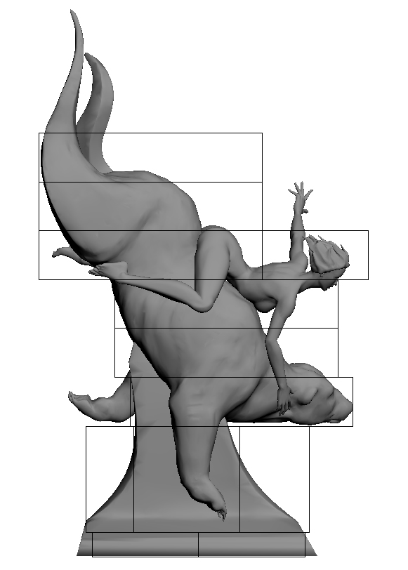

    This is how it all fit into the blocks:

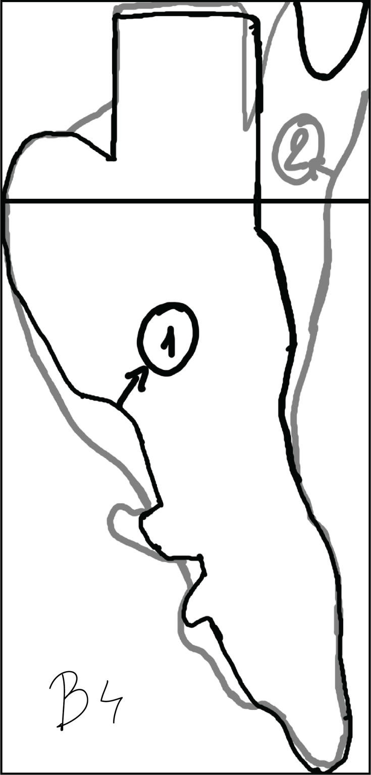

    And basically I have only did two passes on each block like this:
    Each of the passes went in 125 mm. The line across is for alignment basically just a scratch so I know how to align it with the next block.
