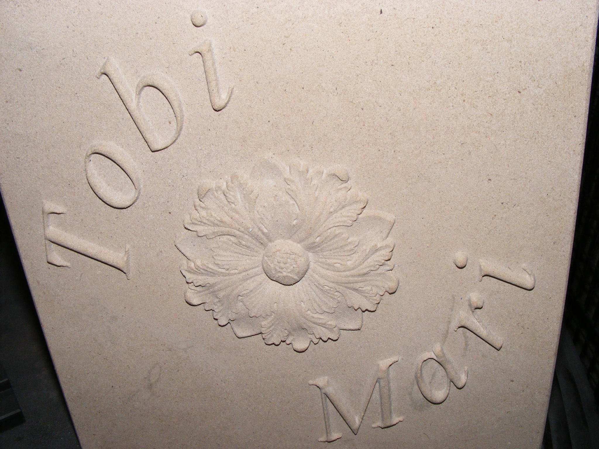

    Yes it is possible to cut slate with carbide but the cutting edge has to be ground to a different angle to give a small back relief to preserve the cutting edge, in reality you are grinding the stone not cutting it, If you want 1mm deep you would do this in 1 pass.
    Your cnc machine also needs to be very rugged with water flood.
    The image below shows a 2.5d relief that is 8mm high for the flower and 6mm high for the text all the stone between is ground out with 2mm roughing passes then change to a V cutter to do the relief in 2mm passes.
    as regards feeds you need to test cut on each type of stone, on old stone that has oxidised/hardened you will find it is slow.

    My router is a small light piece of kit purchased specifically for this to avoid the obvious corrosion/ erosion to the main mill. So unfortunately will only be capable of light cuts and small step overs. Currently working out the screw protection for it and perhaps machining in a fabricated plastic bath??
    As to coolant, assume tap water is OK or are there any obvious additives?
    Will trial with existing single flute D bit carbide bits. But saw some 4 square unfluted 60 and 45 deg. cutters being used. Which would be easily ground and resharpened from broken stubs. Any info on that appreciated.
