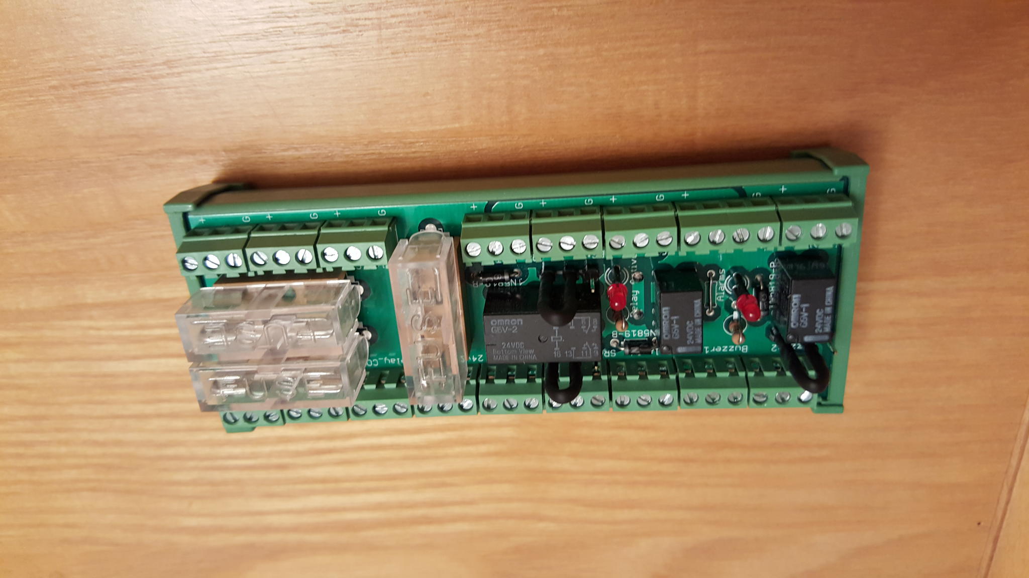

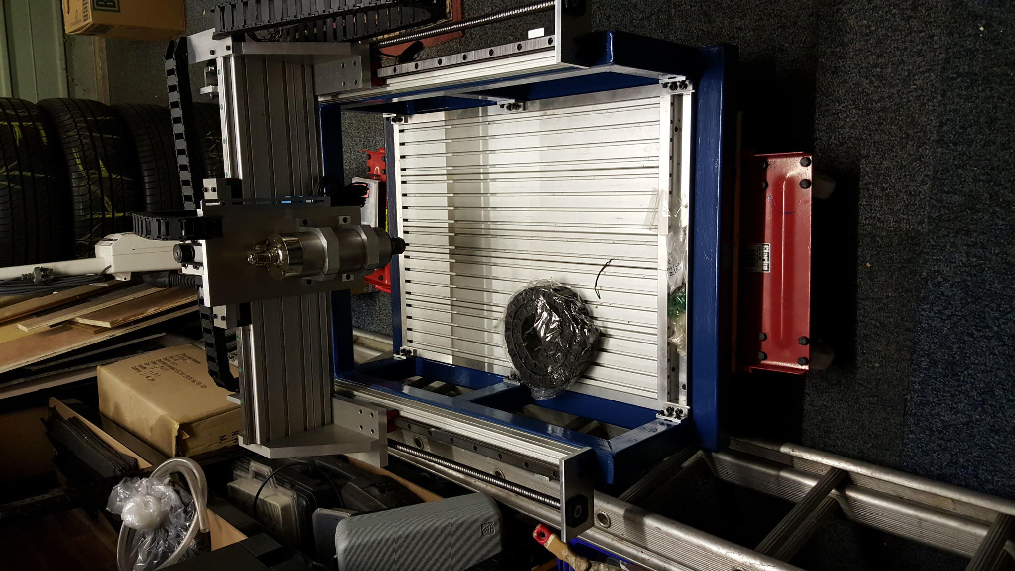

    Small update and rubbish pics. I've started running the cable into the cnc. Also due to my small cab and to make wiring easier for me I've made a pcb to handle the control of the master relay (that's not on this board). It's very basic in design but reduces space and handles drive fault signals and isolates to the limits due to their current drive limitations (bit otters but just incase) (am882s can only handle 100mah each and let's you setup in series or parallel depending on the am882same config), limits (the prox sensors can handle 300mah each) , estops, buzzers and over ride as well so a few other bits.

  9. #67
    Looking good Trev.
    Like the PCB as well. You might find a few takers on here for that.

    Thank you everyone especially to JazzCNC for all your help. Today i finally got my cnc to move by mach and the motion controller for the first time. Im very pleased. Ive got some jobs to do yet like finish the control panel on the cnc itself, and sort the mist system.
    I have one drive disconnected at the mo and have bypassed the alarm (will do a much better job of that), as that is for the eventual 4th axis, but i will learn the 3 first.
    Thanks again guys
