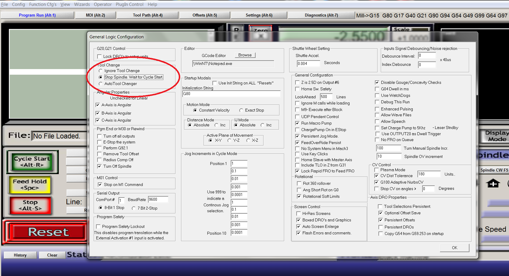

    Just an update to say im still alive and have not given up, ive finally moved into my house fully a few days ago, and managed to do some work on the cnc. One of the home sensors was faulty so i swapped that out and its running a basic g code file (although not cutting anything yet) fine. In the file i have though it starts with a tool change request, but the spindle carry on running. Is this because i need to code the macro for the M command?
    Not sure what you are saying here but the spindle should start using a M3 and then to stop it use a M5.
    If you post the gcode file up then it could be checked.

    Thanks for the reply and the kind words. Yes the spindle starts and stops using the M commands. It may be the test gcode file i found on the net, ill upload it when i get home. I had read that the tool change macro is empty so you implement it yourself, which may be the issue and just a matter of telling the spindle to stop and start again when you say you have changed the tool.

    Are you using Mach3? I seem to remember a configuration setting somewhere that specifies action on tool change, and one possibility was, in effect, "do nothing".
  9. #79
    There is a check box as I had the same problem, Jazz told me about it and voilà the M6 codes worked....not near the router now so can't remember exactly where the option was....
    Neil...
    Build log...here
  10. #80
    That would be in General Config. See pic
