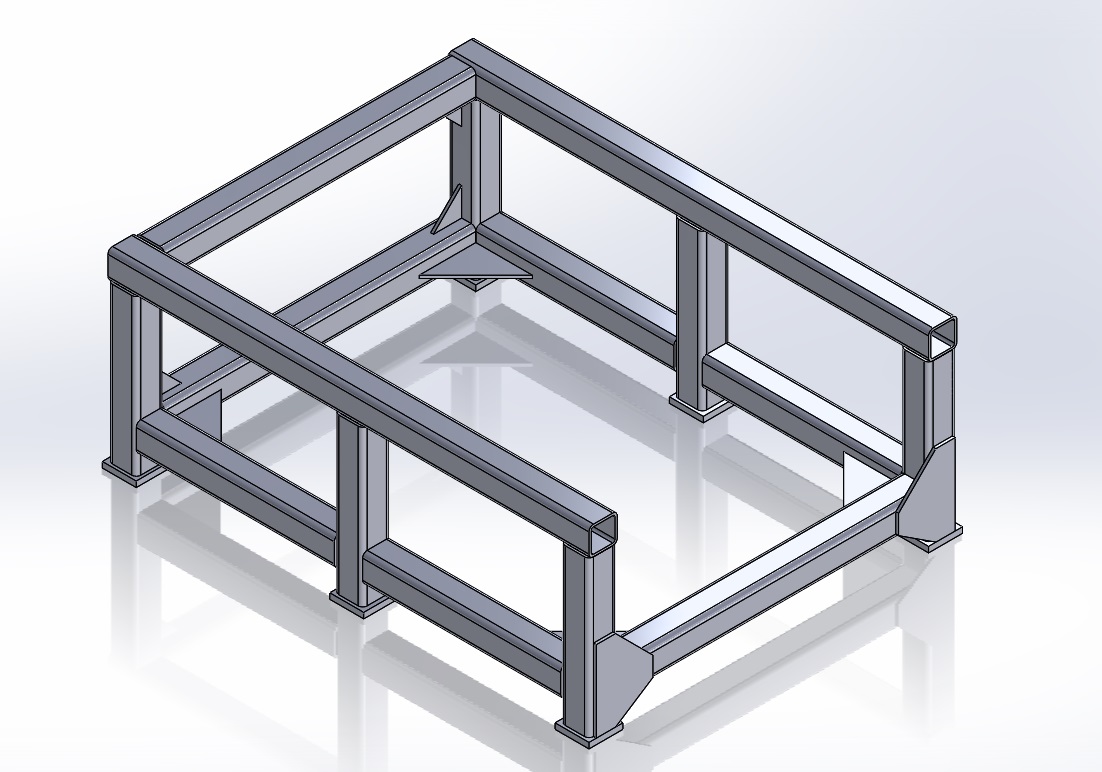

    Hi guys, ive done some work redoing the design as per the suggestions. The lower frame will be made from 50mm square steal box with 3mm wall. The total z axis travel is 120mm. Ive not drawn the bed yet but it will sit in the space at the bottom of the frame but also be adjustable upwards .
    Ive still got some things to draw like the z axis screw and stepper ect and x axis stepper mounts.

  2. You need some diagonal bracing on the base. How are you going to ensure the rails are on the same plane? There doesn't seem to be any adjustability in there.
    He can shim the Profile between the box section. This will work well and be easy enough to get on same plane with careful setup.
    Trev. Design looks ok but I'd build the frame differant regards how section is arranged.? Make the the legs extend down to the floor this will make the welding easier and give more support to the uprights. See pic knocked up to show what mean.

    Thanks for the replies. My dads got the lower frame priced up built from a company who does work at his company. They gave the choice of carbon steal or aluminium in 50x50x3mm. I will see if i can have the design tweeked. I know they will do a first rate job as they do all sorts of precision work.

    I think you will find mild steel is sufficient for the frame and will be much cheaper than aluminium, also the extra weight will be a benefit when the machine is working.
    Agree with Eddy and aluminium tends to crack around welds from vibration over time so wouldn't use it for the frame. I weld aluminium often and wouldn't build the frame from it unless weight was critical and even then I'd use much thicker aluminium than I would steel.
