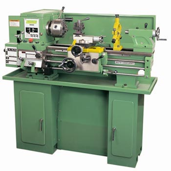

    I have a Warco BH600g lathe which sits on a couple of cabinets.

    I would like to put it on some adjustable machine feet so I can level it (My garage floor is not particularly level). Like these:-
    http://www.axminster.co.uk/axminster...machinery-feet
    My question is how many feet should I use? My first thought was just 4 But I am now thinking it may be better with more (4 on the larger cabinet and 2 on the smaller one?)
    I like the idea that it would be more stable using more feet but I guess the flip side would be more of a faff to level?
    Thanks,
    Jim
    EDIT:-
    Just read that leveling should be done by shimming where the lathe attaches to the cabinets to take any twist out of the bed..? In this case I guess the more feet the better?

    I've used those feet on my bandsaw and milling machine and they work well for levelling. Lathes can be a bit fussier, though. How stiff is the cabinet - would it be happier supported at 6 points rather than 4? Will the cabinet itself distort? How many mounting points did the manufacturer provide? I would be inclined to go for 4 as that makes the levelling and calibration easier. Not that I can talk - my lathe sits on thin MDF and ply packing...
    Well the cabinets are 4mm welded steel, so I think they pretty solid. There are 4 holes in the base of each cabinet and I was thinking about just tapping these but looking at there location they seem a little to close to the centerline (along the length of the lathe) for me to feel comfortable. I was thinking I would drill and tap some new holes further out.
    Worth saying the lathe is currently not on the cabinets (still sat on the floor after picking it up!!) so drilling and tapping the holes is less of of a problem.
    I also just read that I should be levelling the lathe by shimming where the lathe attaches to the cabinets and not try and level it by adjusting the cabinets alone??
    So I guess I would level the cabinets first, stick the lathe on and then shim it to take out any twist in the bed?

    On my machines I used feet with stems that fitted through the clearance holes (mind you, that was 12mm on the milling machine anyway) and used nuts and washers each side to adjust and lock. That way, you don't need to turn the "bolt" in its foot - from memory, the feet I had didn't have a hex or square section to put a spanner on.
    As for shimming - depends on the design. My Myford sits on a welded steel cabinet base, rather lighter than yours. With that, because the cabinet is relatively flexible, you make sure you have taken any wobble out of the base, then the lathe has adjustments where it bolts to the cabinet. My "new" lathe is a heavy ex-toolroom machine that weighs around 2800lb on its cast iron base. In this case, the base is part of the stiffness of the lathe itself and the bed is bolted tight to the base. It's difficult to believe that there is any scope for twist in that lot, but the recommendation for setting up both lathes is the same. Stick a longish bit of steel in the chuck, and turn both ends (near to and furthest from the chuck). Ideally, you use a test bar which has a reduced diameter in the middle so you only turn short sections at both ends. Both ends are turned without moving the cross-slide. If both end up the same diameter, you're spot on. Otherwise, put a tiny amount of twist in by tweaking the feet/adjustment bolts and keep trying. Sounds like your machine is another variation - as you say, level the stand, then shim the lathe mounting. Sounds like the most fiddly option, though, but at least you only ever do it once! I guess you have a way to lift the lathe on to its stand that you could use while shimming?
    Ah ok, thats a good idea - Saves having to tap the holes!
    Just spotted the same operation in the video's Lee linked to. Perfect. As for lifting it to shim, I have a 2 ton engine crane so it should do the job. :)
