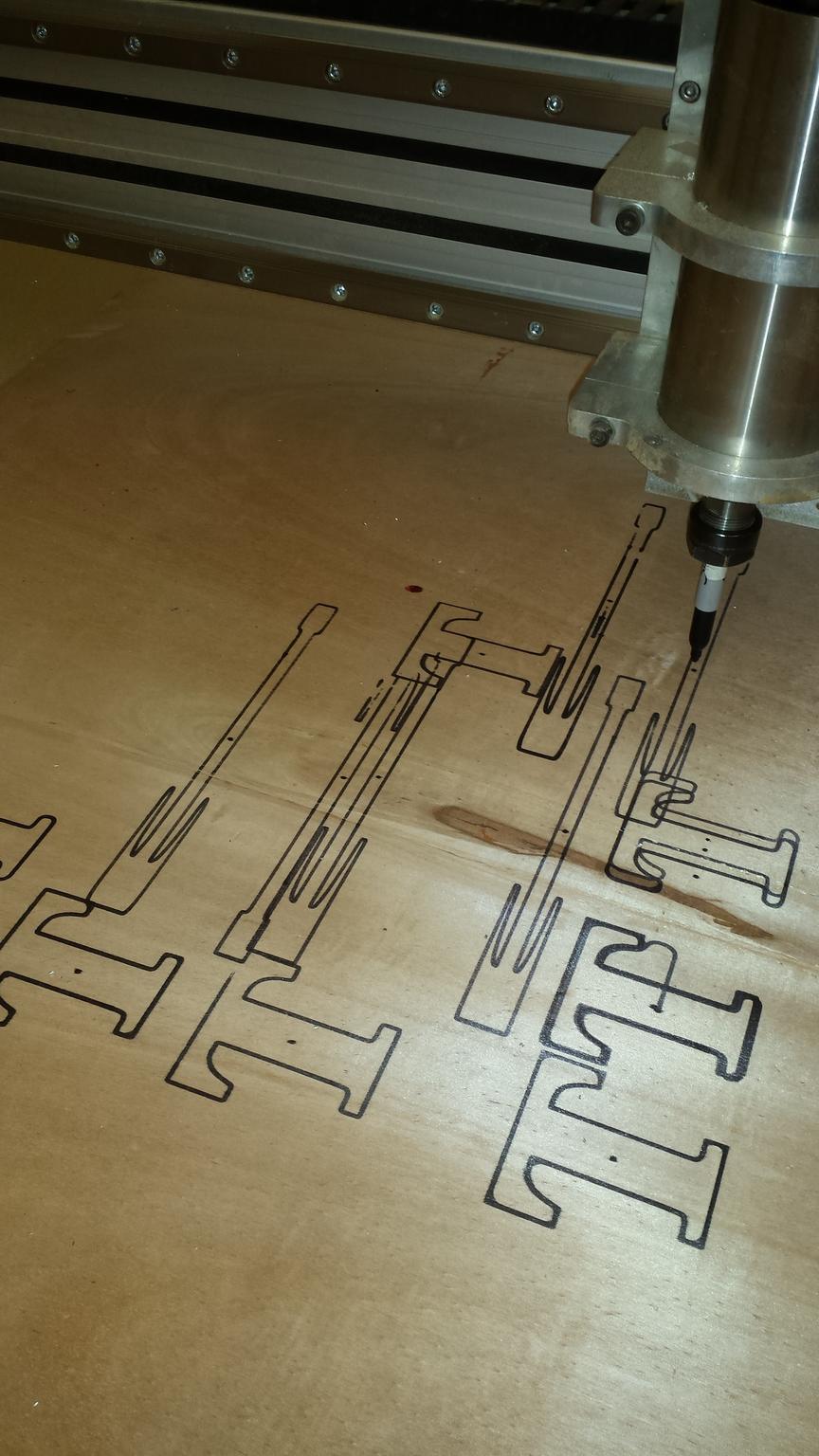

  1. #21
    As Gerry mentioned i reversed ports and pins, however the workpiece is now inverted and im getting narrow letter (test) also when doing to i get rounded corners, not sharp ones

  2. #22
    ok so ive managed to get the T the right way up to where i want it.
    will i have to do the steps per again due to swapping the axis, and also with the T being very narrow
  3. #23
    Looks like your motor tuning calibration needs swapping over too. I'm guessing you've got different pitch screws on your x and y?
    That should sort out the narrow letter problem.
    Edit : Check your cursor keys for jogging from the keyboard too (hotkeys). You'll probably need to change those too.
    Si.

  6. #25
    Awesome, im running rack and pinion on both axis. however one is on a gearbox and other two on cncrouterparts drive pulleys
  7. #26
    You shouldn't need to change your jogging hotkeys, unless you've already changed them to a non standard configuration.
    You will need to change your steps/unit, and accel and velocity settings if they are different for X and Y.

  8. #27
    Thanks guys i now have it the way i wanted it :)

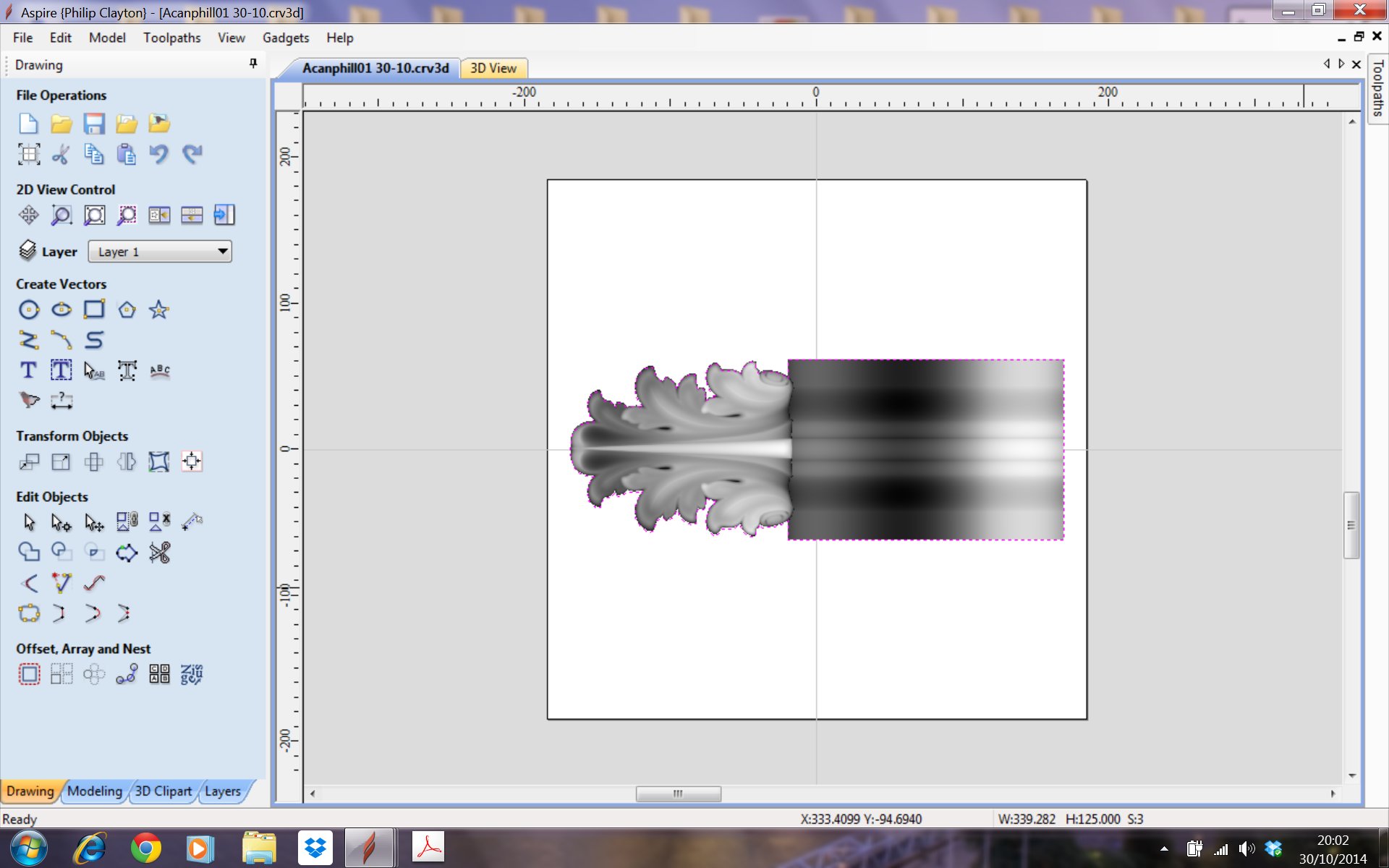

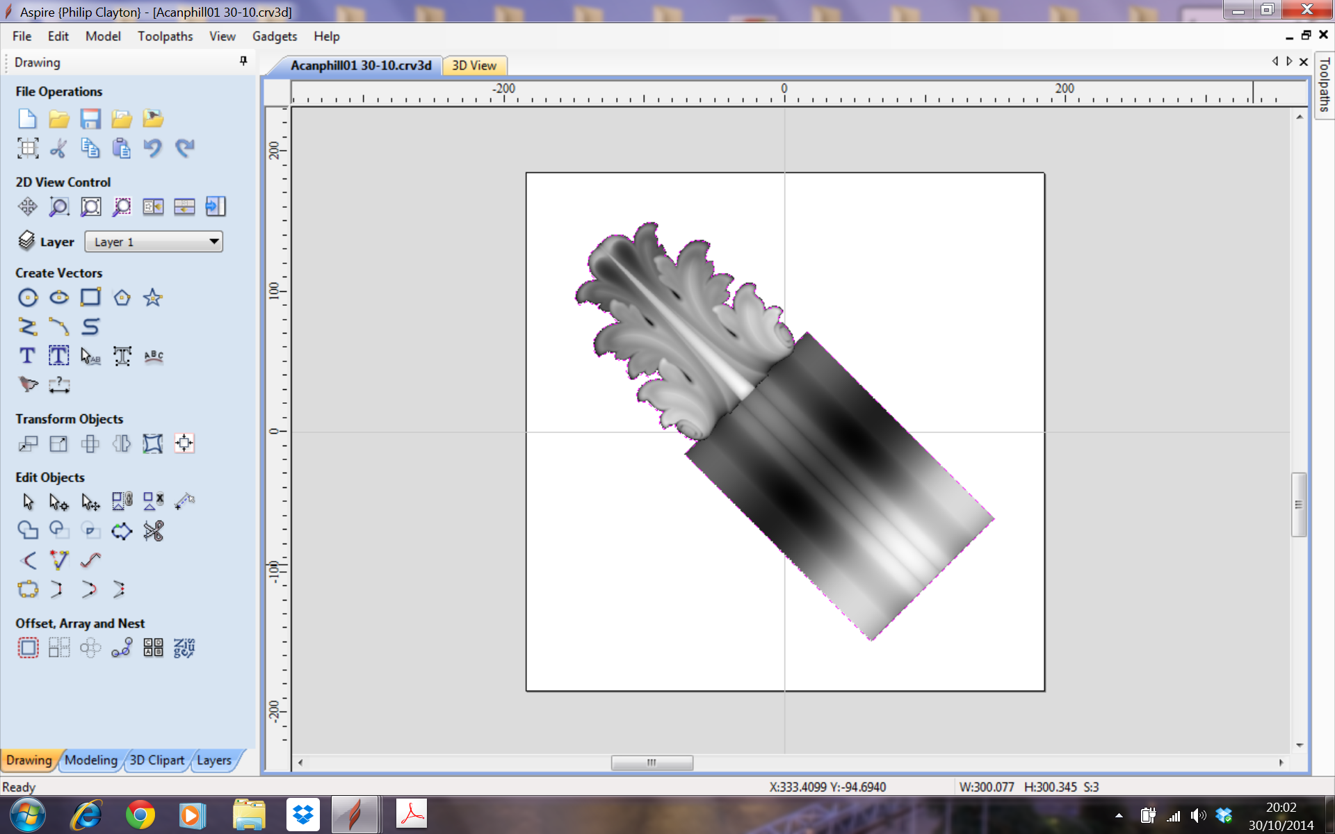

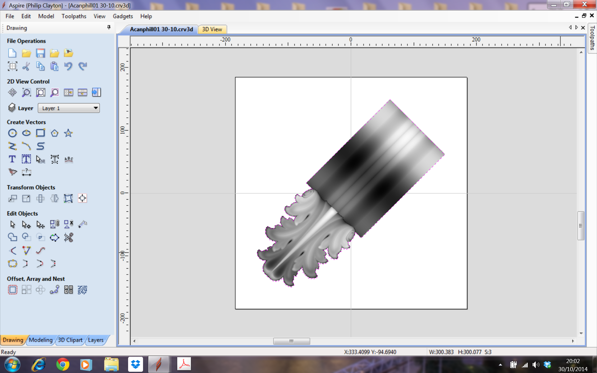

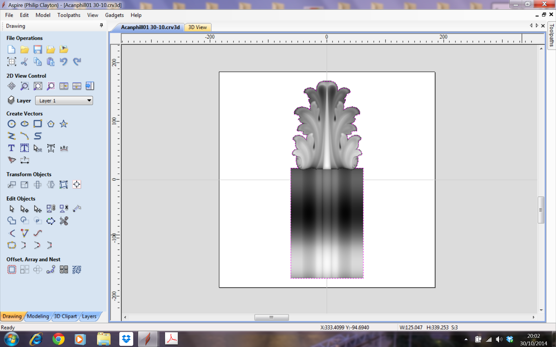

    I just tried Ctrl +9 45 left, Ctrl +0 45 right in VCarve, it rotates the vectors but not the material (workpiece stock)
    Eddy,
    Why would you want to rotate the material? I am working every day like this, I set the Job "stock" dimensions greater than the model sizes and square, set the origin to centre, create the part I can then rotate to any angle with ctrl 9 and ctrl 0 then F9 to centre create the toolpaths and cut no problems whatsoever.
    If I want a pair then copy and paste move 1 each side of centre.
    If I was on txt same as above you can rotate, move, scale reverse, and only toolpath and cut what you want.
    look at the time taken to rotate and screenshot only seconds.

  10. #29
    Quote Originally Posted by phill05 View Post
    Eddy,
    I don't, I only have a demo of V Carve Pro, I was just pointing out that using the shortcut keys described by Earle, only the vectors rotate. You said the "the Vectors are the workpiece" which to my mind was not 100% correct because surely the material is part of the workpiece. Beyond that I care not a jot, I use F-engrave because it's free and does the job.
  11. #30
    The vectors are the workpiece that is the part you will cut and use, think of the "material" as your piece of paper you are drawing on, you only need to set the thickness of the material for the size of the part required.
