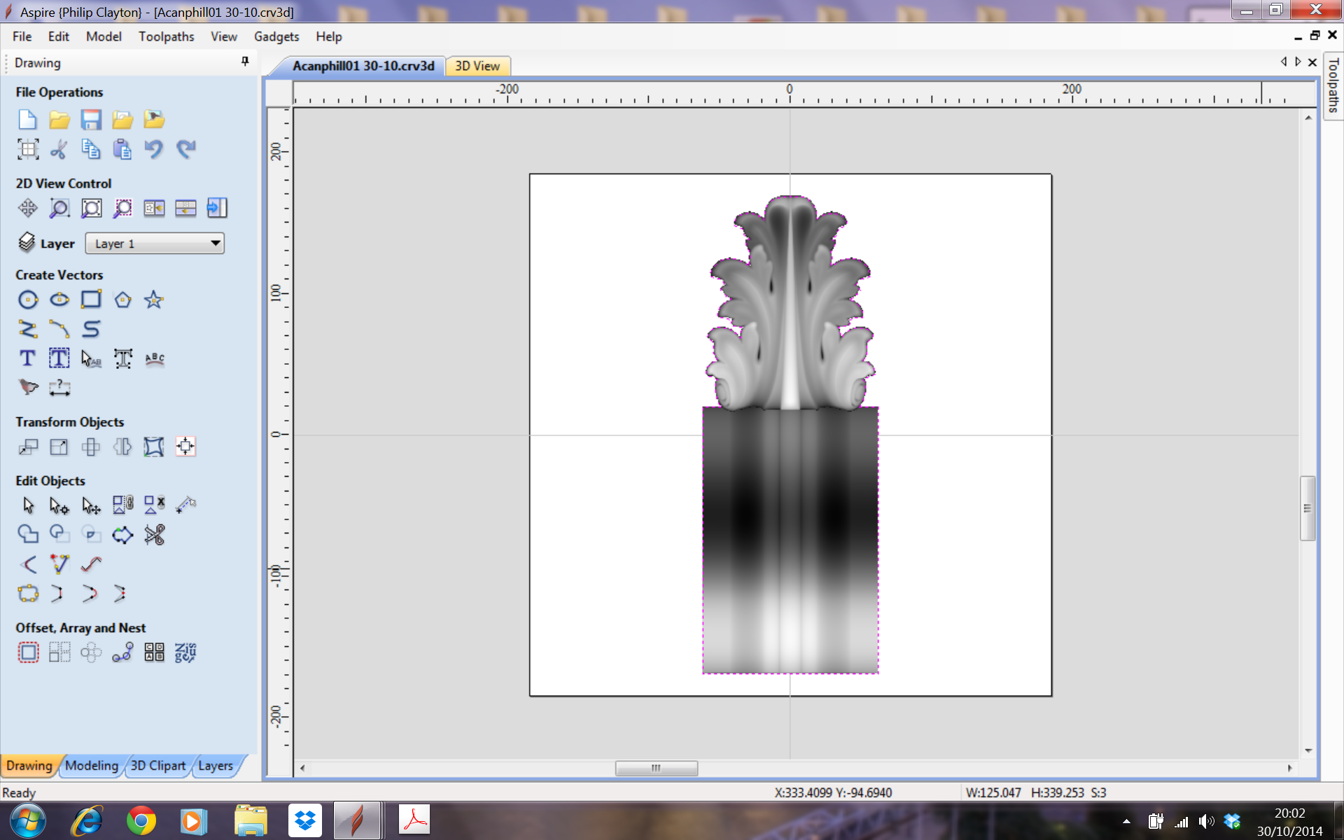

    I just tried Ctrl +9 45 left, Ctrl +0 45 right in VCarve, it rotates the vectors but not the material (workpiece stock)
    Eddy,
    Why would you want to rotate the material? I am working every day like this, I set the Job "stock" dimensions greater than the model sizes and square, set the origin to centre, create the part I can then rotate to any angle with ctrl 9 and ctrl 0 then F9 to centre create the toolpaths and cut no problems whatsoever.
    If I want a pair then copy and paste move 1 each side of centre.
    If I was on txt same as above you can rotate, move, scale reverse, and only toolpath and cut what you want.
    look at the time taken to rotate and screenshot only seconds.

  10. #29
    Quote Originally Posted by phill05 View Post
    Eddy,
    I don't, I only have a demo of V Carve Pro, I was just pointing out that using the shortcut keys described by Earle, only the vectors rotate. You said the "the Vectors are the workpiece" which to my mind was not 100% correct because surely the material is part of the workpiece. Beyond that I care not a jot, I use F-engrave because it's free and does the job.
  11. #30
    The vectors are the workpiece that is the part you will cut and use, think of the "material" as your piece of paper you are drawing on, you only need to set the thickness of the material for the size of the part required.
