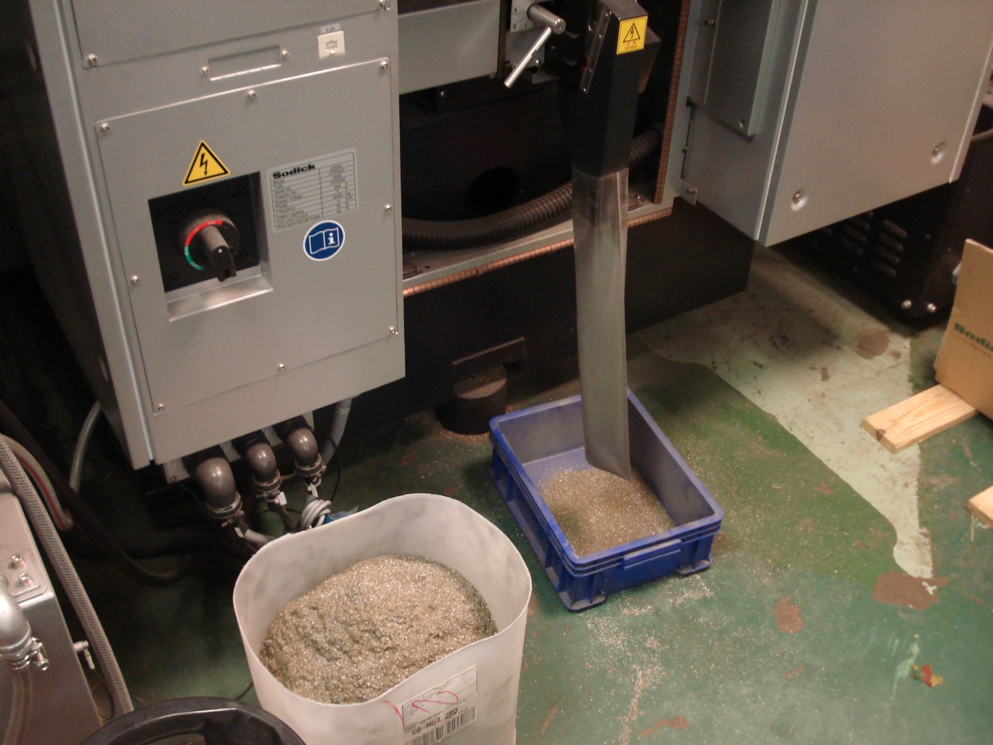

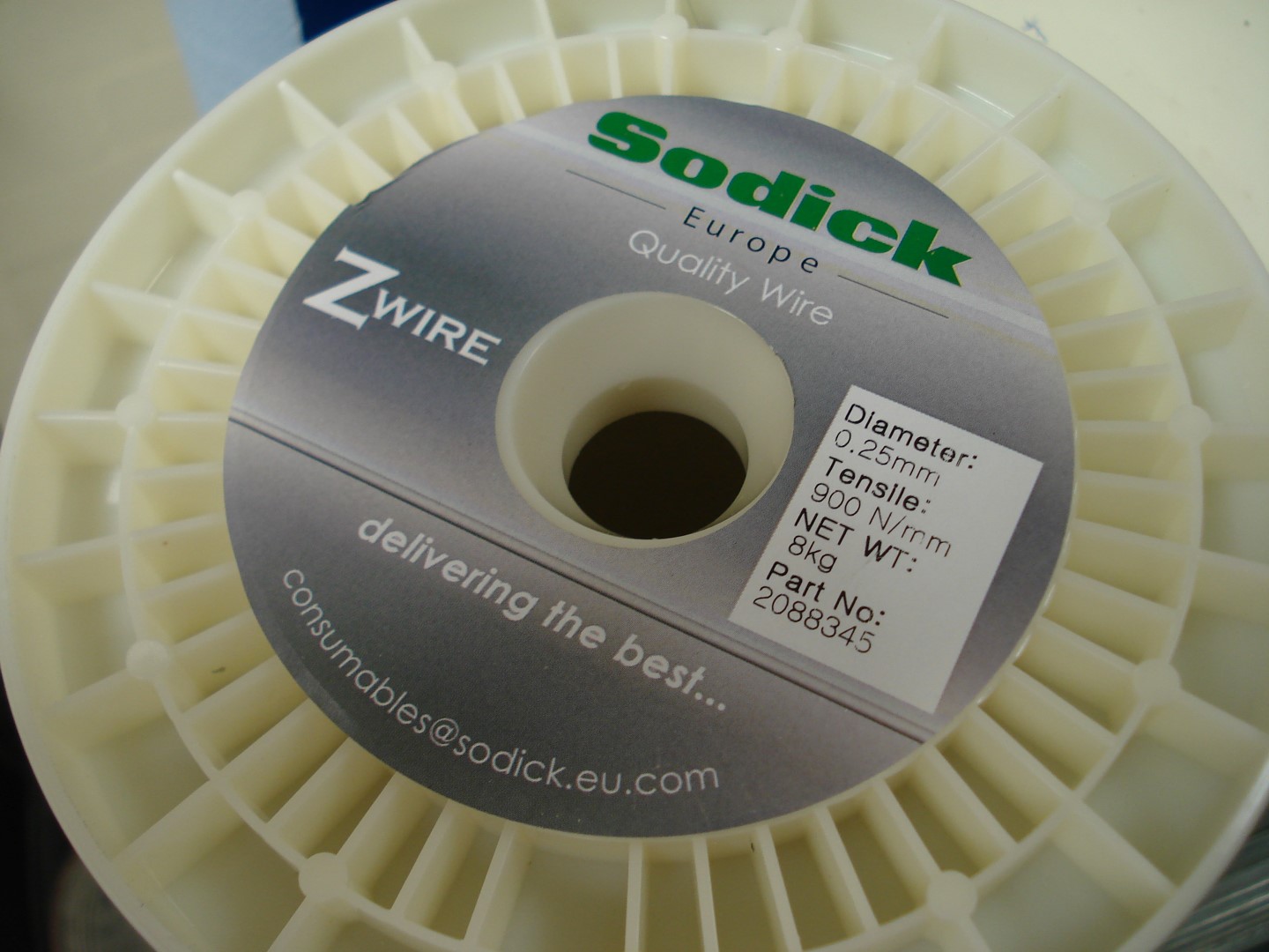

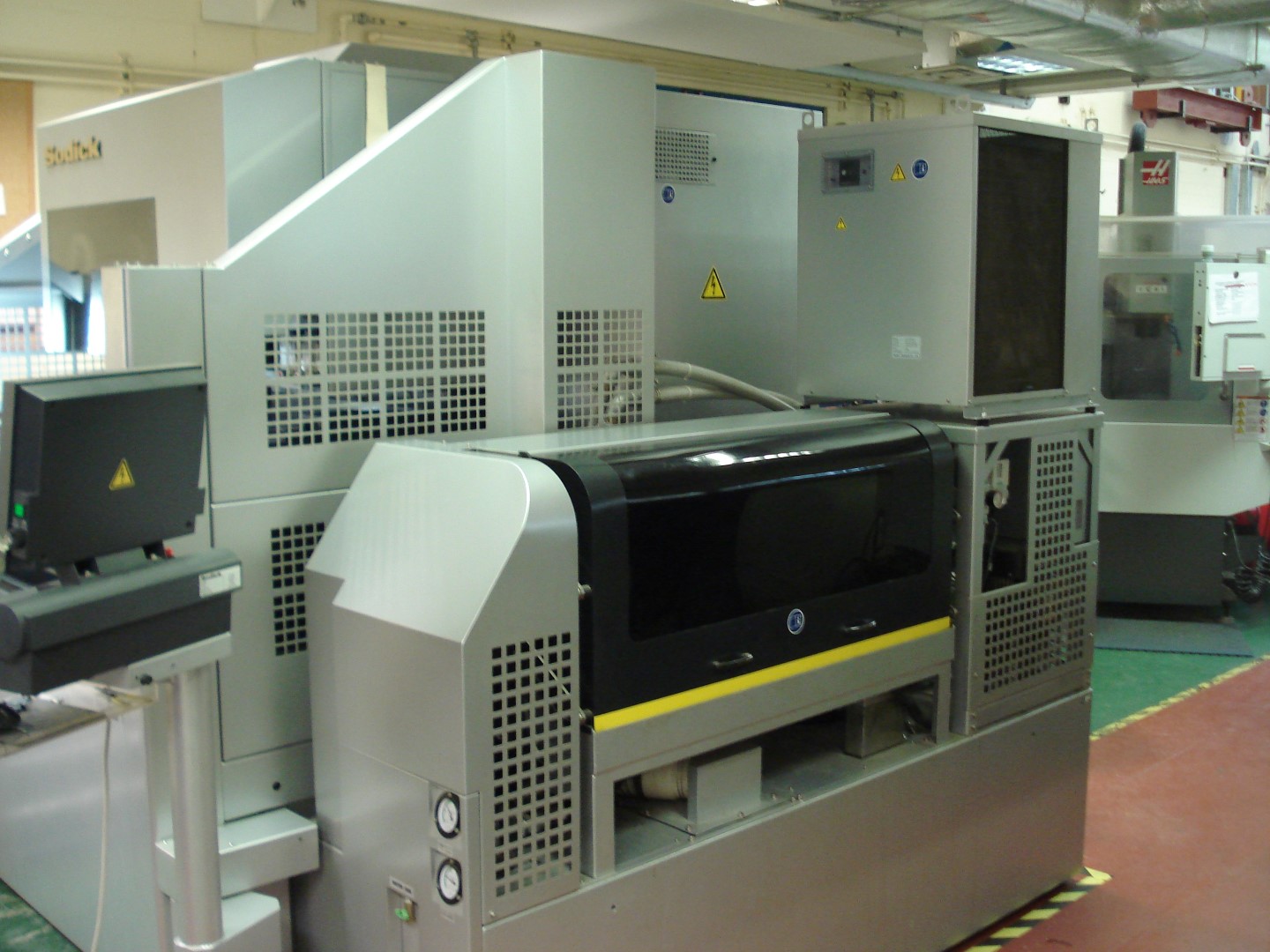

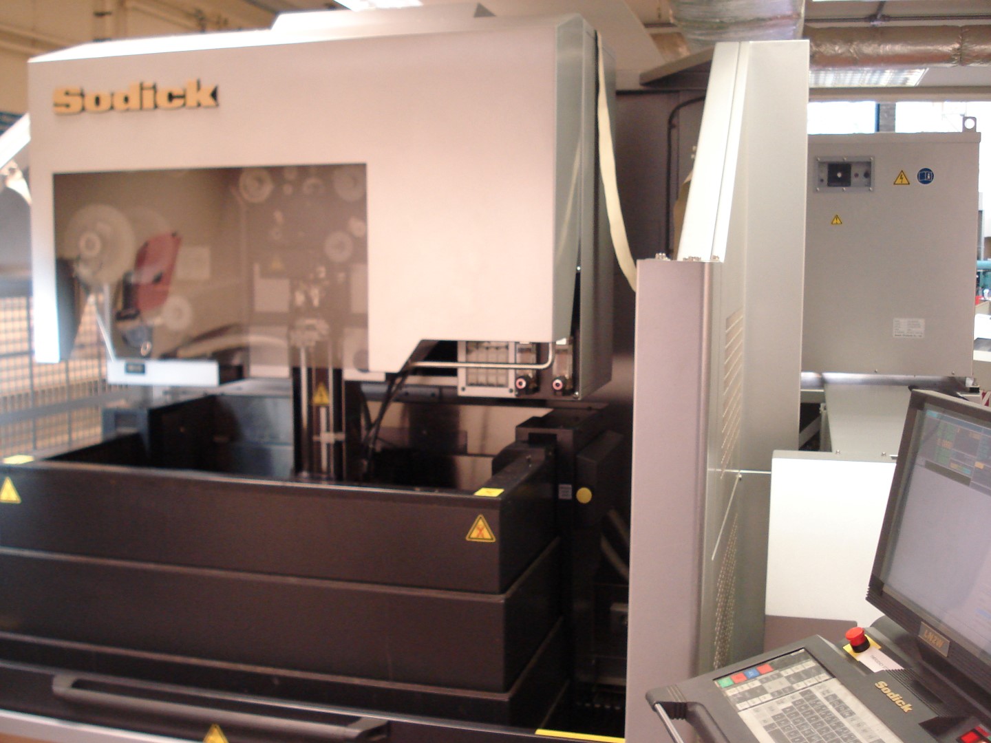

    There's one in the workshop for electrical engineering at uni (and more in mech. eng). They mainly use it for cutting electrical steel laminations for research into electrical machines. I took a few photos a while ago, to get some ideas:
    It does use up the wire quickly and as expected the feedrate is very low - a few mm/min and much less round sharp corners seems typical. Linear motors too...

    They really don't want you to reuse that wire, do they?
